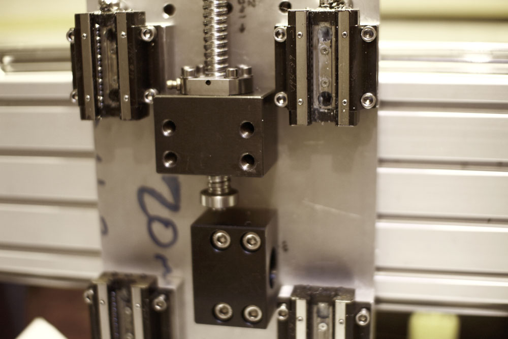

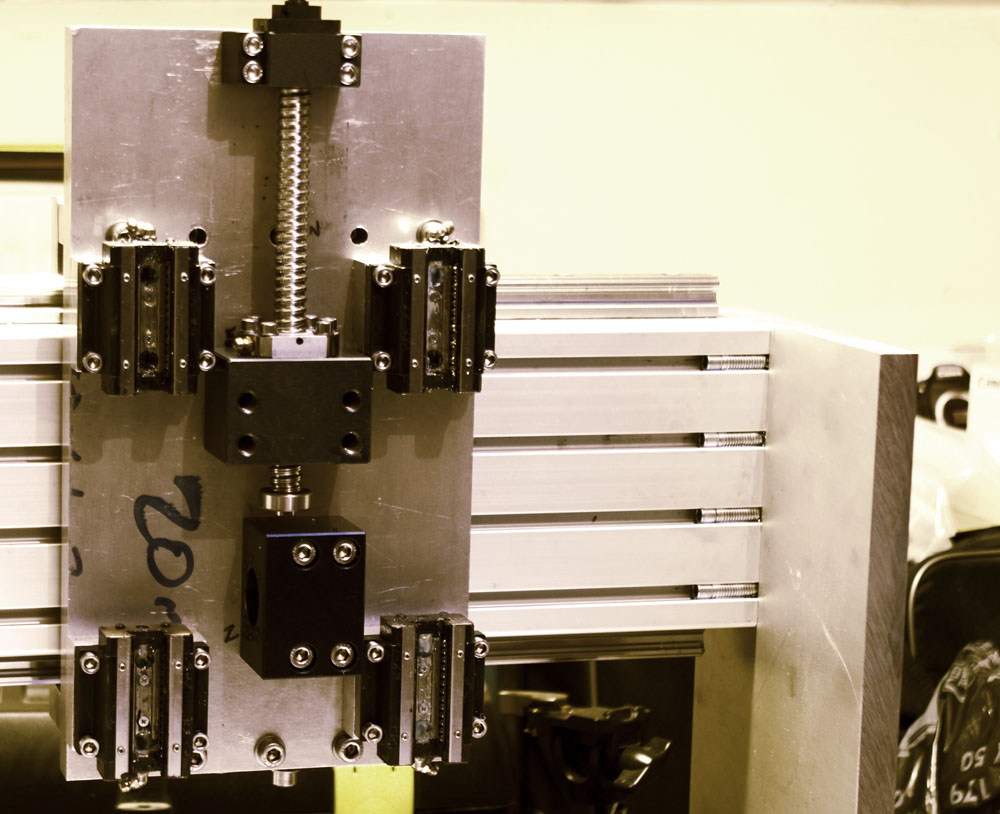

3 Attachment(s)
Re: Fingers crossed it'll cut ally
there are two things im dreading on this build....
hole sawing 25mm for the Y screw and drilling and tapping the bed plate
up to now iv used my diy spindle to do all my drilling and i was gagging to to be able to say id done the whole build with it and a tiny cowells 90 lathe:dance: however.... i think i may need to stop f***ing around and borrow a heafty drill
there is probably loads more stuff i should be flapping about but at this point i cant see past the drilling and tapping..... more drilling and tapping.... and!!!..... b***cks!!
Attachment 3369Attachment 3371Attachment 3370
for now i decided not to support the floating bearing on the Z screw, the housing that came with it seem such a waste of valuable space... ill make a low profile one if i have trouble with it whipping around

its amazing how much more the gantry sides flex in the Y axis compared with the X axis
ill stick some sort of buttress on them if its a problem

Plate is the worst possible cross section for bending in the Y direction. Maybe you could securely bolt some bigish aluminium angle to the plate to make it a bit stronger...ideally get it welded on.

i was thinking a 20mm arch bolted at 90 down the gantry sides, i need to work out where the torsion might be acting... im pretty sure it wont be a staight line top to bottom
