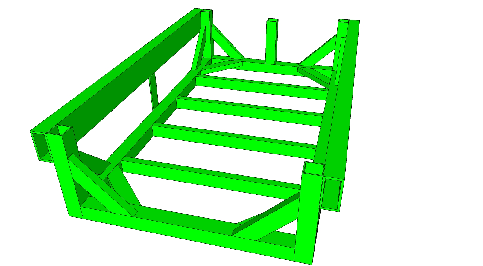

3 Attachment(s)
Re: Comments sought on new build: A CNC Router for RC Gliders and Planes
Just swapped the supported round rail for linear rails and also turned the Z axis 180° so the chips will not collect on the ballscrew or mount. I've also dropped the Z axis stepper behind the upright and it will be connected by belt (1605 with 1:1 connection to the stepper) It will have a cover over/round it and I'll look at making a cover for the rest of the Z axis. I've now gained 50mm of Z travel so total travel now 200mm. For the Z axis rail mounts I've had to raise them on some 20mm plate strips to get the 1605 ballscrew in there. Will have to make a low profile mount but that's the least of my worries!
Changing the X axis to single stepper and belt drive, yet to work out the finer details of supporting/tensioning pulleys.
Anything that you peeps can see that could do with altering? I've tried to keep most of the plates with straight edges so I can cut them myself. the only ones I've left with curves and machining are the Y axis end plates. I could always make these with straight edges and no machining!
The actual router frame is removable from the upright frame so that If so wished it can be put on a flat surface if ever required. Also for working on (pouring epoxy resin for levelling the rails for example) it will be easier than trying to tip the whole frame.
Attachment 10095
Attachment 10096
Attachment 10097

i really like it neil.
stupid question, and one im sure you have already though about it, but incase you havent, the total height (when on vertical stand) is going to fit in your new shed right? cant remember your total dimensions...

Yes shed is 2.4m at the apex and just over 2m at the sides. This is 1.8m total height....also got double doors so can get it in and out again...

also... dont get stung like i did initially on the accessable area... remember you have lots of wasted accessable area at the top of your machine... where you could perhaps extend the bed or add a vice etc... and there is a void of unaccesssable space at the bottom...Attachment 10098
I was thinking about that earlier. I was going to shorten the bottom and put a vice on but then decided to reverse the Y axis to stop chips from collecting on the ballscrew and bearings. Don't fancy having a vice at the top but might shorten the bed and make provision for a 4th axis.
The cutting area I was aiming for was 1000mm x 500mm and this just about gives me this so was going to leave as is but you've tempted me to have another look :whistle:

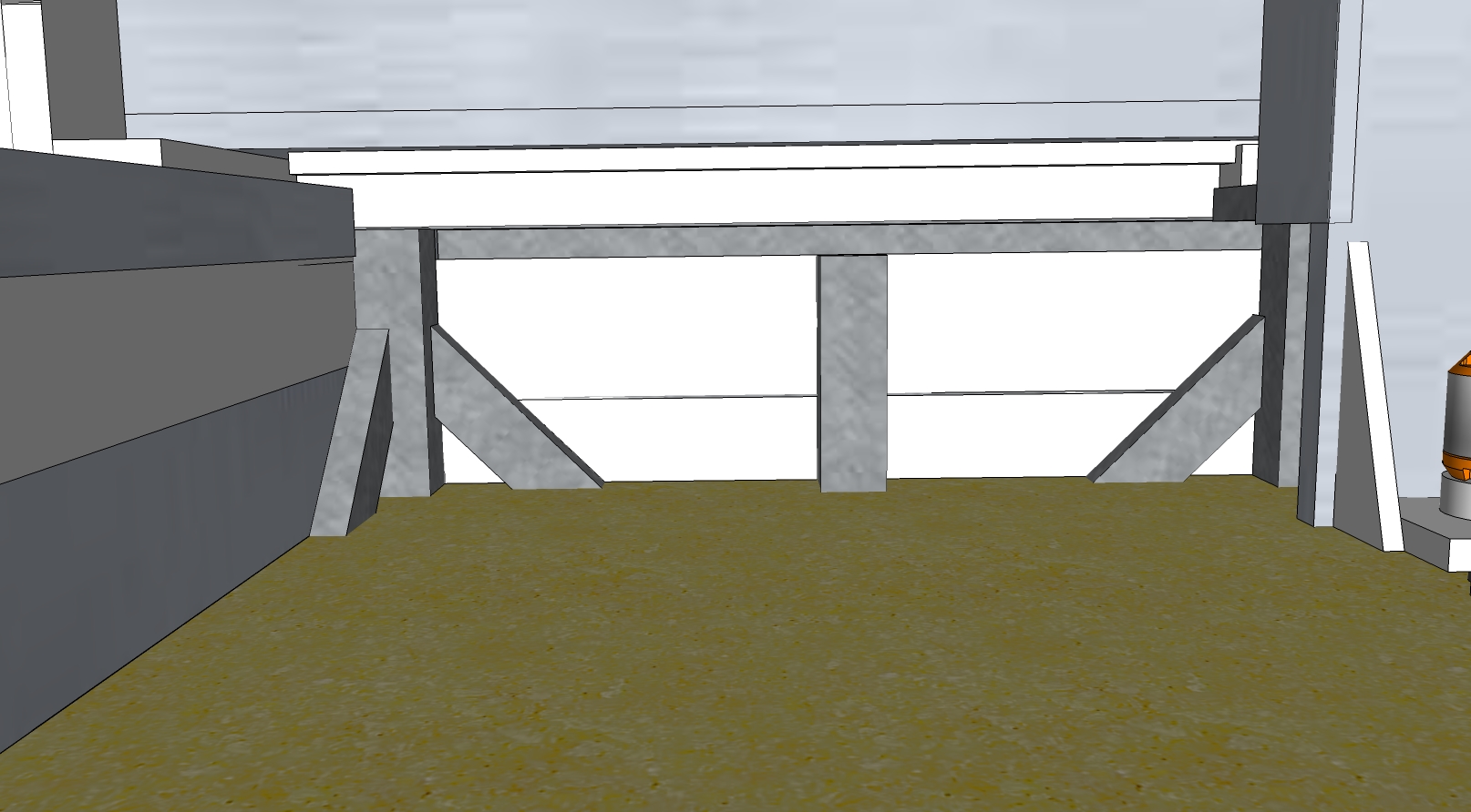

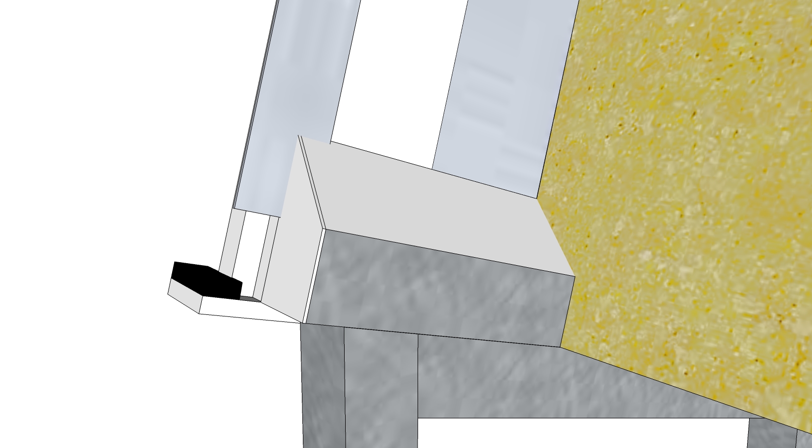

2 Attachment(s)
Ok here's things I see with this and learnt from mine being vertical.
The Machine frame, (not holding frame) needs much more bracing esp at the open ends. The 2 short uprights will flex if not braced well, triangulate much has possible.
Chips which fly up will collect in several places on way down so think about covers or deflector guards. Collection areas are:
#1 Against the rails on Y axis so on the top side just in front of rail with enough clearance for bearing to slide by put a short angled deflector/catch plate which they hit first and slide off.
#2 The Ball-nut mounts so again some form of angled deflector plate wrapping over the mount with hole for screw to pass thru, won't hurt to build in a wiper seal has well. Chips don't collect so much on screw but they do around the ballnut where screw enters on top side so this is the target area to keep chip free.
#3 The bottom bearing mounts.! Same deal just some form of deflector guard so chips hit that first and bounce off.
#4 THE BIG ONE . . .Complete Z axis cover needed FROM THE START. While turning 180deg you have lessened the chip collection points BUT they will get in there and the ONLY way is full cover. They are easy made with thin Ali plate and weigh nothing not the prettiest things but very affective. Something Like this
Attachment 10100Attachment 10101
Also while turning 180deg helps keep chips off rear of front plate it will also make it very awkward for when your changing tools.? The way you have it When doing jobs with several tools you'll have to lower gantry to reach spindle properly and that will mean leaning over gantry so will be very awkward.
Much better to raise gantry and access spindle from below, I have my screen setup with tool change position where gantry goes to top and Z axis parks in centre of gantry. This brings me to #5
#5 Not chip related but relates to parking the machine when not used. You want to build in some bump stops at the bottom and when not using park it there to release any tension on motors/screws/belts etc.
On my machine I just have some thick rubber dougnuts with slit in which slip over screws and sandwich between bottom bearing mount and ballnut which i slowly drive upto, simple but affective.! . . But if was building from scratch like you then I'd build in some permanent bump stops, either fixed or flip up jobs.?
#6 Not a biggie but still worth doing else it will annoy I'm sure.?. . . Put the side covers on the inside of frame not outside has again chips will collect and build up, have the inside walls smooth and uninterrupted and chips will slide nice into box below.
That's it for now if spot owt else i'll shout. .Lol
Edit: All the above with exception of beefing up frame work are Minor things and even if left uncovered won't affect machine working properly just annoying and over time will cause premature wear which is easily avoided with simple deflectors or covers.
Don't necessarily need to cover every thing just deflect chips away.!!

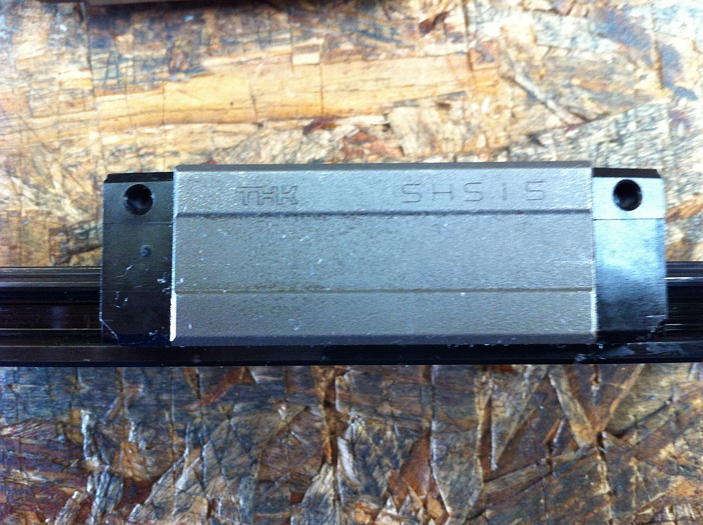

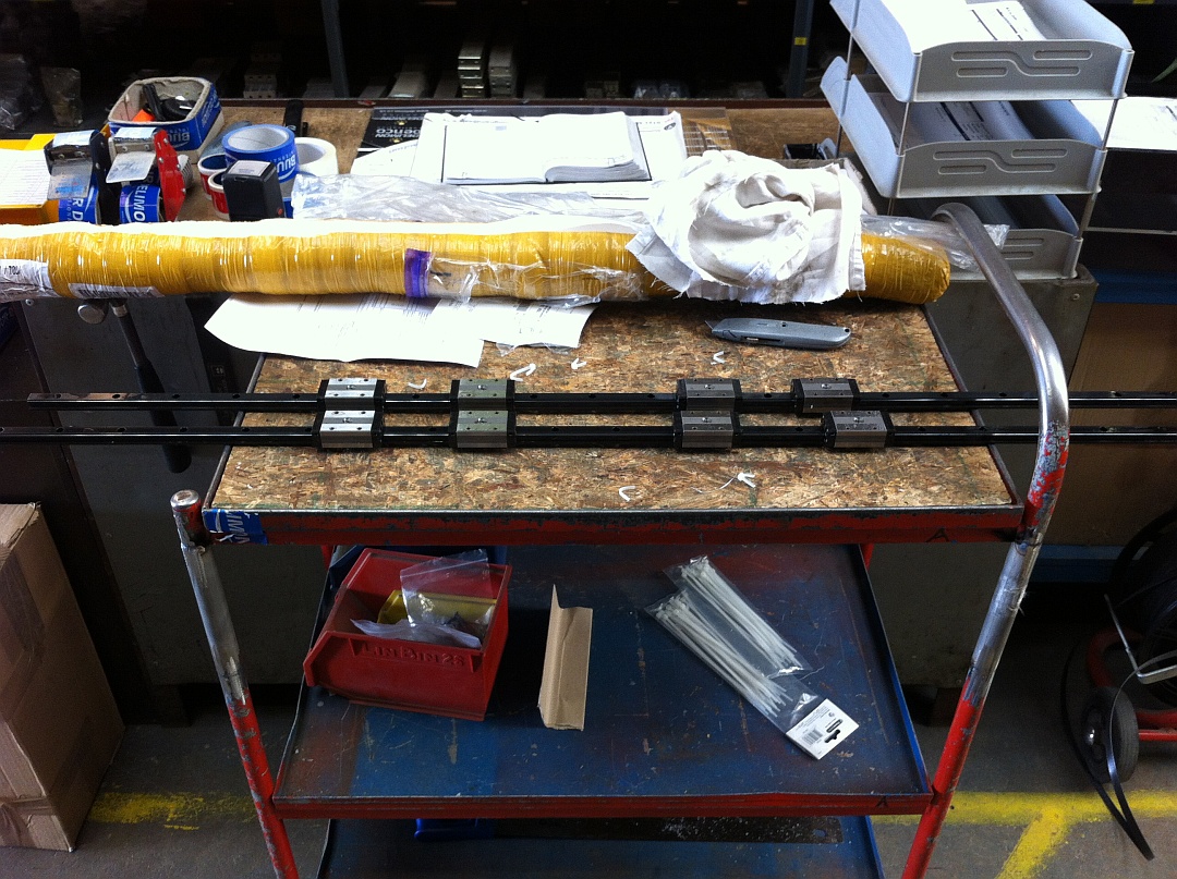

Ordered one lot of linear rails 1190mm long with 8 blocks on Thursday night, they arrived from Korea today at 8.45am......that's fast...straight through and no stopping at customs (if you know what I mean :yahoo: ) These I'll cut into two lengths, one 750mm long for the Y axis and one 420mm long for the Z axis. Ordered the ballscrews from Chai today so waiting on one more lot of linear rails (1390mm long for X axis) and the ballscrews and then I can start the build in earnest!
Attachment 10140
Attachment 10141
Attachment 10142
Attachment 10143

The shed's looking good as are the rails. I got stung for fifty quid and a two and half week delay with the rails I imported, I obviously don't have any luck at the moment.
I was lucky, not complaining as I've always had the fee (which I don't mind as it's the law) on imported stuff so a bit of a change. You got your steppers and drivers yet? Which ones you going for? I was thinking of the Leadshine AM882 from Zapp and the Nema 23 3.1Nm stepper motors from cnc4you...plus looking at making my own (gulp...) PSU.

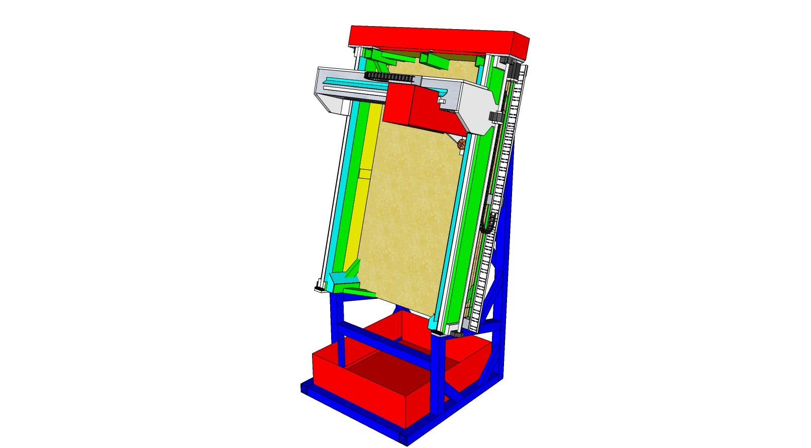

3 Attachment(s)
Attachment 10146Attachment 10147Attachment 10150OK Dean, switched the gantry around again to how it was before. Have put a folded aluminium enclosure over the Z axis, on the bottom of the Z there will be a rubber cover (5mm thick rubber with cut outs for the rails) to stop chips going up into the bearings. Have put deflectors on the X axis to stop chips hitting the linear rail, also put a deflector down the bottom so chips slide into the bin. Have altered the ballscrew mounting so it's on 20mm block and not the aluminium box section as I'm not using that anymore. I will also put a cover over the X axis belt and steppers.
Couple of questions now...
- I'm going to use 1 stepper and belt (T5, 15mm wide) and pulleys to drive the X axis, what number teeth pulleys would you recommend? I take it that it's worth getting spare pulleys and belts so that the option of 1:1 and 1:2 (stepper to ballscrew) is available?
- For the belt idlers/tensioners I was going to use skate bearings (as I've got sh*t loads of them) and penny washers, I couldn't see any specific idlers for the belts?

Depends on how your having belt system.? My machine is setup with 2 pulleys bolted together on one screw with a single pulley on other. A short belt goes from motor to first pulley then connecting belt goes between screws. The ratio is 1:2 motor with 40T and first pulley 20T Connecting pulleys are 36T. I then have 2 spare pulleys for 1:1 or 1:3 ratio 20T & 60T.
Connecting pulleys could easily be 20T for simplicity sake but I just happened to have spare 36T so used them.
Don't go smaller than 20T other wise you don't get good tooth engagement and the belts wear quicker or worse they can jump. I'd also use HTD belts/pulleys not T5 has thou they are very similar the HTD just seem better fitting belt.
Yep skate bearings and large Penny washers work fine for idlers.!!

3 Attachment(s)
Just been looking at PV solar panels, leisure batteries and charge controllers for the shed so I can have some 12V LED lighting in there as well as being able to charge my RC LIPOs etc...interesting little project :biggrin:
Broken the different frames out and coloured them so they stand out a bit more, also did it with them all together.
Attachment 10172Attachment 10173Attachment 10171
I've got a friend who's PV mad, he's just bought a load of panels so I can ask him what he's got if you'd like?
