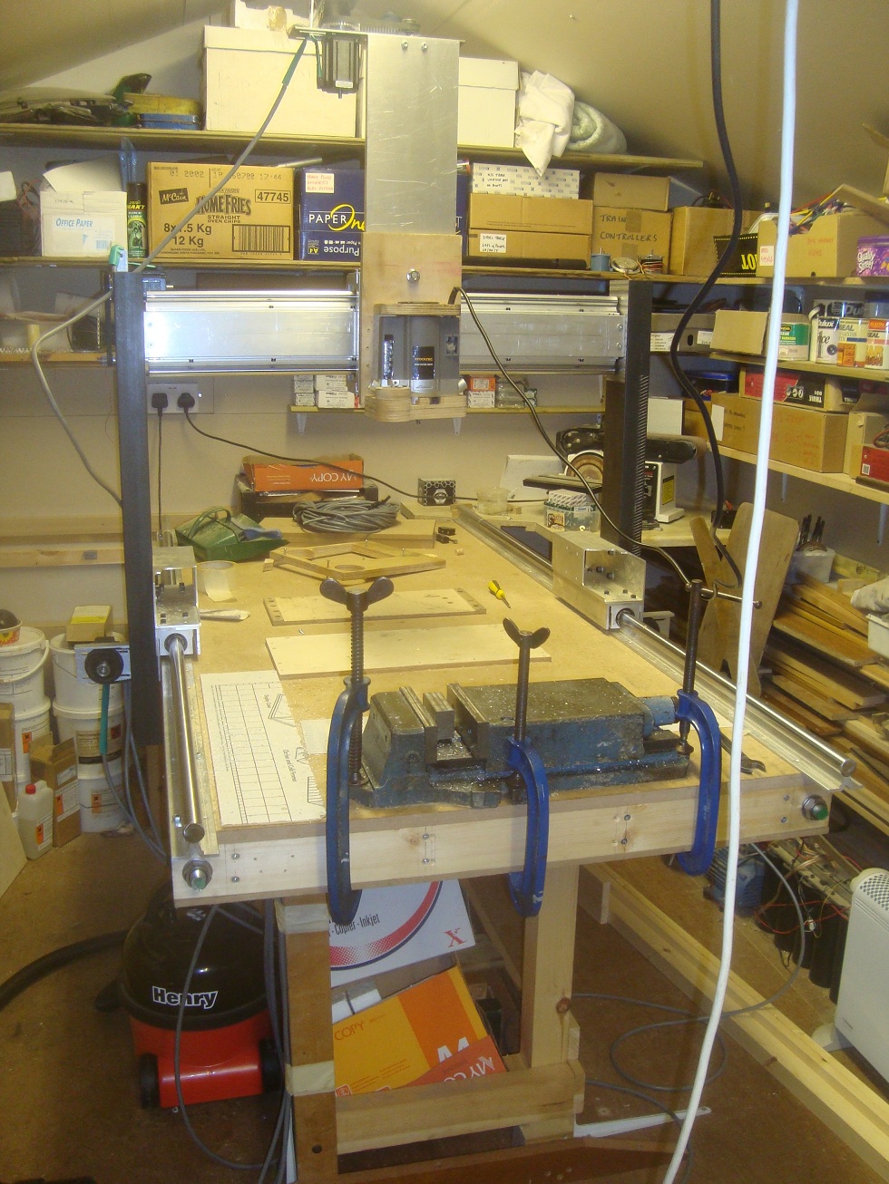

I relieved most of the tension on the X screws and now it's much better. Seems happy at 3600mm/min over the whole bed. I'm using a 42T pulley on motor, and the 28T pulley I posted about earlier on the 2.5mm pitch screw.

Bit of a faliure! I think I'll try that again but with it mounted higher on the bed. I could see/hear the Z wobbling.

I think I will look into making it easy to lower the gantry.

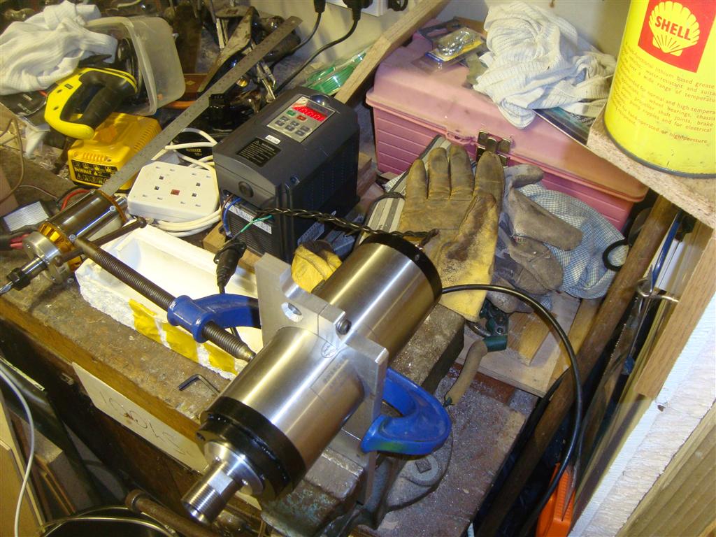

I've come home for the weekend - lots of post, including spindle.

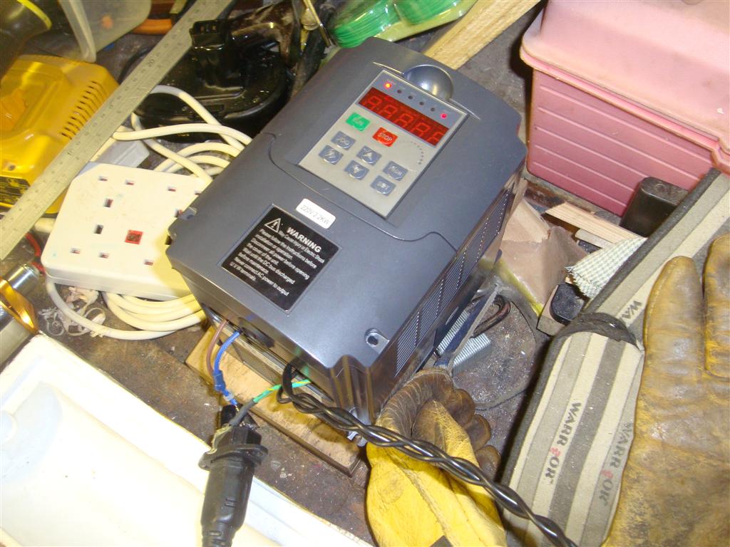

Setting up the VFD was no problem. I've got a little 8L/m submersible pump for the water cooling. I've just tried it with a bucket of water and an odd assortment of tubing, about a couple of meters in total, and I got 1.3L/m flowing. I think that's fine.
With 5l of water in a plastic bucket the temperature rose by about 0.25°C/min. The spindle was only drawing 0.6A from the mains.
Going to make the mount later today and hopefully try cutting with it tomorrow :smile:
At 24,000 rpm is quiet enough to listen to radio and I can't hear it over the dust extractor...Also I can barely feel any vibration at that speed on the spindle body.

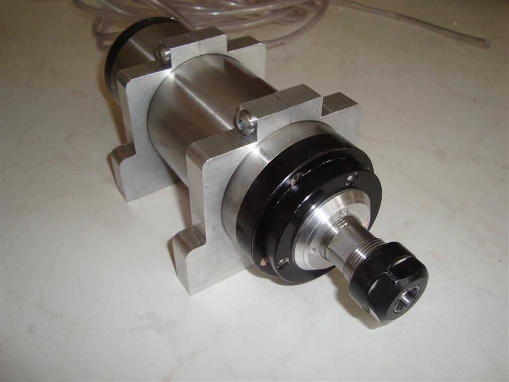

I got one mount done and started the top one. I've not got a photo of the finished mount, but you can get the general idea from here:
Attachment 3807
Attachment 3808
Attachment 3809
The extra aluminum on the side will let me fit dust extraction.

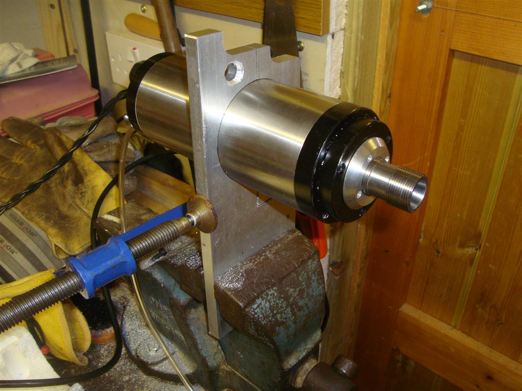

Spindle is mounted and working!
Runout isn't great - 0.05mm ish.
But it seems good in all other ways. I just cut some carbon fiber with it, about 2mm thick at 450mm/min with a cheap diamond burr at 24,000rpm. It's cut well and left a decent finish.
I'll post some photos soon.
Spindle mounted + VFD:
Attachment 3818
Water cooling... crude but it works. My mum is wondering where her bucket has gone!
Attachment 3816

I intended mounting the VFD there to be temporary, but now I'm thinking I might leave it since it saves on cable. The extra mass on the Z axis isn't much compared to what's already there. If I switch the steppers off the Z axis now drops due to gravity. Before the detent torque of the motor was sufficient to stop this.

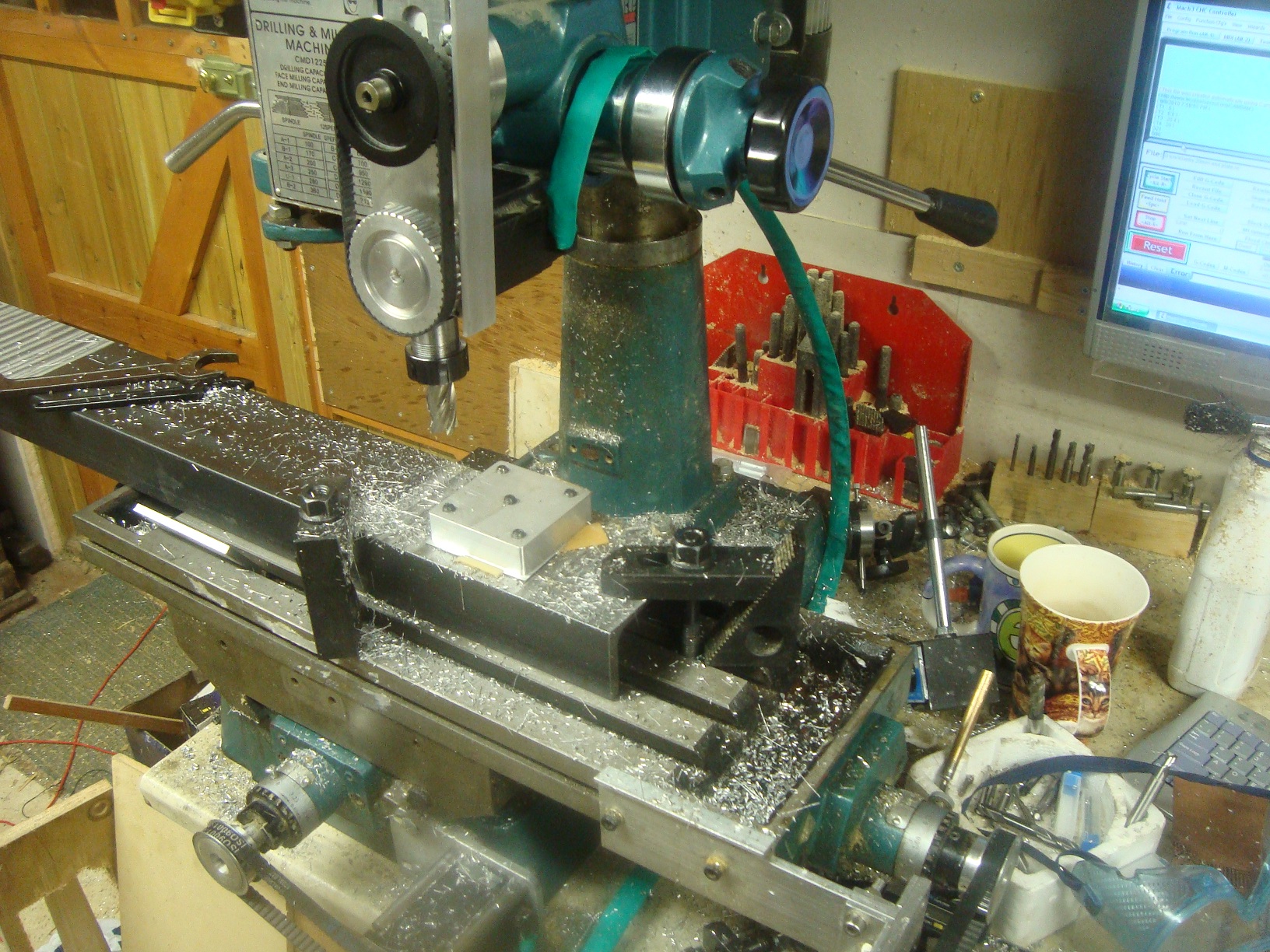

Slow progress with the frame, I've been getting distracted making other bits - such as spindle mounts:
Attachment 4173
I've drilled most of the holes required in the frame, just got a few more to work out. I think it's best to drill them all using the milling machine ... except I can't really do that with the holes for the linear rails as I'm not confident I will be able to weld the frame parallel enough. I'm using the bed support rails to clamp the three upright pieces of the frame in place to weld, not sure about the rest...maybe some sash cramps:
