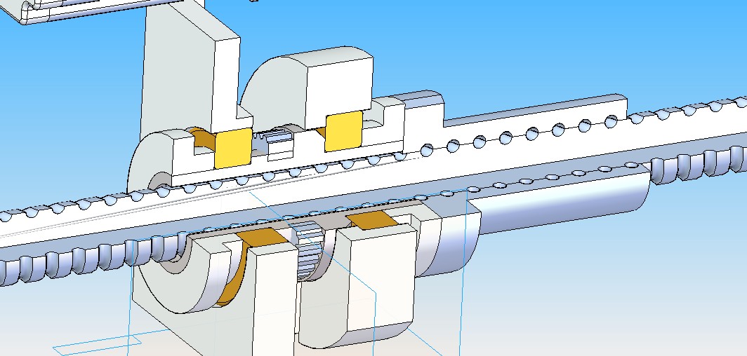

Hi Jonathan,
While you are contemplating if you would ever find the time to make me two of these beauties, i am trying to make a detailed drawing in Sketchup which i could share here with your permission.
Would you throw some light on few details please:
-distance from motor shaft center to pulley center? nema 23 yes?
-exact belt length for 30:30 ?
-did you make the 2 holding nuts or buy them?
-thickness of inner and outer race ring of the bearing? It is the 7207 2rs bearing from here yes?
Nema 23, 5M HTD belt 340mm long which enables the motor pulley to be anything from 15T to 30T without changing the belt length. Center distance 90-115mm approx.
I bought them - KM5 locknuts:
PACK OF 5 KM Series KM5 Locknut 25mm x 38 mm x 7mm FREE P&P | eBay
That's the correct bearing. You should be able to get the rest from the SKF website. Interestingly the seller specifies that the bearings are 15° or 25° contact angle, but the ones I got have the suffix 'B' which (going by SKF's nomenclature) means they're 40°. Excellent if true...

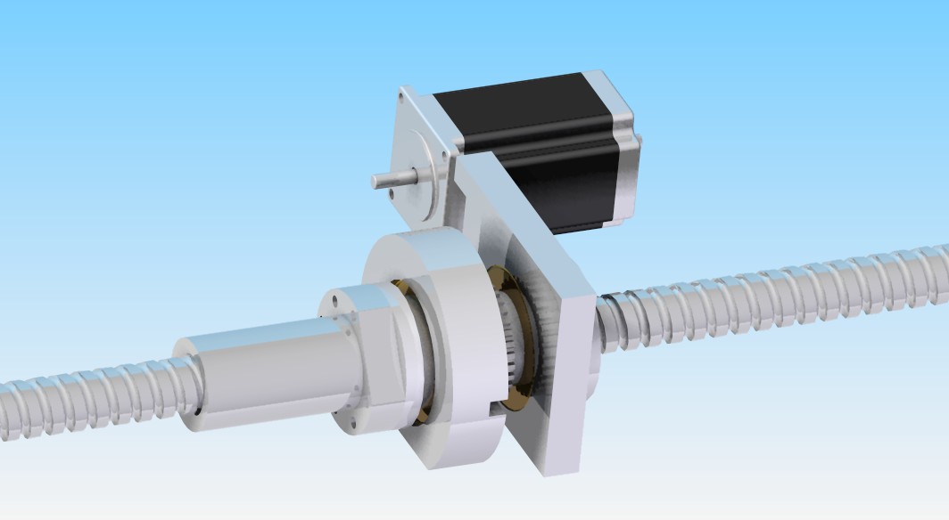

As this rotating ball nut idea consumed my weekend and the whole last week, and i am sure much much more of Jonathan's time, here is the Sketchup file for all to use, if this is alright with Jonathan:
Notes:
1. Every part is labeled , so can easily be found in internet
2. The bearings are recessed 0.5mm in the casing
3. The aluminum is 20mm thick and the bar can be 100x100, 100x90 or as originally 5"
4. Everything is tight fit / I still don't get it how the bearing casings are centered from both sides but hey, i am not a machinist yet :-)/
6. The clearing between the 2510/25.. nut and casing is 1mm
7. The clearing between rotating shaft and the ball screw is 1mm
8. The 2 retaining nuts actually are PACK OF 5 KM Series KM7 Locknut 35mm x 52 mm x 8mm FREE P&P | eBay as the thread will be 35mm
9. There could be small corrections of the lips that hold the outer and inner bearing racing rings, will update if necessary.
10. The motor is from Zapautomation 3Nm SY60STH86-3008B NEMA 23 STEPPER MOTOR, which i assume most will use for this job 8mm shaft

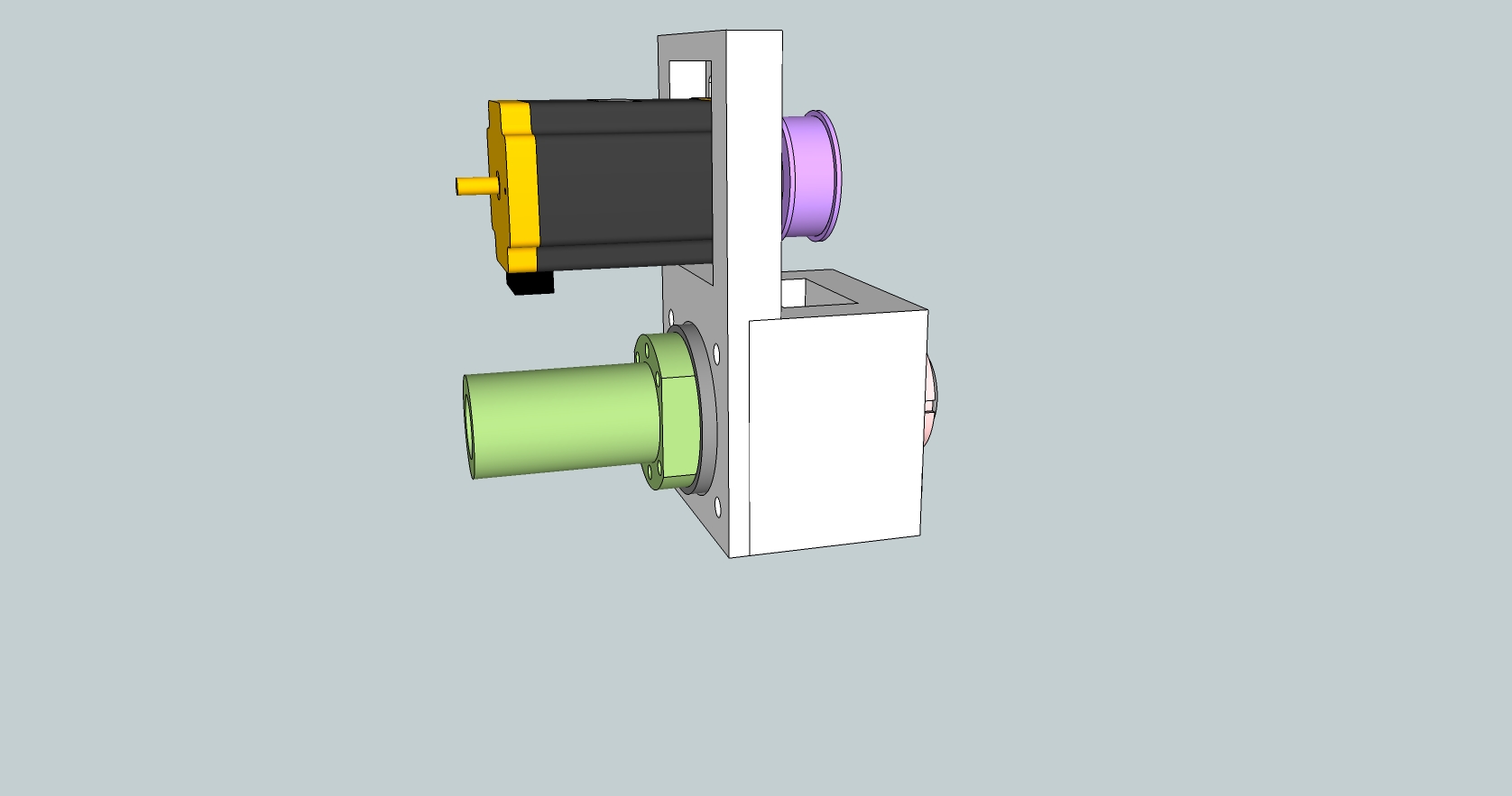

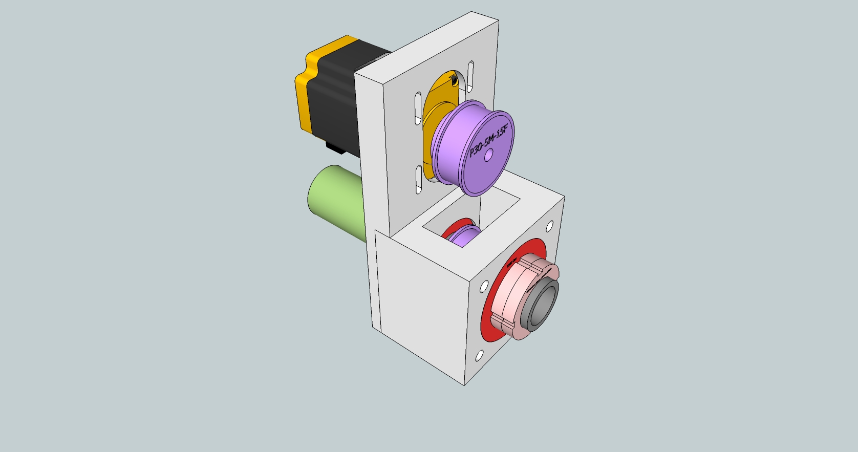

There are 2 minor changes from the original design:
- i made the motor mount from the wider side, as many will like maybe 34 nema and it looks more sturdy. I wanted to make a combined nema 23 and 34 mount, but i feel sleepy now. when ready will see if it will stay like this or follow your original design.
-i believe i shortened the rotating shaft by making its wide part go through the motor mount plate. It is now 2mm to place the ball screw nut in its place,10mm for the ball screw nut holding thread, 2mm ring to push only the small bearing ring and 90mm the rest.
I think that all can be further shortened and lightened :
-2mm protruding thread instead of 5mm , when the nuts are tightened
-6mm /shortening the whole assembly/ eating from the clearance near the shaft pulley
-The area where the ball screw nut fastens could be recessed 8mm with diameter 40mm and some more holes could be done / 45 degree following the pattern/
This could lower considerably rotating mass
Attachment 11014
Actually if Jonathan or sb from the forum doesn't have the time to make the parts for me, i have to go to my local guy, who is way off with the 0.01mm, he works in the 0.5 zone definition :hysterical:
So i would update the drawings with extra drawing , made from OD100 and OD80 round bar. That way it would be more easy for him not to make a mistake an find the center. Further benefit will be that it could be mounted in cut in 2 pieces 85mm or 100mm spindle mount/not perfect but will work/ . anyway, i will mount it directly on its face, not using the bottom holes.

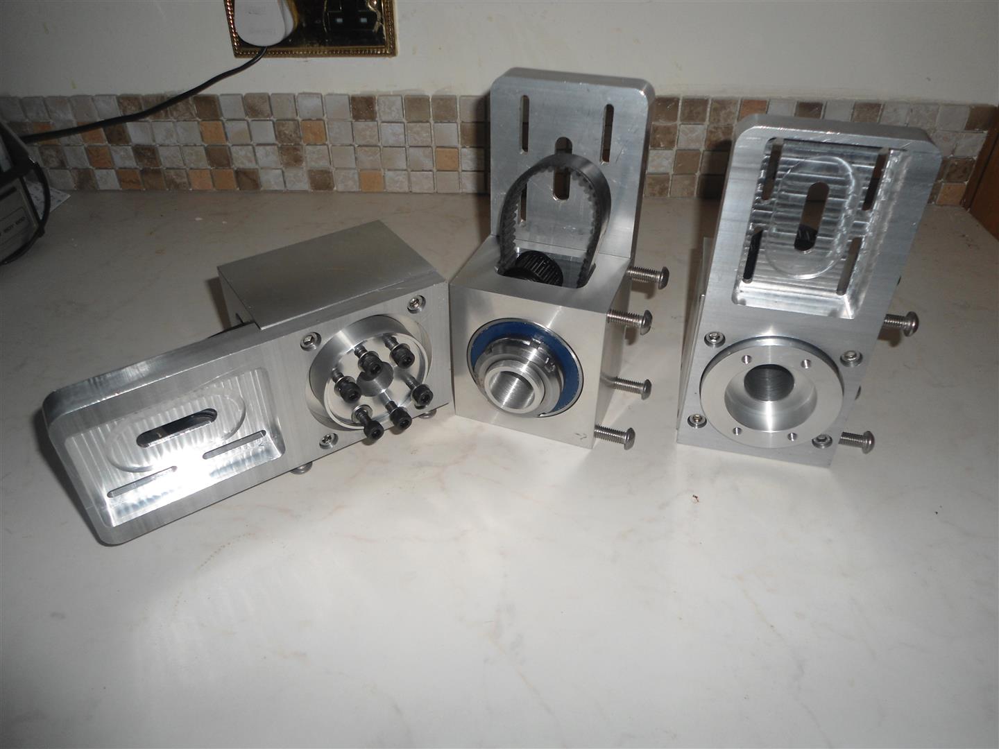

Here are my machined parts, still not assembled and tested:
http://i285.photobucket.com/albums/l...ps771483c3.jpg
http://i285.photobucket.com/albums/l...ps9e5c7455.jpg
Machining looks very nice. G.

Paulus - I like the way you've designed it such that the housing is one part, however I'm slightly concerned by the apparent small spacing of the angular contact bearings. According to NSK, you need to have the angular contact bearings spaced by 1.5 times their external diameter, but it looks like in your design they're almost touching, or a double row bearing which wont qualify? I expect you'll still get a reasonably high critical speed from this setup, but not as high as it could have been. The reason the bearings need to be so rigid is that the ballnut will inevitably not be perfectly concentric to the screw. Ideally the error will be small, but any error will cause energy to be transferred from the ballnut to the screw causing them both to oscillate. Both the nut and screw need to be rigidly held to suppress this.
Make your own.
I got mine machined the same as the standard end machining for the angular contact bearings at both ends, in case the rotating nut didn't work. All you really need is a cylindrical portion and a thread on both ends. On one end simply use the thread to clamp the screw, ideally into a hole the same diameter as the cylindrical portion so it's held rigidly. Something similar on the other end, except you can use the thread to tension the screw a bit if your frame is strong enough. Also, design the end mounts in two parts so you can adjust the ends of the screw to be concentric with the bearings.
If you look earlier in the thread you'll see the end mounts I made are very simple - essentially just a block with a clearance hole. They work, but having a hole the same diameter as the screw instead of using it for adjustment will be better.
Edit: Idea for silvaski - to make the housing easier to machine, instead of boring the bearings from both sides you could bore from one side almost all the way through, then machine a spacer tube the right thickness to go in between the outer rings of the bearings.
Thanks Jonathan for your comments,
I needed a simple design as I don't have access to precision machining. I wanted one part housing without the need of bearing pair alignment. So I chose a double row? -or how it's called- bearing. Will see how it will perform.

This weekend, I made some progress on the six mounts I'm making:
Attachment 19311Attachment 19312Attachment 19312
I'm away racing next weekend, but after that I should have time to finish these ... at last.
