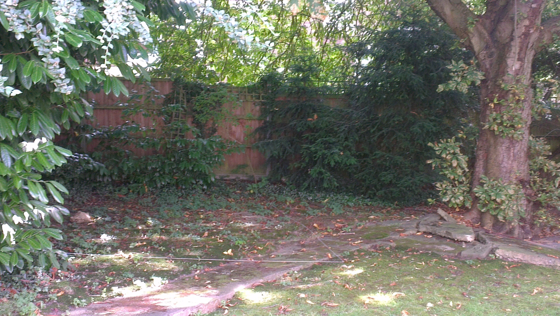

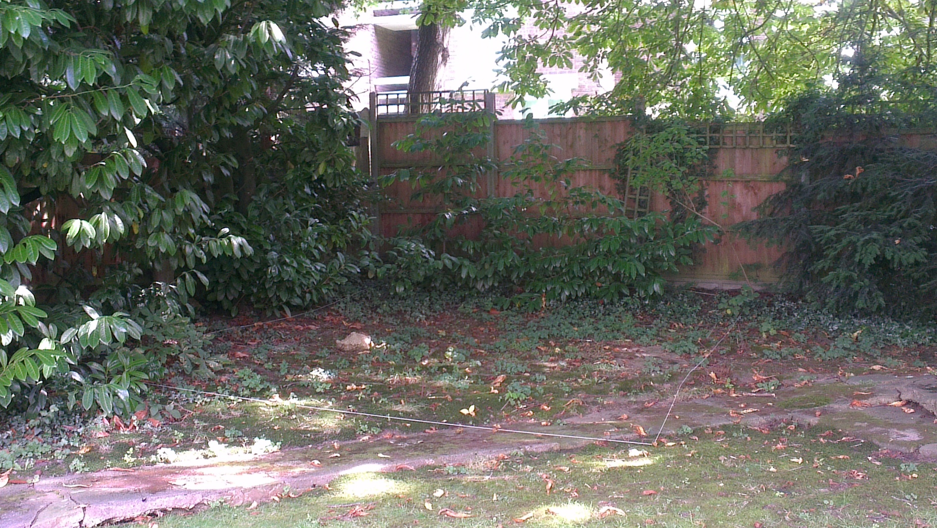

Well end of day 1 and not entirely to plan. Digger didnt turn up til gone 10 but I'd spent the first couple of hours chopping up a crazy paving path that cuts across the corner of the dig. With a cold chisel, a 5lb club hammer and the bosch power chisel... hard work... if I'd known how difficult I'd have hired a kangol but i would have only needed it for an hour or so... then the Muck Truck (powered wheelbarrow) got stuck in the garage back door.. the gap was 705mm the muck truck was supposedly 680mm... yes apart from the hubcaps which needed another 30mm, so had to take the door off...
Anyway, dug out about 1/4 of the area at the deepest end, down to 730mm or so... will finshing digging the rest before doing the final 100mm just in case my land surveying is a bit off...
will put up some pics later when I've eaten and dragged them off the camera... but here's the boys toys taken on my phone...
