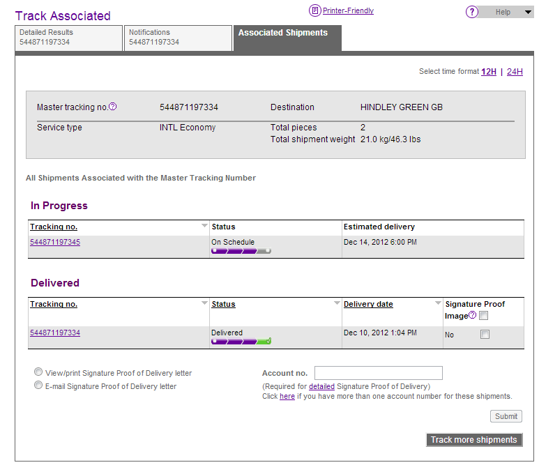

also just realised there is a tracking number on what they sent me
Attachment 7585

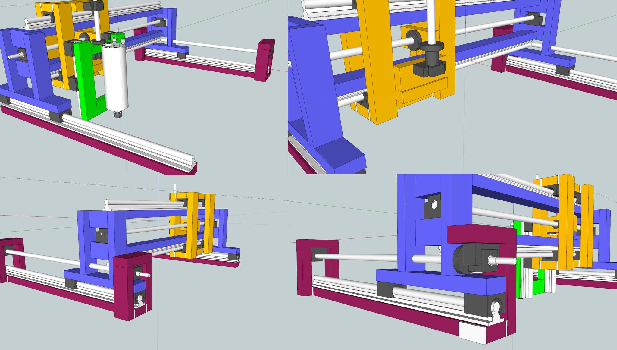

i've added steppers to my drawing.
brackets are made up of 5mm steel welded in to shape and i think maybe bolted to the box section, the top of the stepper supports will have slots for tension of the belts.
i've also beefed up the underside of the bed.
Attachment 7588

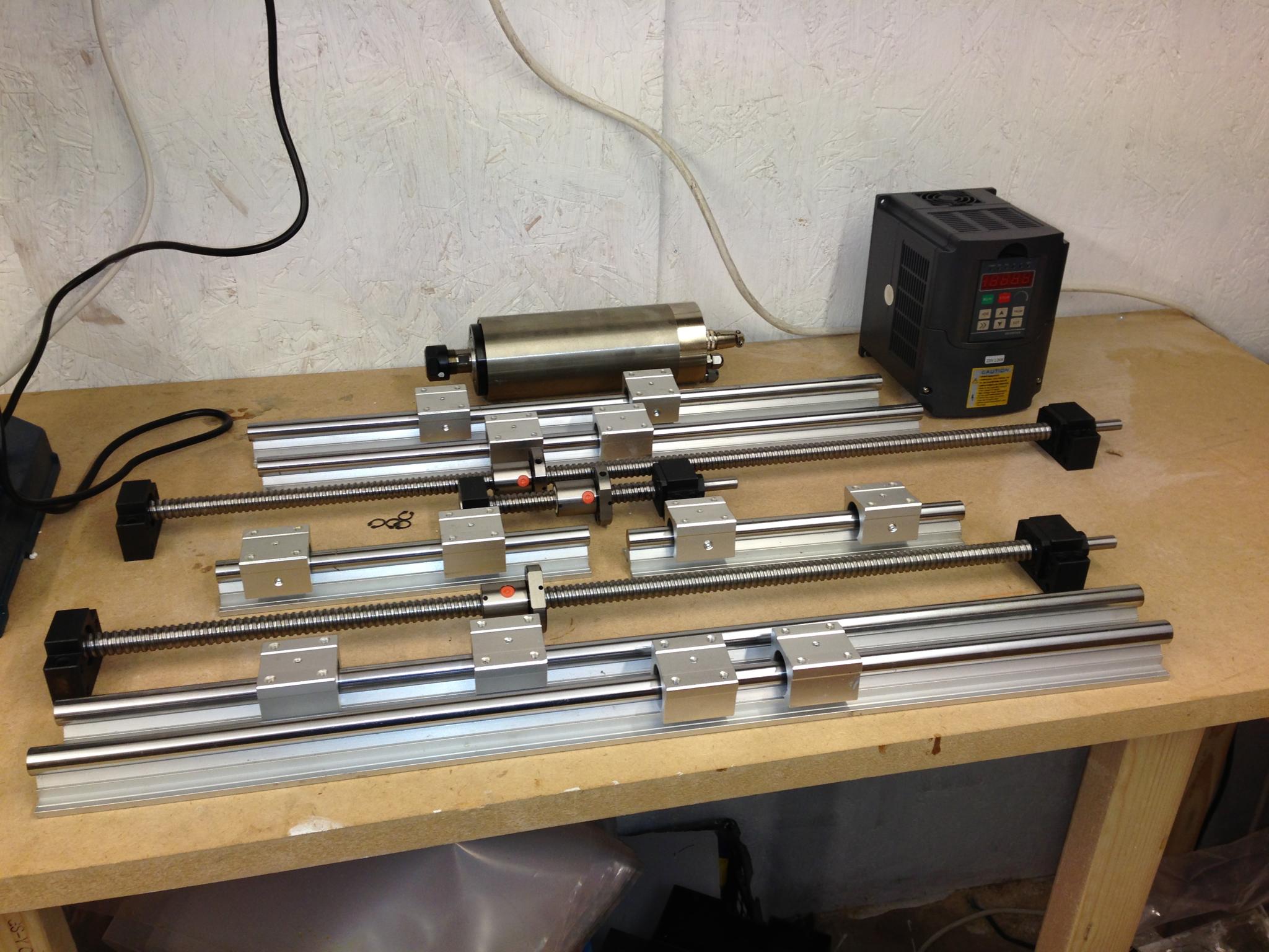

more goodies as expected the bf/bk blocks did come with the spindle and vfd
Attachment 7630
and heres a shot with them all together
Attachment 7631

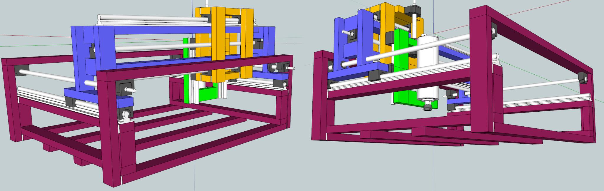

I've done it!!!
that is designed the whole machine using only 50x25x3mm box section..... oh and a little bit of 25x5mm flat bar as very helpfully recommended above... i had to give in somewhere as i needed 60mm spacing in a few places which using 50mmx25mm box section wouldn't allow... the fact is the flat bar adds on £4 to my total order so i cant grumble about that.
so the picture below is obviously missing a bed, but i have basically spent the last week or maybe longer re-designing this whole machine within the limits of the screws and rails I've already received. the reason for this was due to me using the drawings from another site for the rails and bearings making basically all measurements out.. but it actually worked in my favour as it reduced the need to have 60x40mm box section in my build.
the colouring is purely to make it easier to count the lengths and for me to picture which bits move together, so purple is the x axis and the bed when its done, blue is the gantry, yellow is the y axis carriage and green is the z axis carriage. i am also yet to design a spindle mount as i am planning to do this in another program so that i can export it to dxf and have some lucky member from here cut them pieces for me, the plan is to mount it to the 2 pieces of box section that the rails are mounted to.
Attachment 7776
the biggest changes to this from my earlier designs are the x axis screw is now located a hell of a lot closer to the bearings which if i understand right should reduce any racking, my only concern here is do i need to add a length of box section on the outside of the screw bearing mounts to reduce flex here? in my mind they don't go under any stress when the screw turns but if someone tells me i'm wrong it'll be the next change.
I've also reduced the height of the machine which is one of the reasons there is no bed at present as the current z axis would smash straight through the previous design, the height now from x axis bearing center to y axis bearing center is 265mm.
all the bearing spacing's are as follows
z axis center of bearings on rails 120mm
z axis rail spacing 175mm ( should be 180mm actually)
y axis rail spacing 180mm
y axis center of bearings on rails 198mm
x axis rail spacing 804mm
x axis center of bearings on rails 255mm
this gives a total cutting area of x = 400mm, y = 529mm, z = 100mm which considering i originally said 15"x15" and its now more like 16"x20.5" i'm very happy.
the total length of steel up to here is around 8mtr's of 50x25x3mm and 1mtr of 25x5mm flat bar so i have around 7mtr's left to make the bed with which i know will take most of that 7mtrs. that brings the total cost of steel to £76.31 and the only other things i need to fabricate are the spindle mounts and stepper mounts which i have a feeling both will come from alu but i'm not sure yet.
so provided i dont need any more steel the total to date is £629.18 and thats for spindle, rails, bearings, screws, ball nuts, screw bearings plus all the steel to fabricate the frame

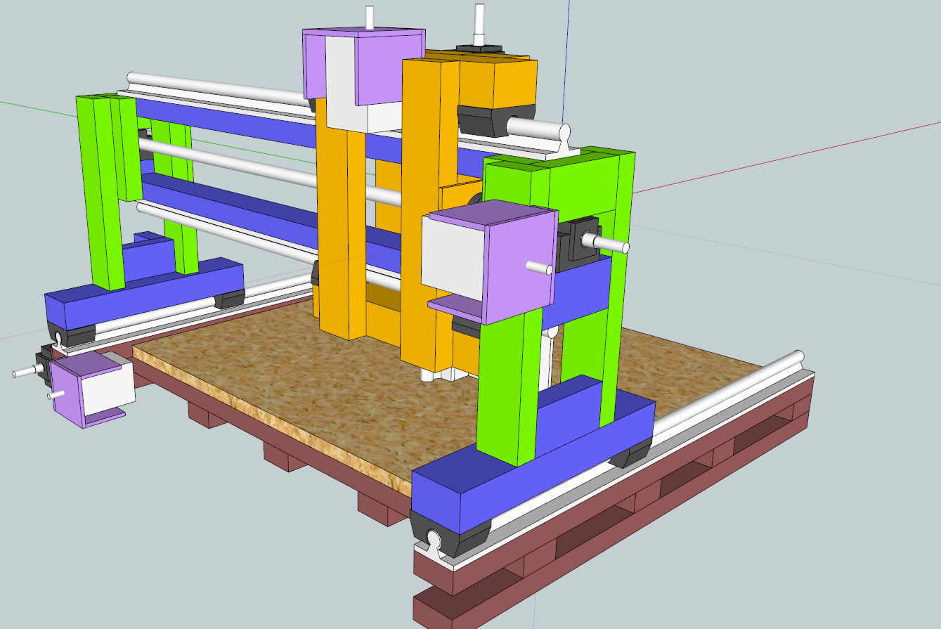

re-designed again.. this time i've included a second ballscrew on the x axis, now due to my mis understanding of earlier comments i've kinda messed up a little bit in that i designed the machine to work around a single screw on one side. i've now been shown the errors of my ways and intend to fit a second screw. but i will go ahead and build the machine get it all wired and working to an extent before i order the second screw.
so here is what i hope to be my final design.
Attachment 7870
i may change it a little as far as mounting the bearings for the x axis screws as it's come to my realisation that the spindle will hit the cross beam at the front before it gets to full extension thus cutting about 40mm off my workable area. i've also realised that had i not rushed in to buying the bits from chai i could have either reduced the size of the axis screws for the length of rails i have or better still ordered bigger rails as there is about 75mm of wasted travel along the x axis, but i'll have to live with that as long as i get my 15" mininmum cutting area i'm happy.
this kind of stuff hurts far less when you have not yet started building!. Your far better at sketchup than I!!!.. Im no expert but do you think the gantry beams (purple) may be a little thin? not that it matters I suppose because you can always add extra support if it does flex. As the two beams are on their side I should think they will be ok on the X plane, however applied pressure on Z while Y is in the middle may perhaps cause flex? Mind you it is only around 15" wide so it might be ok... what do you think?
when do you hope to start building?
i had thought about them being a little flimsy but then again it's a 15" piece of 50x25x3mm steel box section, not alu extrusion so i dont really know, i would like to think it wouldnt bend but who knows. and for the record it wont be a simple change to strengthen it without making the machine bigger as the ball screw running through the center of the y axis would prevent any support being added between the 2

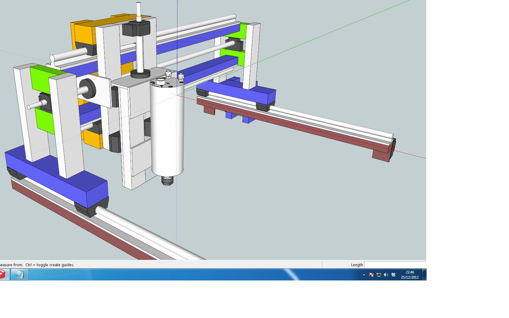

right, i've finally too jazz's drawing and re-drew it back in to sketchup. i couldnt get on with rhino, its possibly something i'll go back to as i'm aware sketchup isn't that great for actual cnc work.
any way here it is
Attachment 7900
all colour coded as previous designs, the white flat bits are 50 x 5mm flat bar.
travel is around 450mm x axis, 578mm y axis and 100mm z axis.
i havn't worked out how much steel is used here, but i know already it's going to come in well under the 2 lengths now.. but as a trade off i've gained 50x5mm flat bar so that total cost of the steel as i said before will be £90. i'm happy with that and i still feel it's going to come in under my £1k budget.
i think it's time to start clearing the garage up a bit and think about ordering the steel :D
