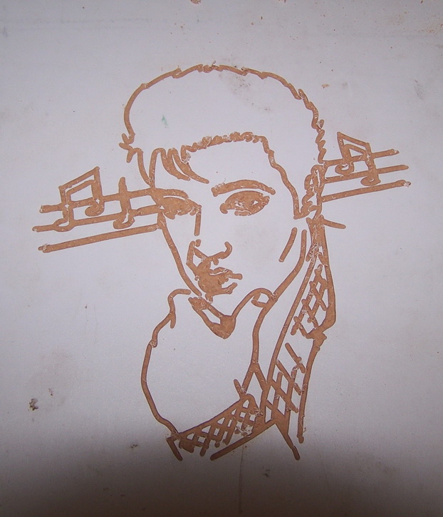

Attached is a short run video - I really should get the camera out before I start aye :whistle: anyhoo I'm pretty sure you can pick who it is that's being engraved, all I need to do now is get the probe working i.e. retracting on touch not spinning the motor and twisting the probe cables in to a ball :crushed: The finally motor tuning ended up at 400s 2500a 200v - my initial test of this setup resulted in a 100mm straight line on X and on the Y so with that, WOOHOO although I still need to sort the Z out, time to sit and mind melt over the mach manual
BTW the line art used for this came from my tattoo line art collection a job I did for a few decades before I got bored. . .
So if anyone is looking for anything in regards to line art feel free to let me know, odds are I've probably got something that can be worked on if not exactly what you want.
