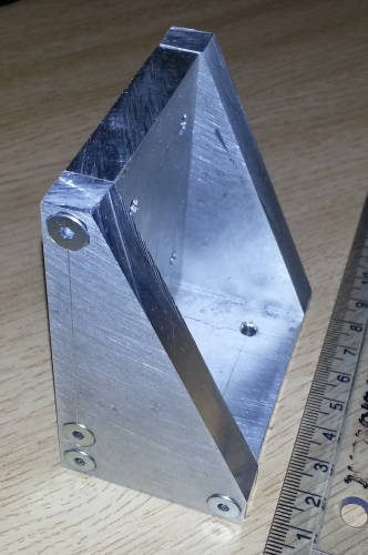

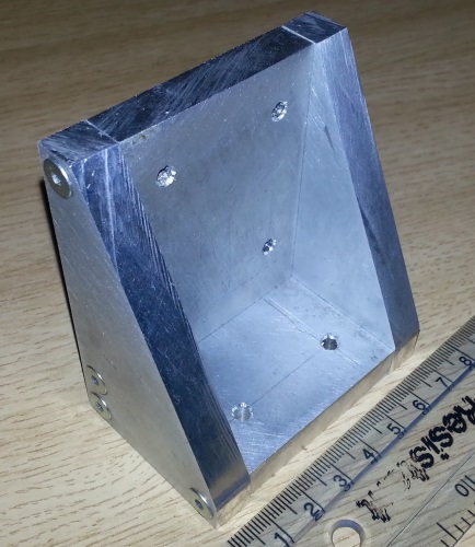

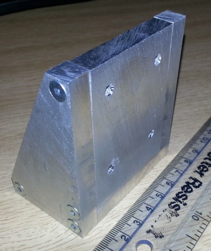

I met up with Neil the other night to swap parts from a joint buy and he kindly gave me a bit of 10mm plate to have a practice with. When I first saw it my heart sank - it looked distinctly too thin to build a machine from. I thought I'd give it a crack anyway and build one of the 8 brackets that I plan on using to support the X-axis and here's the results:
Attachment 10571Attachment 10572Attachment 10573
The angle from the base to the back is 89.7 deg which I'm fairly pleased with considering this is my first attempt at metal work. It's surprisingly strong but is it strong enough? The the parts we first roughly jigsawed (or hand sawn once the jigsaw blade gave up) and then cut to exact size on the mitre saw. The accuracy is ok but not exactly the perfection I had envisioned. I'll have to decide now whether to get some kind soul to mill the parts for me or to press on with trying to cut the pieces myself.

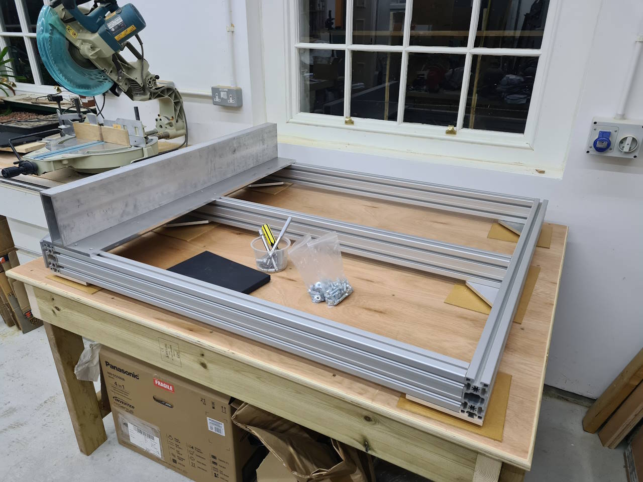

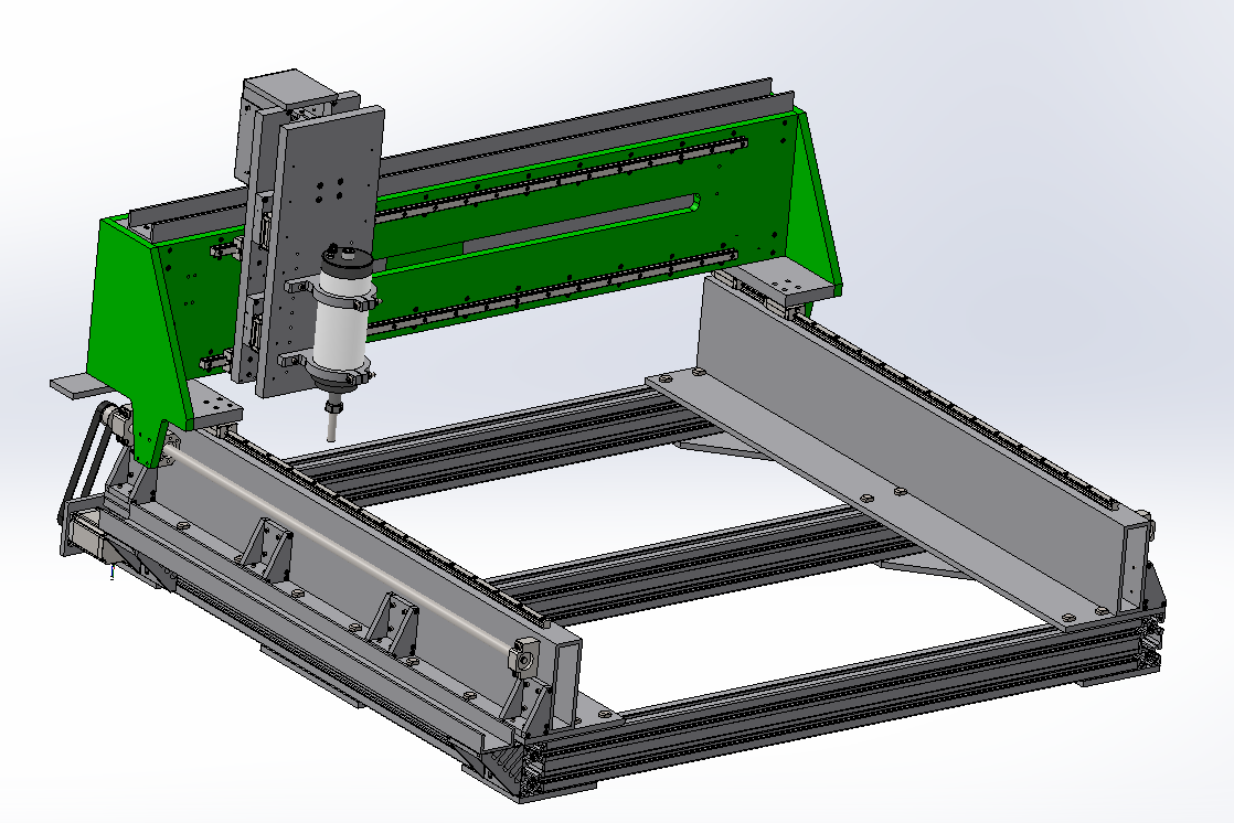

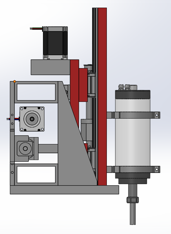

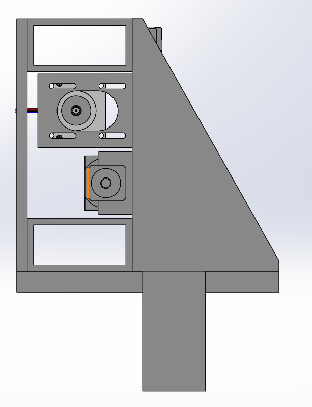

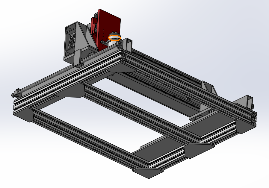

Anyway, it's been a while (cough, 10 years) but I've finally got around to starting to build this CNC. I started by building a sturdy bench for it to sit on. I was on safe ground here. The cross members are 2x9's and it's covered with a sheet of 18mm ply.

I made my first mistake while making one of the support brackets for the x-axis box section. I was rushing and I managed to break a drill bit. In the replacement hole I then managed to break a tap. :applouse:

Not quite sure what the problem is about squaring - it might not be as bad as you think!
On my own machine, I bolted down one rail to the frame as straight as I could. I then used the gantry to align the second rail to it, to guarantee parallelism - just enough slack in the mounting holes using M5 (from memory) bolts to allow the second rail to move slightly, then slide the gantry back and forth to get it parallel and tighten bolts. I built the gantry as accurately square as I could, and once the machine was almost finished I could take test cuts and then adjust the gantry to be as square as I could measure from the test pieces. How to square it? Again, in my case, I was driving the gantry at both ends so I could adjust the home position at each end of the gantry so that each time it homed, it automatically re-squared itself. I had arranged the gantry itself to be bolted to "feet" at each end which carried the ball slides and during the initial squaring, I could slacken the bolts slightly to allow the gantry to swivel slightly, then tightening once I was happy. The process does rely, obviously, on having a master and slave drive to the gantry, one at each side, and the motion controller needs to support separate homing of master and slave axes.
There is an underlying design principle in all this. For a home-built machine, where you do not have the machining and assembly facilities to build accuracy immediately into the machine, you need to build in wiggle room so that once built, you can adjust everything. "Adjust on assembly" is an expensive nightmare in a commercial setting so you pay a fortune for manufacturing capability to build in accuracy. As amateurs we don't have that luxury but our time costs a lot less so we do it the hard way! But it works - witness the number of successful machines described on this forum. Good luck!
Thanks, Neale. I'll have another think about it. What you describe is pretty much what I'd planned on doing and then I was standing there yesterday looking at the parts and I started wondering if it was going to work. My concern in terrible ascii art is something like this:
Ah, now I've drawn it out I can see the method you describe will work. You just use the second x-axis stepper to pull the gantry into alignment.Code:y axis (in home position)
