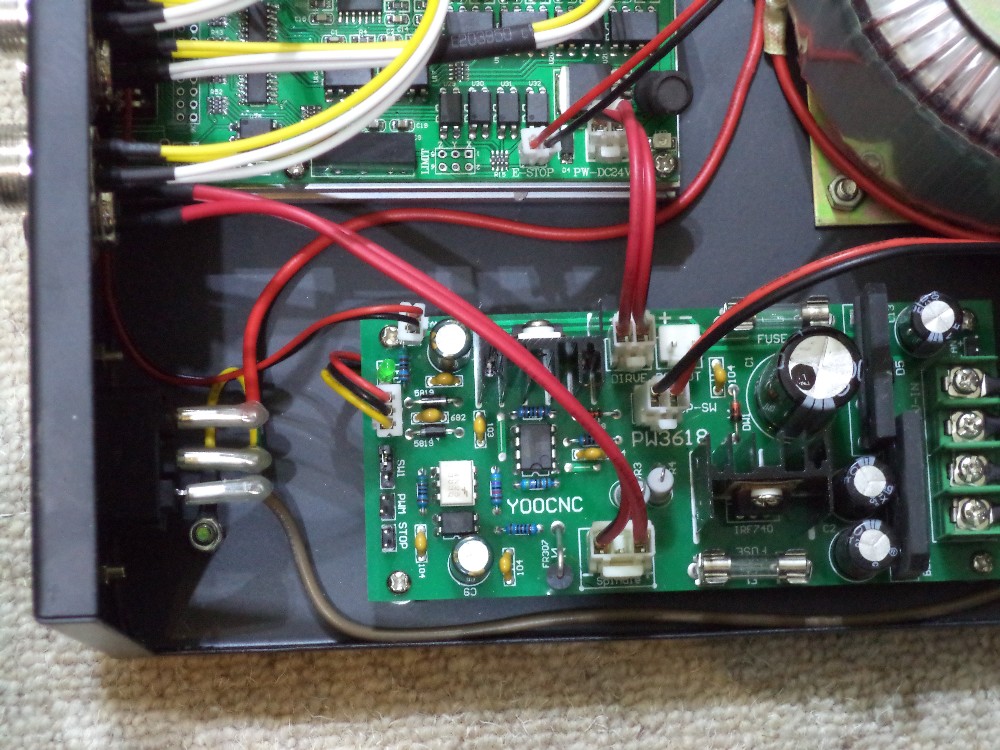

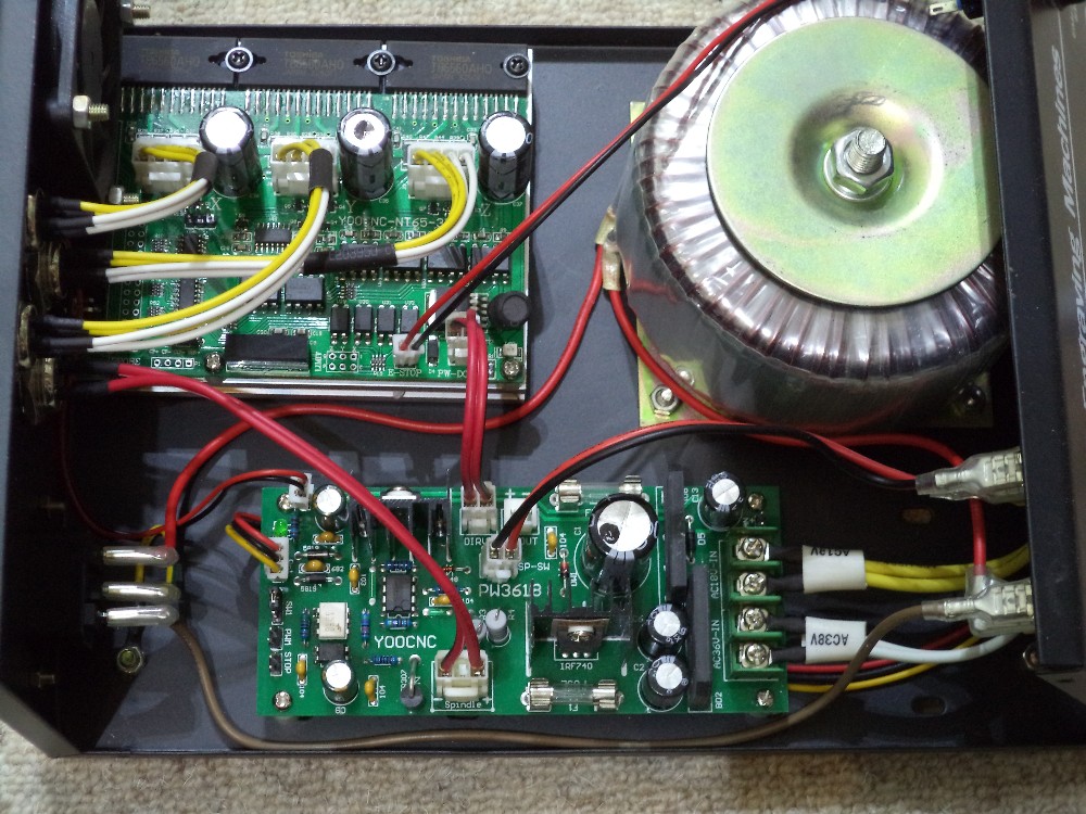

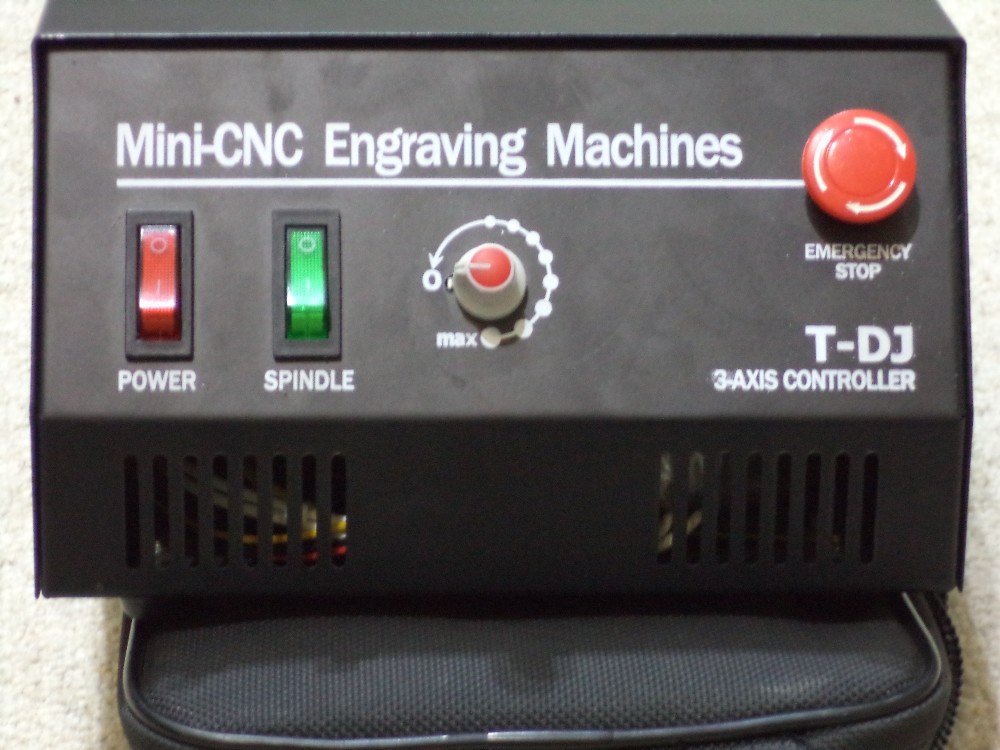

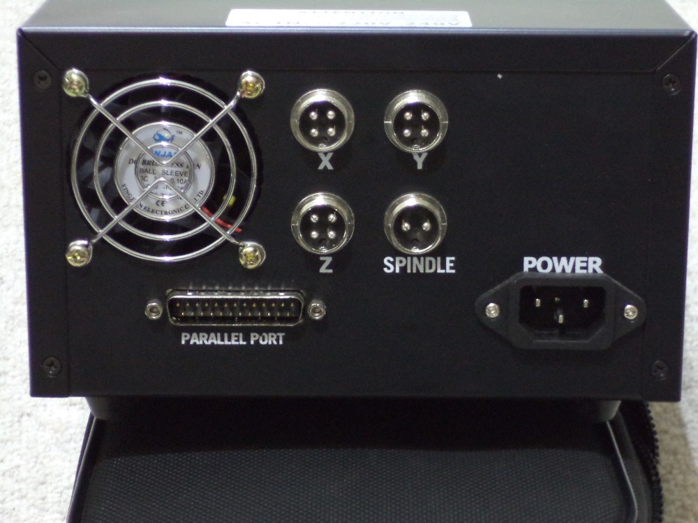

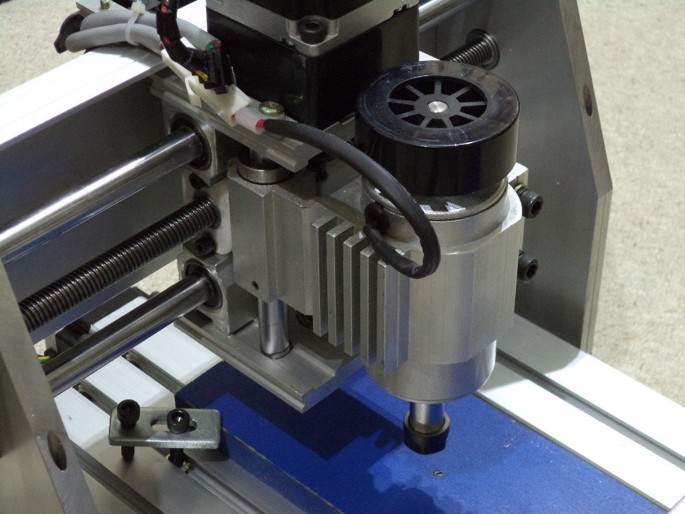

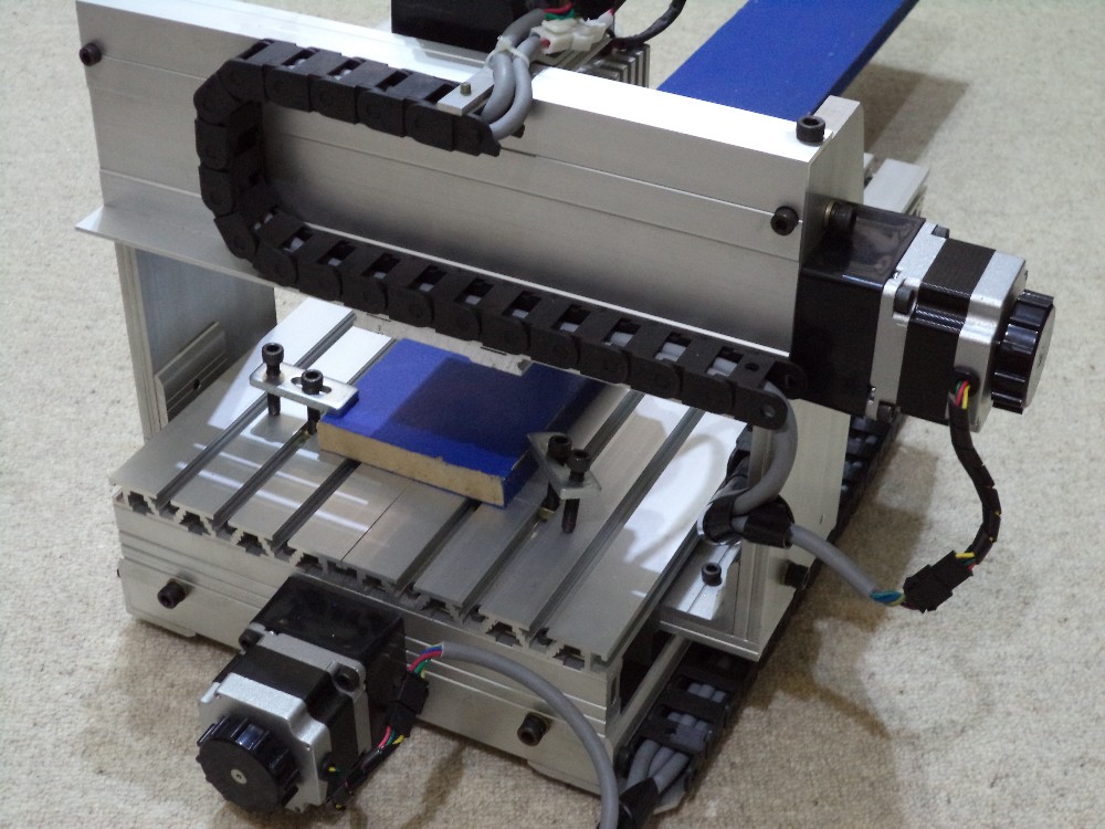

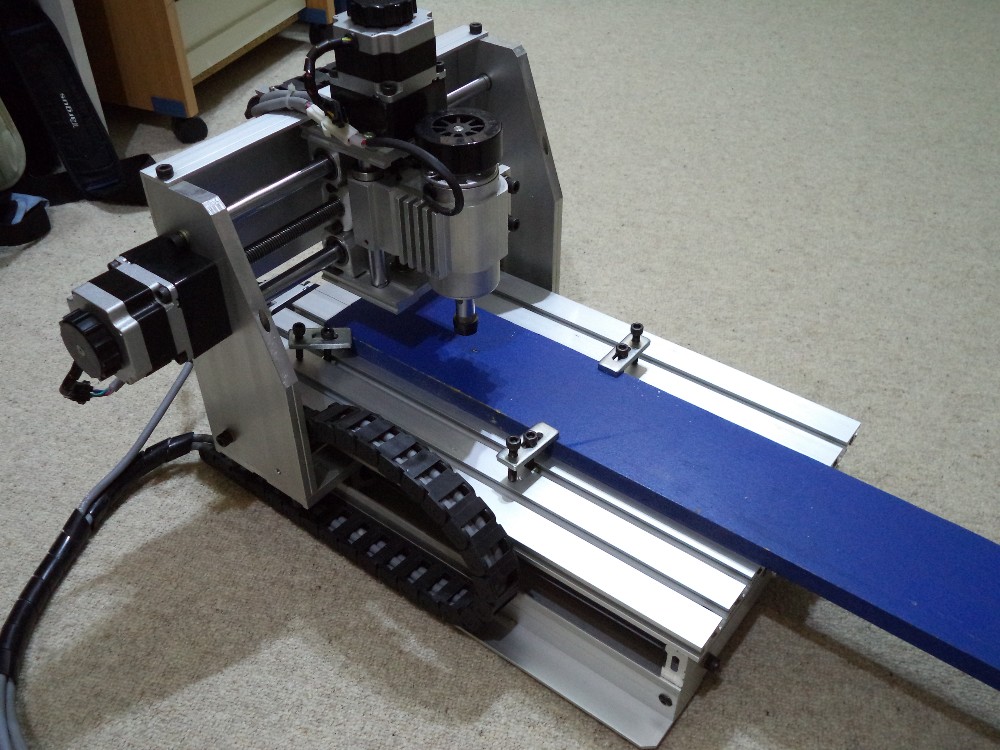

I recently ordered the smaller router 3020 and have a very similiar opinion.
Awesome Packaging.
Mechanically it seems very solid.

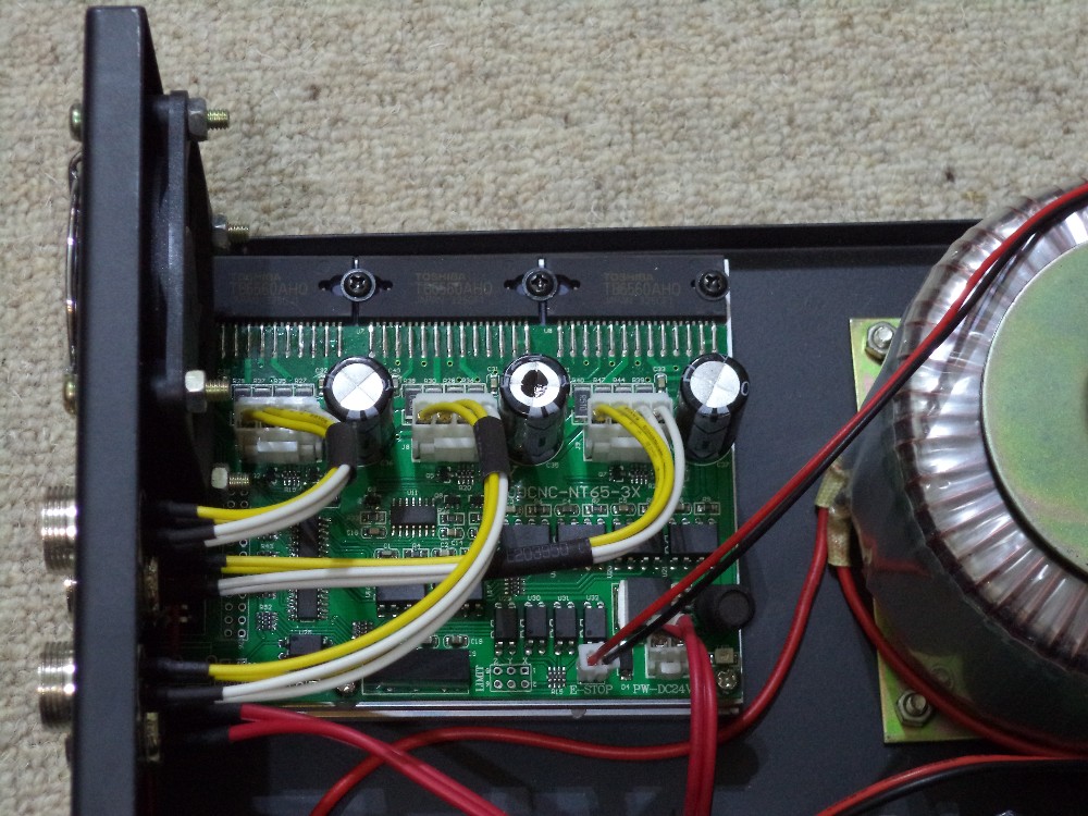

Electronically it looks a little heath Robinson.
I have read many sources reporting the Earthing on the Unit is pretty sketchey.
I have also been reading more interestingly about apparently it is very easy to MOD the circuit and allowing you PWM motor spin control using MAch3.
Chinese 3020 CNC Machine Gets Some Upgrades
I haven't really had a chance yet to inspect the earthing or prize open the control box and inspect the stepper control board but I intend to do this soon.
I get the impression these machines are knocked out in one or two fairly small factories and then the choice of boards/PSU/steppers is all dealt with by someone else along the supply chain hence why we all seem to have slightly different kit. Also with varying prices depending on what the machine comes with.
My machine was 380 GBP with delivery from Southampton which for my needs is about all I could afford.
I think with the info I know now I would have preferred to buy just a RAW 3020 or 3040 I hear you can get them flat packed directly pretty cheap and then choose my own stepper boards and own steppers and own spindle motor.
My supplier although friendly - in terms of CNC knowledge is ni on zero and effectively once the machine arrives bar ensuring its not DOA or damaged in the post thats about the only support your gonna get.
In a weird kinda way I kind of like that idea LOL.
My intended use is for engraving DIY Synth Panels on traffolyte board. I have seen a friends of mine CNC machine actually cutting the traffolyte but I have a feeling this little machine might not have the grunt required to pull that off.

If anyones interested I would be very happy to post pictures of boards, aspects of the machine. Mainly to help others who might be in a similiar position to myself where by a massive block of metal turns up. A mountain of kit, a pigeon english manual and a supplier that can say yes and no!

Tomorrow im gonna hack open the control box and take some pics. I am quite tempted to fix the earth issue (if its broke) and maybe tackle this automated drill speed control MOD if it looks easy.
I will definitely upload pics and ask before the soldering iron appears.

So to keep on topic here are some pics of my Opened UP stepper control box and also some pics of the machine.
Attachment 11830
3020 Router/Engraver
Attachment 11831
3020 Router/Engraver Rear
Attachment 11832
Spindle Motor

Attachment 11834
Stepper Controller Front
Attachment 11835
Stepper Controller Rear
Attachment 11836
YOOCNCPW3618 & YOOCNC NT65-3X
Attachment 11837
YOOCNCPW3618
Attachment 11838
YOOCNC NT65-3X

I am also wondering what peoples thoughts are about the Spindle Motor MOD making it PWM control via Mach3 as opposed to the switch and speed control pot on the control box?
I can see advantages and disadvantages for both options.
Looking at the board there sure is a free pin labelled PWM thats on the board with the 555 timer on it.
The boards I have are:
YOOCNC PW3618
YOOCNC NT65-3X
The transformer I have is Torroidial 220V Primary
Secondary 0-18V
Secondary 0-36V
Semiconductor Component list as follows (well most of em lol) :
PW3618
4N25
EL817C328
NE555
NT65-3X
TB6560AHQ
EL817330
EL1373201501-50 1304AL
SS14
If required I can also knock up a layout in Corel just so you can see what IC goes where.
There are also x2 74HC SMD components but I cannot find my magnifying glass right now to see the exact number maybe its a 14 but not 100% atm.
Finally I did check the earthing and yes as warned its pretty sketchey. The main chassis is earthed but half the motor out pins the metal shield is not earthed and also the fan covers are not earthed.
I assume most of thes eissues are caused by powder coating the box then fitting the stuff without exposing the metal.
