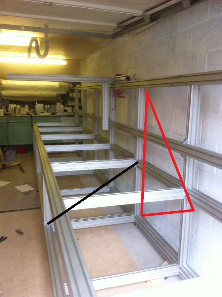

I mentioned it in a post earlier that i am geting a small amount of flex from the main back uprights which for the surfboards really isn't a problem as the load on the machine will be close to nothing cutting foam however i would like to try and reduce it as much as posable. I have been wondering about two options the first being bolting a pice of 90deg angle steel to each leg ( i cant get large enough channel or T section) and the second idea was to fill each of the current aluminium legs with a resin/granite mix or maybe even a concrete mix which i have been reading about which may help in other ways as well.
Can any one give any suggestions as to what may be best?
many thanks

Bolting to the wall with brackets would be a quick simple fix. But if you have to move it so that it is free standing you might be able to triangulate the back of the uprights bit like an apex roof truss on end. ..Clive

In terms of improving what you have - I don't think you'll get very far filling the back supports, or adding angle iron. You are looking for a big step change to make a difference. As Clive suggested either bolting to the wall or adding diagonals on each end coming forward to the front of the machine and onto the floor would be much better.

Charlie I think mentioned before that you needed diagonal bracing on the lower frame and this would help your problem quite a bit but really your easiest option is the wall.
Personally I would brace the base along its length like the black line show and try it, but at same time a few brackets to wall would cure it easy. Then if you ever need it free standing then make some triangle supports (red lines) for it which go at the rear and bolt to floor.
Also becareful with those timing belts that you don't over tighten and pull the ends of the ballscrews inwards and cause them to bend or bind. The belts don't need to be drum tight just not loose.

i have posted a few more pictures bellow you can see i have all ready braced the corners of the table area which improved it a lot and stopped any movement in that area. I could brace it more underneath but i think the flex is coming between the top of the table and the top of the verticals. would filling the extrusion help with dampening any of the vibrations or flex down? would it be a good thing to do any ways?
I will have to maybe look into bolting it to the wall but i would like to see if there was any way i could improve it before hand using other methods.
I could probably put plates in the corners of the verticals above the table as well but they would have to be taller than wide so they do not interfere with things on the table.
I have adjusted the belts a bit and just pulled them hand tight before any signs of flex from the screw so will leave it like that at the moment many thanks for that info i was originally assuming they had to be pretty tight to work.
