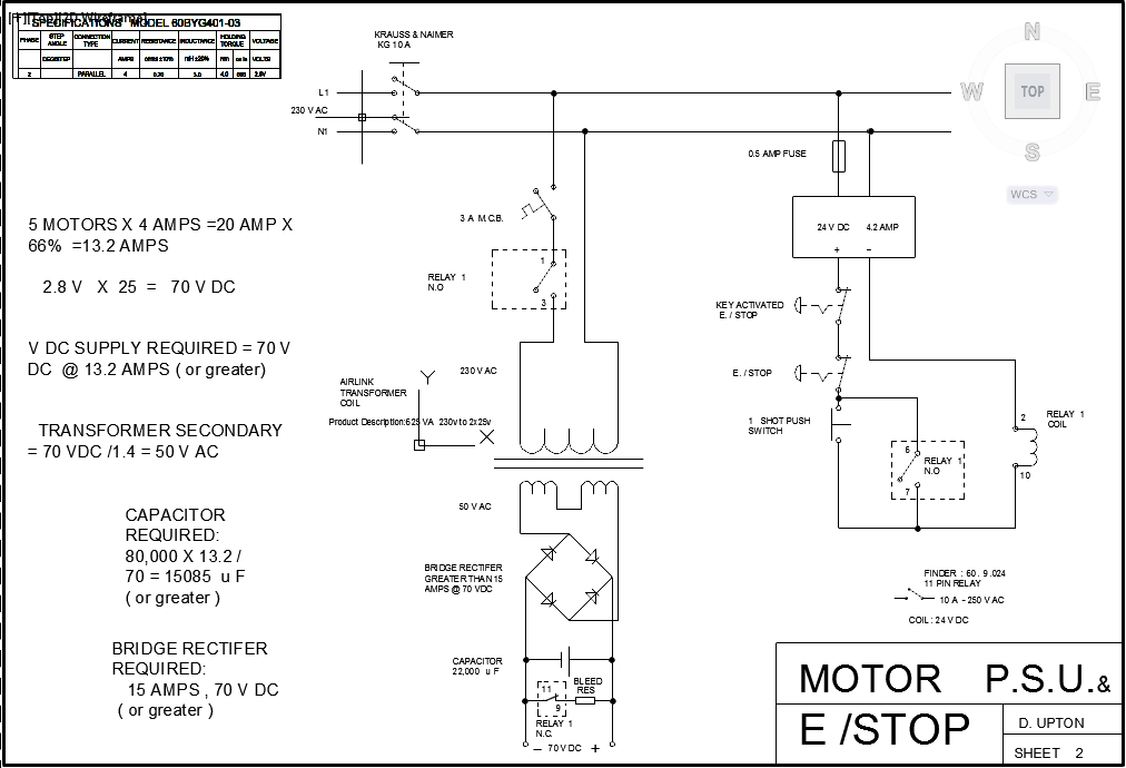

cheers for the driver info. i had calculated for 5 motors even though i will only use 4 for the time being . the 5 will draw 13.2 amps @70 vdc hence the 750 VA.
The 625 VA delivers 11.90 amps. i hope my calcs are correct! is there a way around the in rush of current?
Yes Don't turn it ON. . . :joker:
You can build an inrush circuit using resistors, thermisters etc but I prefer to avoid this and use smallest transformer possible and then use a C or D rated fuse if still trips which I rarely do upto 625va. Can use slow blow fuses as well.
To be honest I very much doubt you'll ever run 5 Motors at same time that pull full amps at same time so I'd still go with 625Va and 12A.
As all 5 motors won't be drawing maximum current at the same time, allowing for around 70% of the total quoted current draw should be plenty.

I have the PLCM-E3 motion control & PLC4X-G2 breakout board ordered but they will not be with me until march because of Chinese new year. i am using the time to try and get to grips with the electrics / electronics and hopefully start into the MACH 3 (getting to know you period !!) i know some builders on here do not use bleed resistors to drain the caps from the power supply . i was going to leave the drives drain the caps as suggested on various posts but on second thought said i would at least try and get to understand how it done and maybe use a bleed resistor across the n/c contact of the e/ stop relay to keep to good practice and safety as pointed out. i came across this https://www.digikey.com/document-red...calculator.xls i have a result of 1000 ohms over 35 seconds with initial power at 4.9 watts. OR 1710 ohms for 60 seconds with initial power of 2.8 watts. i don't know if these resistors are viable because i've absolutely no prior experience to work from. maybe they will do or perhaps previous builders use a different spec. i have also updated my electrical dwg to reflect my proposed capacitor bleed arrangement. any feedback on this will once again be greatly appreciated.
I like this better;
Attachment 14708
The way you had it created a short circuit across the 70v DC, only relying on speed of operation of the relay to remove it.
Cheers Eddy, i'll update that . the older i get the more cautious i'm becoming just as well i put it up for a critique. :thumsup:
I'm not sure if I would bother with the relay switching if you are using a reasonably large value of R. Use something like 4K7, 3W, wired directly to the capacitors, and save a relay contact and associated wiring? Probably about the same current draw as three quiescent drivers, so maybe not worth the effort, but it would drain down the caps even if everything else were disconnected during testing. I must stick a meter across my power supply some time and see what happens - I don't have any bleed resistor in place.
Probably not a lot.! Depends how you wired the control box.?
If the Drives are kept in the circuit and not removed say thru a relay then they will drain the Caps resonably quickly to within 5V last time I checked.
Not a fan of leaving resistor in all the time as it's creating heat and we want to remove it not make it.!
Personally, I wouldn't bother with the resistor at all. Seems like unnecessary complication, given three or four drivers draining the caps on power-off. Main use would be draining the caps during testing with nothing else connected, but that's a bit artificial anyway. Heating was why I suggested the value I did, which would only be dissipating a watt or so, but why bother?
Depends on how the control is wired.!
One reason to bother is that when a drive faults or E-stop occurs the motors will continue to rotate for fraction of second until power is drained. No big deal you'd think.!! . . BUT. . it is a big deal with Slaved motors if one drive faults and other doesn't because the one that doesn't fault remains under power until power is drained. The faulted drive removes power and stops rotating so the gantry gets racked every time.
Initially i was not going to use a resistor because of the drivers draining as pointed out. i've read a lot of posts that discuss this and i know a lot of the experienced`builders don't bother because of the reasons stated. but i will be using a relay in the e/stop circuit anyway and it will have an empty N/C contact available so it's an extra terminal for the resistor and an extra piece of cable to hook it in. i think that's all that's required anyway? if i don't use it i will definitely integrate the fault relays and enable signals as Eddy suggested. on another note my toroidal coil arrived friday. i should have the cap and bridge this week, hopefully. the coil has 3 windings http://www.airlinktransformers.com/c...nge/CM0625225/ the colours are as follows: coil 1 BROWN / BLUE 1.6 ohms

and if i join BLACK and YELLOW together power up and meter across RED and ORANGE i should get 50 vac OR 0 vac . a change of the secondary coil arrangement if i read 0 volts. i will try it tomorrow to see.
Recently bought one of the Airlink trafo's. Join black/yellow together and red/orange will give you 50v AC or there about.
