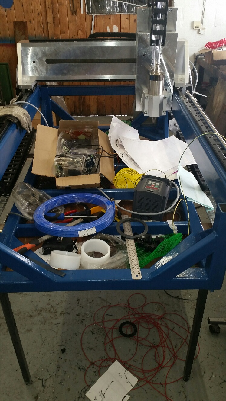

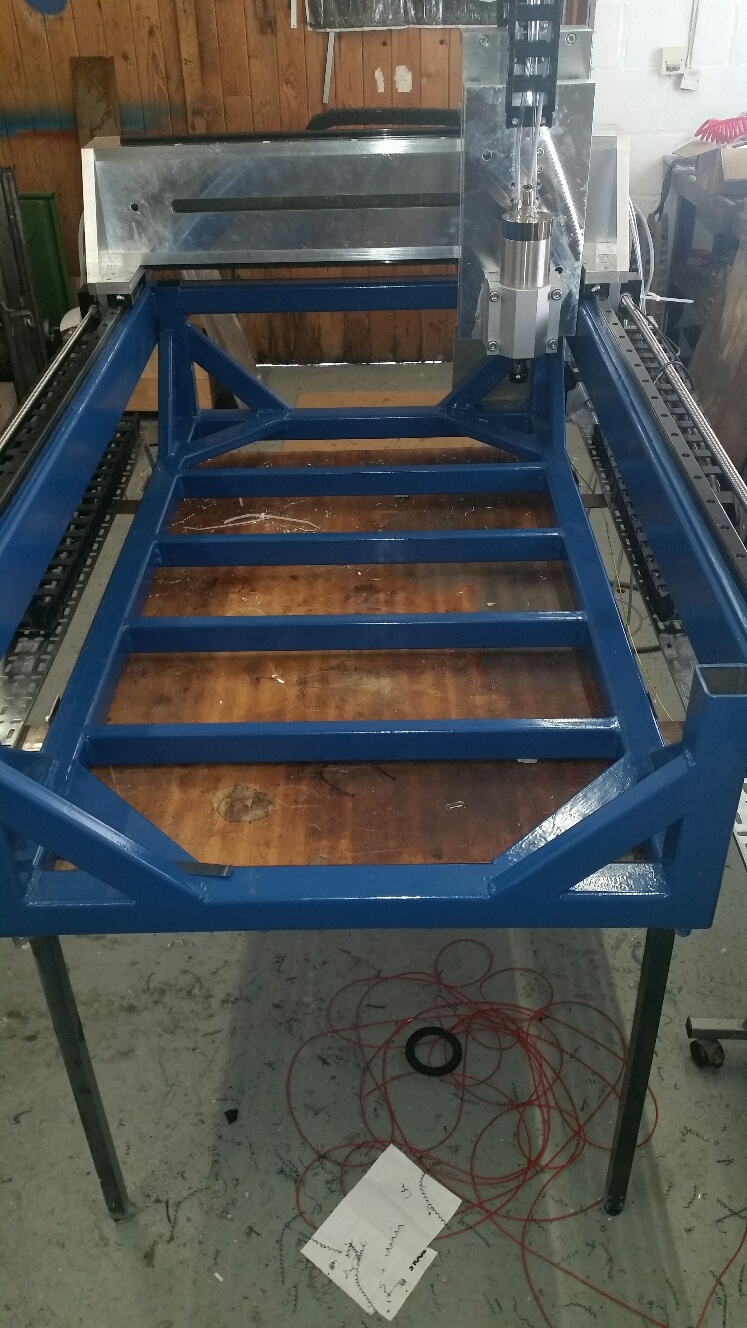

Looking forward to more updates soon!! I can relate to the clearing crap off the table....here was mine this morning.....second is this afternoon as I'm going to start back on it again ASAP.....
Attachment 15992
Attachment 15993
