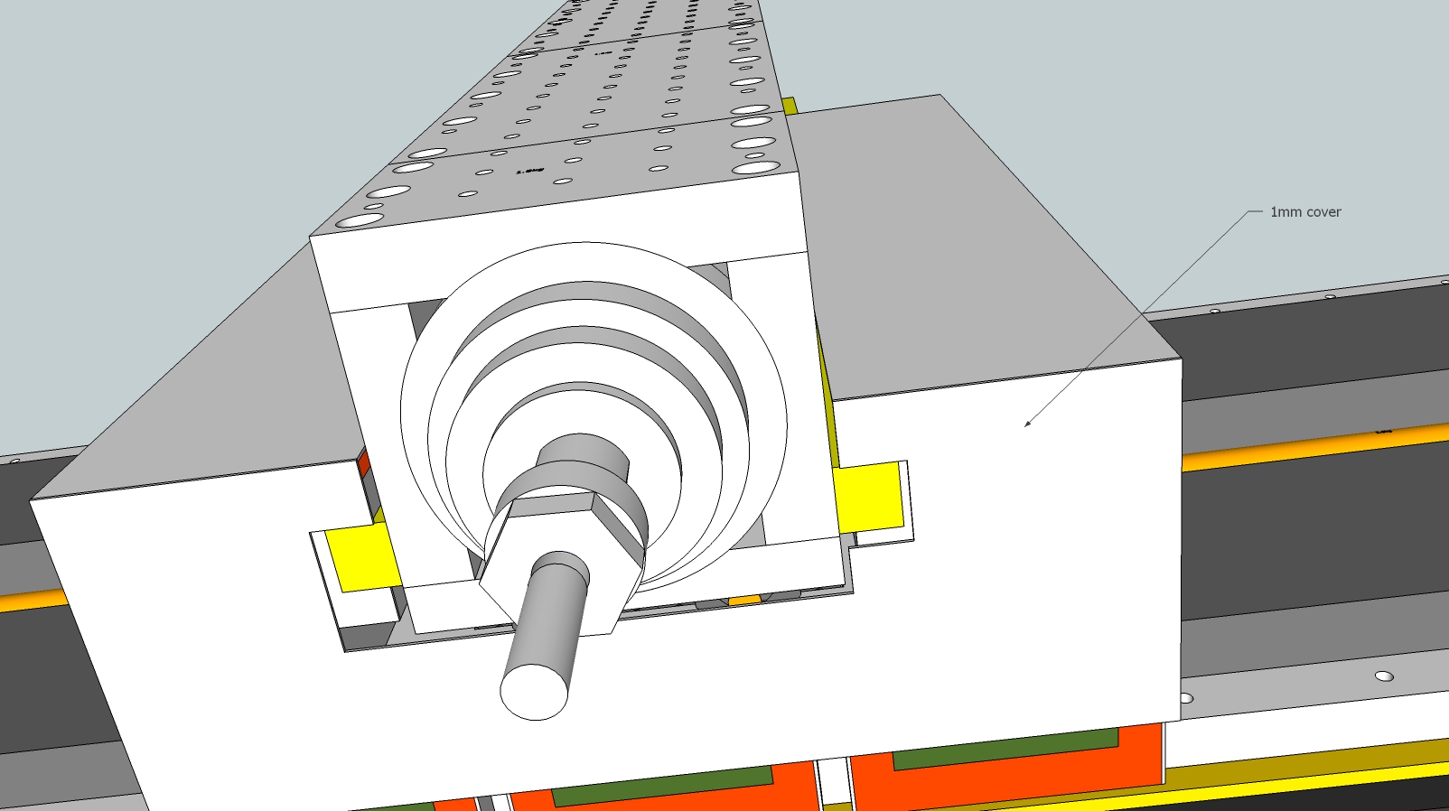

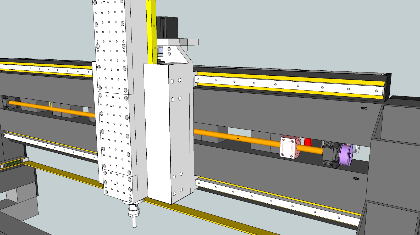

Fitted and aligned the Y ball skrew and complete Z axis, so most of the mechanical parts are done now.
z front plate before all the drilling and tapping
http://www.mycncuk.com/attachment.ph...id=14523&stc=1

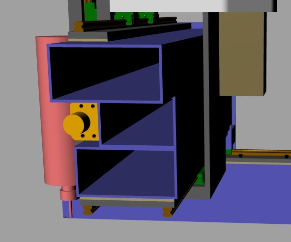

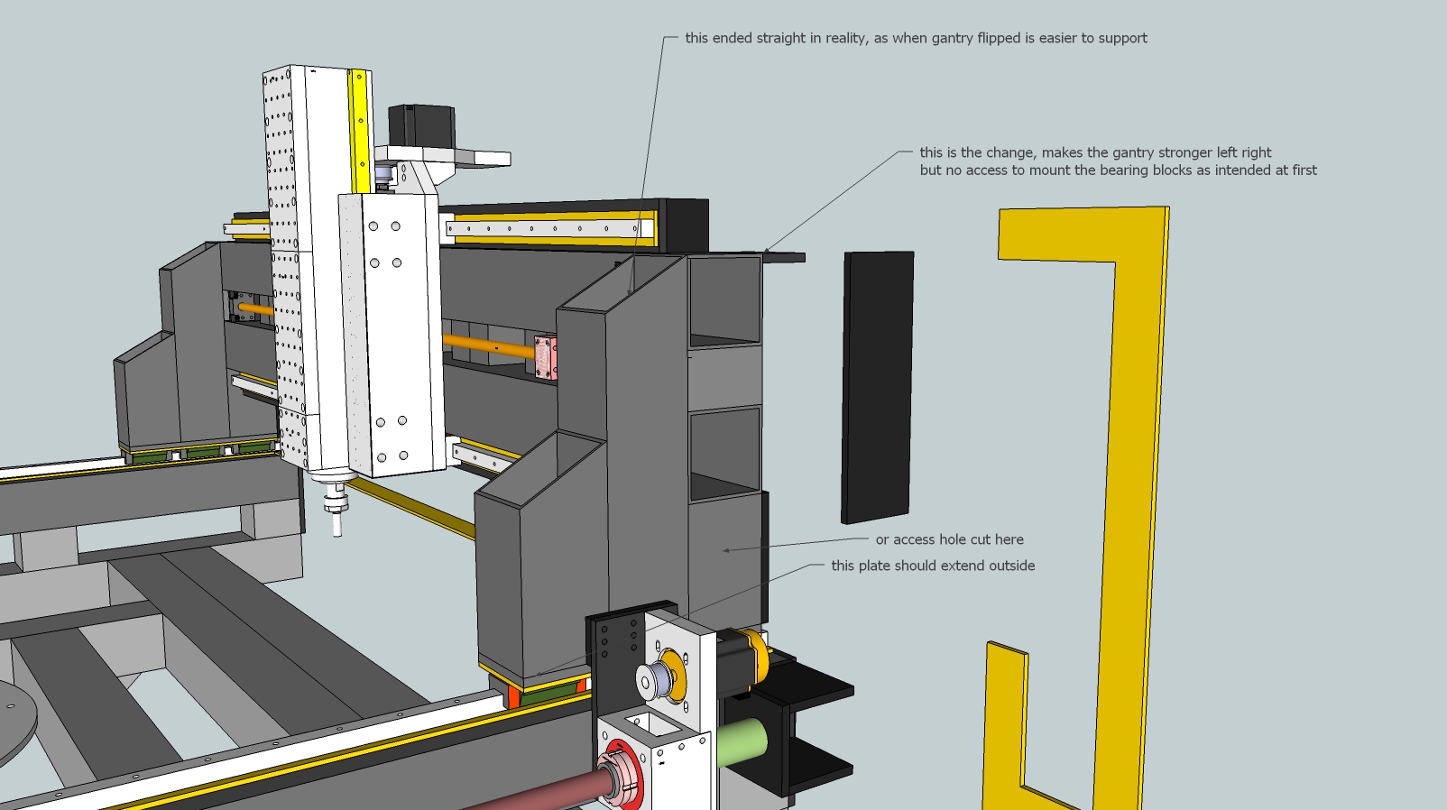

Had to but join rails for my Z due to a change in plans. Was quite surprised as the carriages runs very smoothly over the joint with absolutely no click or resistance, so it seams feasible to join rails if one has to.
http://www.mycncuk.com/attachment.ph...id=14524&stc=1
z stepper mount
http://www.mycncuk.com/attachment.ph...id=14526&stc=1
http://www.mycncuk.com/attachment.ph...id=14525&stc=1
100mm spindle fitted just to see if all the holes line up etc.
http://www.mycncuk.com/attachment.ph...id=14527&stc=1
Now time to start with the control box which is about where I run out of skill and creativety. Wish Eddy could pop over to my place to help a bit:-) I sort of know what needs to be connected but I cant figure out a good layout to do a neat job with routing all that wires etc.

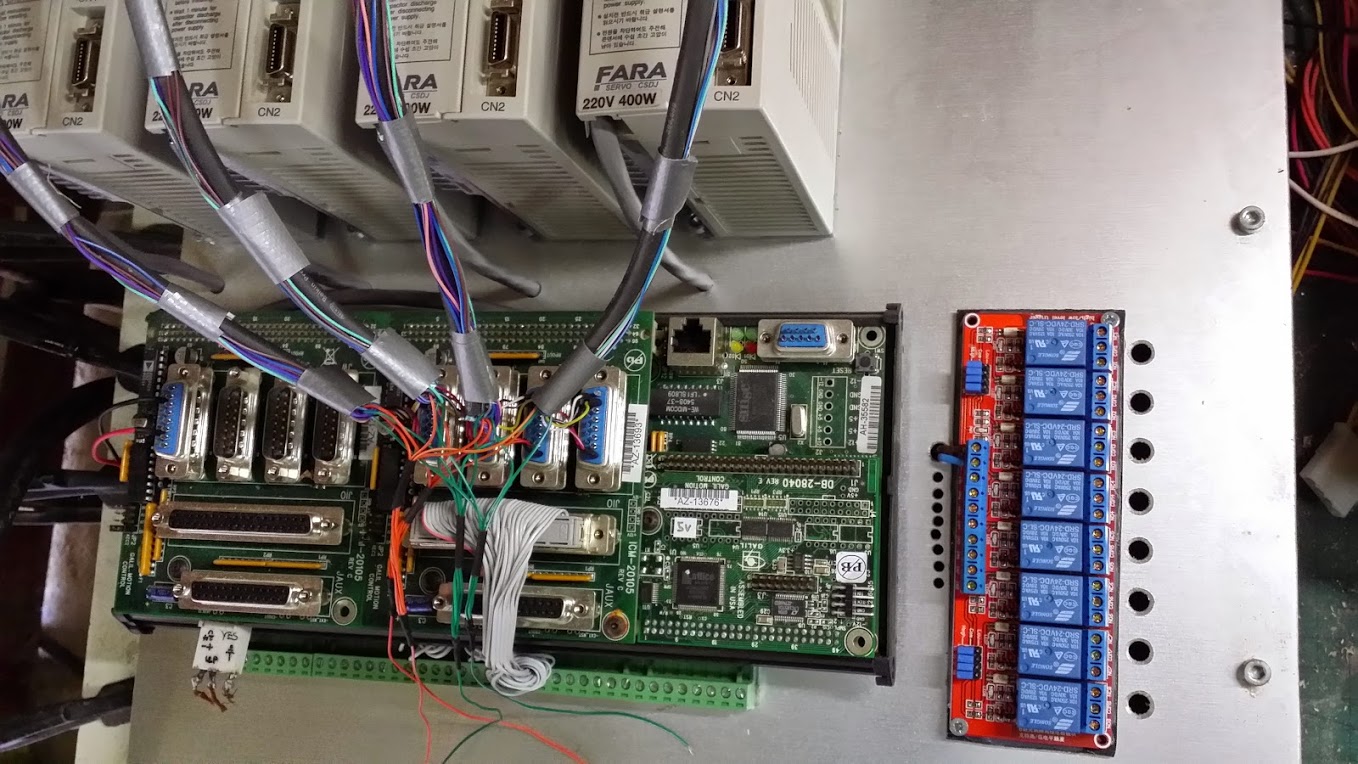

2 Attachment(s)
Re: Small rigid router - Build started
My other problem is that I don't have any tools to cut holes etc into a steel box so I have to factor that into the price.
I see a pillar drill and hand electric drill in your shop. :highly_amused: 600 x 600 x 300 should more than big enough, You don't need to put the VFD inside the control box. Just how big a box was you considering? ..Clive
http://www.mycncuk.com/attachment.ph...id=14535&stc=1
@blackrat, maybe laser cutting sheet metal is a good plan as I know its going to cost way less than what these enclosures cost but I'm probably going to have a very hard time to arc weld it together. I've tried welding thinner material but it was hit and miss and I burned holes like you wont believe even with 2mm rods, so there's much to learn in that department.
Clive, now that's a great looking box! Those LCD displays really got my imagination going... Can I extend the offer for free beer and sunshine to you :-) I'm a bit scared of butchering an expensive box with what tools I have. I have not done the layout yet as suggested by Eddy but I was guessing maybe 600x400x300 as a ballpark? Content would be 1x PC ATX Powersupply, BOB, VFD(vfd face outside the box) 4 x Drivers and few relays. The driver are quite big at something like 180x160x60 if I recall correctly and I would like some spare space for future expansion.
Excuse my ignorance but what's those white square things in your box?
mitchejc
@blackrat
I don't think you will get all that in that size box. I would think twice before putting the ATX inside the main control box as beside the board you would need a power supply, hard drive fan etc plus all the connecter to the monitor, keyboard mouse.
The LCD displays were from China about £2 each, the housing for them was done with a 3D printer. The white square things are the 5V and 24V power supply's there also another converter to step up the 5V to 12V to power the motion control board. 24V for the E-stop and 5V for the BOB.
I don't think many people on here put the VFD inside the control box. Remember most of these box housings have a bottom plate that you remove and make the holes for the connectors so if you f#%~k it up you just make a new plate.
Does the free offer include the flights. :yahoo: :beer: only kidding. ..Clive

3 Attachment(s)

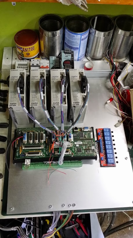

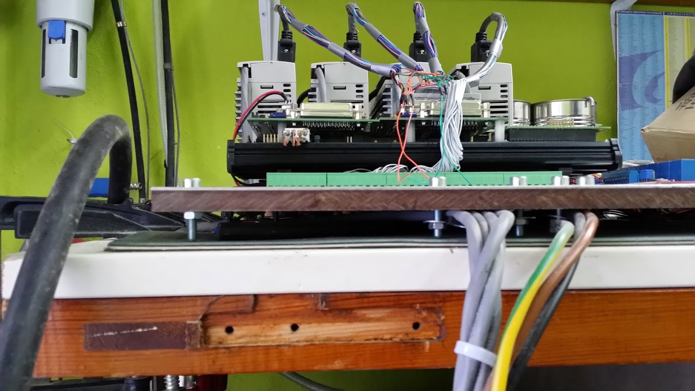

-I do it like Eddy said, shuffling the pieces until i am happy.
-The VFD for a 2-3kw spindle is prohibitively big to put inside enclosure. Plus it could mean more thick cables and so on. Plus the cooling flow. Better put that somewhere you can see it all time.
-About the fans-make them all not to suck. This is wrong, it sucks :hysterical:. Make them take away the air and fit exchangeable air filter somehow. Cheap car motorcycle tuning filter or whatever similar. You don't want dust inside.
-I dont have PILZ, could somebody explain how, why?
Now just another idea:
I also hate spending money on expensive boxes. On any boxes. On my current build i decided to use whatever i had at hand. So i had some plastic sheet and 1mm aluminum with self adhesive backing. I fixed them together and used as legs the M5 allen screws for the Hiwin, as i bought a 500pieces box.
Most importantly i decided al the cables to go at the back and not be seen, plus the aluminum plate screens them additionally.
When i finish the machine i will build myself an enclosure . At least when i spend money will spend them properly and buy aluminum and make it beautifull or at least as i like.
As i left at the left/right side of the plate 15mm free, this will slide into the new box where cheap aluminum U profile will play the role of slide.
Some pictures to get an idea. Yeah, i was tired so some holes are not drilled in a line, i have to repair that. Money should be wisely spend on a DIY build. Buying the connectors and terminals separately and soldering them in my case resulted at least in 350eur savings.
Do you see the empty space at the right side of the drives? thats for eventual 5th 6th axis. The empty space bellow the BOB also is for whatever. When i started the build i did not know. Now i know for what it will be.
LEAVE EMPTY SPACES. YOU WILL NEED THEM LATER.
http://www.mycncuk.com/attachment.ph...id=14538&stc=1 http://www.mycncuk.com/attachment.ph...id=14539&stc=1http://www.mycncuk.com/attachment.ph...id=14540&stc=1
silyavski
Whatever you do with the fans there are two things that are a must, there is no other way;
1. Air entering the cabinet must be filtered.
2. The pressure inside the cabinet must be higher then the pressure outside.
My vfd is inside the panel, this is industry norm if done correctly and the manufacturers rules are obeyed. If you do put it in another enclosure then it will also need fans and filters.
Also you can either save money or do it right the choice is yours but only if the machine is for your own use.
This shows a typical layout of a bigger panel but you can see they keep the power control items away from the signal items.
https://www.youtube.com/watch?v=XY3gwpR67WU

4 Attachment(s)
WHOOHAA, its running! :excitement:
Finally completed my control box. Decided to chuck 4 of the safety circuit relays and replaced it with an Arduino which resulted in a simpler overall setup. E-Stop button works as expected and any fault or position loss will stop all motion.
http://www.mycncuk.com/attachment.ph...id=15522&stc=1
Steppers now mounted
http://www.mycncuk.com/attachment.ph...id=15524&stc=1
Have to do the wiring of the machine now, fit cable chains, zero and limit switches etc but could not resist to try a few test cuts. No machine bed yet so I just clamped a vice on a few blocks of wood. Took a lot of effort to get this far but thinks are finally comming together and I'm absolutely over the moon with how the machine cuts. Part below was cut 15mm deep with a 6mm HSS endmill at 1000mm/min @ 3mmDOC and finishing cut at 500mm/min and 6mm DOC.
http://www.mycncuk.com/attachment.ph...id=15521&stc=1
http://www.mycncuk.com/attachment.ph...id=15523&stc=1

mitchejc
Looking good but how do you work out that an Arduino can replace Safety Relay/s.?. . . . It's a Computer.!! . . . . . . In which case you may have just saved your self the hassle altogether and just used the I/O you had already.! (unless you didn't have enough I/O to start with.!)
Thanks Jazz. Apologies, that came across wrong, ill try to explain. I wanted any fault signal to disable all movement and I could not figure out an easy way to combine the 4 stepper driver fault signals into one so I got them to switch 4 small relays and then wired the relay switches in serial so if any one opens it cuts my 5v enable circuit etc.
There are probably better solutions but I replaced those 4 relays with the arduino using 4 inputs and 1 output. Arduino Inputs connected to stepper driver fault outputs and the 1 output connected to all driver enables and spindle relay. The few lines of code check the inputs and if any change is detected it takes the output pin low disabling all drivers and switch the spindle off. Ive tested this to death and it works like a charm.
Not sure I understand what you mean about the spare IOs. I do have spare inputs available on my controller but i dont want to rely on mach3 alone to stop everything or is that not what you mean?

Yep, Lee I had one relay per driver with the fault signal driving the relay so a fault on any driver would open that relay which would break my enable circuit which ran in series thru the 4 relays + spindle fault relay. So you are correct, I just replaced the simple logic that the electro-mechanical parts performed with digital.
Please keep in mind I'm very much a noob when it comes to this electrical and electronic stuff so how do you gents combine these sinking type stepper fault signals?
What I mean is that there's no difference between Mach3 inputs and Arduino inputs Both are using and relying on Computers for safety.(BAD news) So if you had the spare inputs you may have well just used I/O on controller.
Regards the Drive fault signal and Relay then you only needed 1 relay and wire the drive fault signals in parallel so if any drive faulted it turned on the relay. The relay NO or NC contacts would be used to control other things like E-stop relay and send signals to control saying fault happened.!! . . . Much safer.

Thanks for the advise, Jazz. Keep in mind we rely on computers for safety all the time, in fact in some cases we use computers to make mechanical things safer :-) I do not really agree with you comparing an arduino with a pc as they are worlds apart in terms of complexity and things that can go wrong etc but its not a topic I want to labour.
I believe what you are trying to get across is that the relay solution is ultimately more reliable and I'd still like to get that working if possible. I thought this was going to simple as pie and its not like I did not try and I spent more than a full day to get it working and failed to do so reliably. My challenge is the following: Fault output on the driver is a sinking type output. I connected it as per the manual with a simple little 5V circuit containing only a current limiting resistor and I got 0.7V on the driver fault output pin when in fault and 4.7V when not. I can swap these around in the driver setup when I set fault to "active high". I used this setup with a small relay board that basically contains a transistor and a diode but it switches even at 0.7V and its at that point where I started fiddling and burning time and eventually chucked in favor of the simple arduino setup which I got working in 30mins. So what's the right way to do this? Can you perhaps please help me out with a description or diagram or close-up pick of your fault signal setup if you are using Leadshine drivers?
