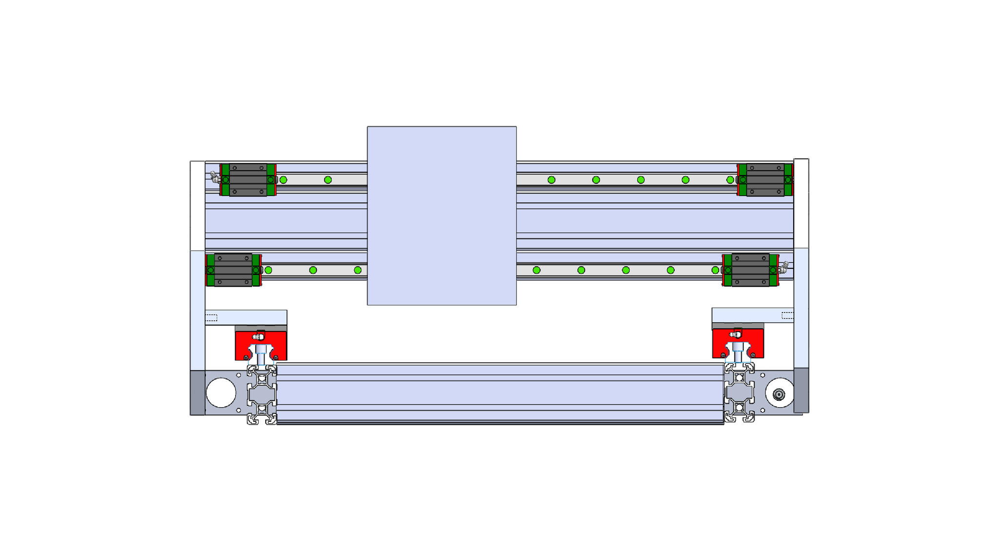

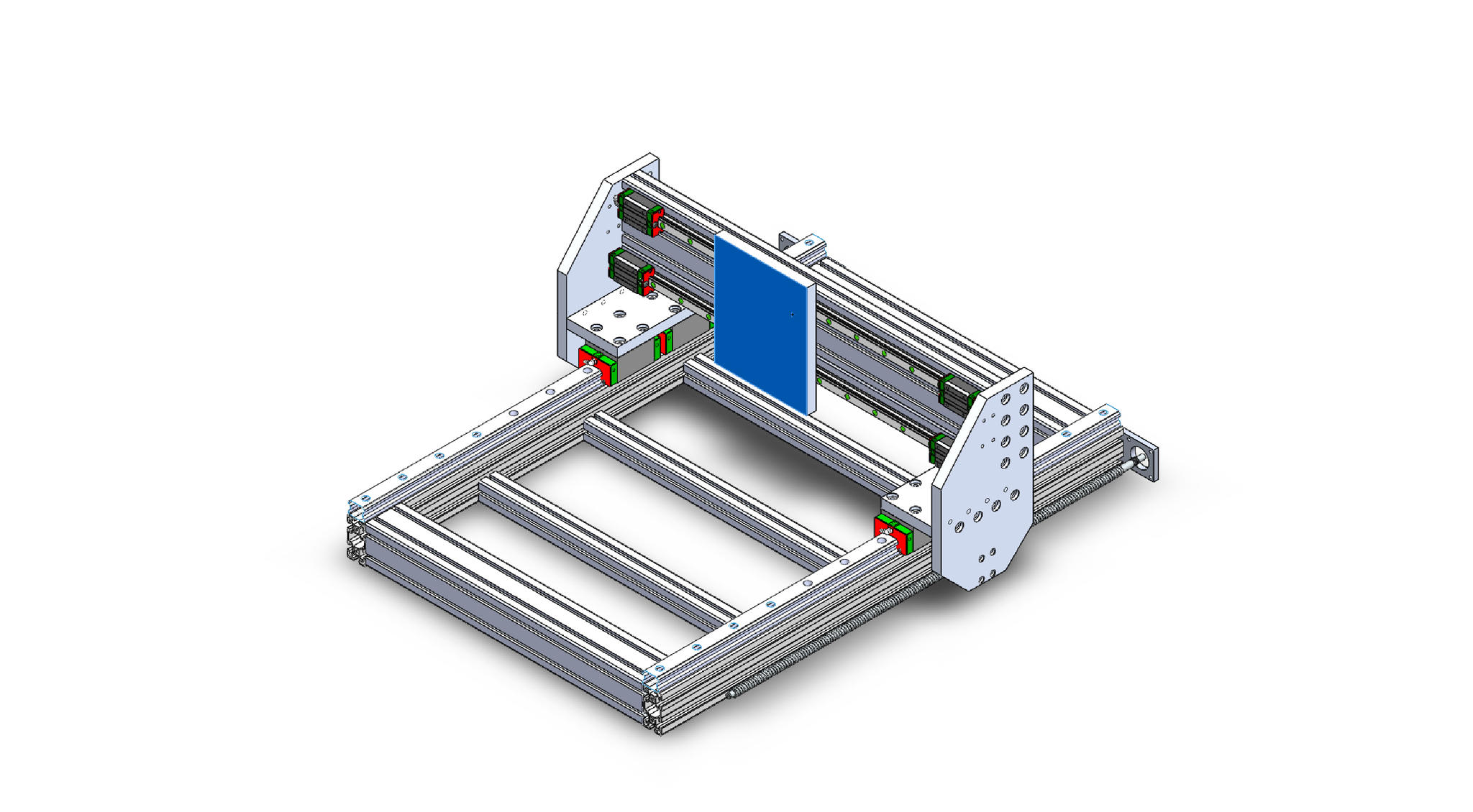

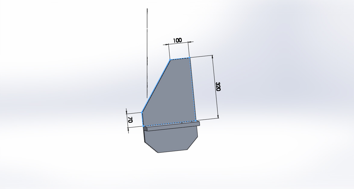

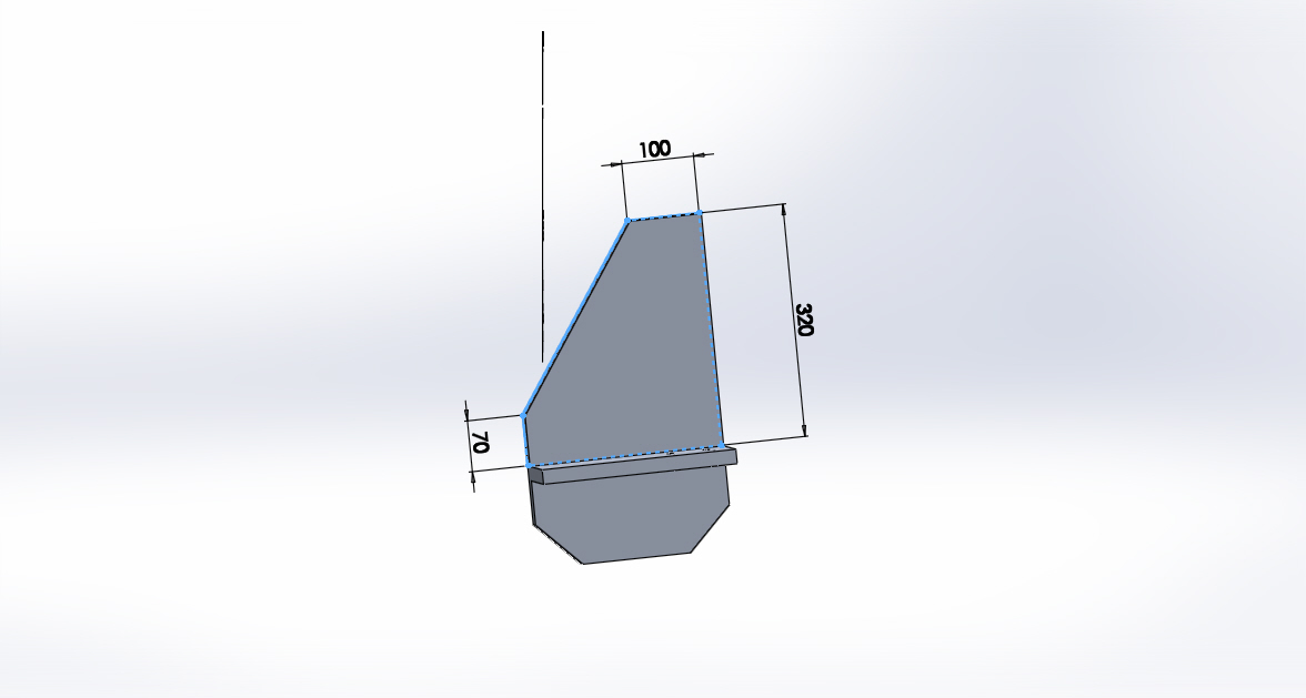

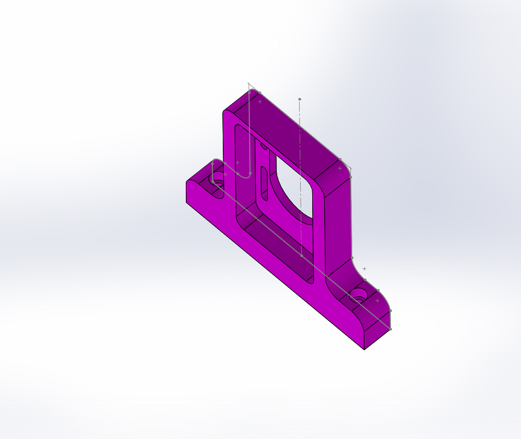

okay great I'll start working on that but if my plate is 20mm thick, the pocket depth would eat up the shaft length, so is it acceptable to have the pocket area maybe 10mm thick only for example?
Printable View
Yes you only need a few mm to mount the motor. ..Clivehttp://www.mycncuk.com/attachment.ph...id=15665&stc=1
As Clive says you only need 2 or 3 mm, I've got about 3mm left for my Z stepper out of the 20mm plate...there's no real force acting on it so it doesn't need to be super strong.
Thanks I think I got it now, here's one of em with 5mm thickness for motor:
http://www.mycncuk.com/attachment.ph...id=15666&stc=1http://www.mycncuk.com/attachment.ph...id=15667&stc=1
Spot on....

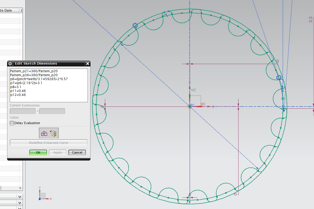

I have never found a pulley separation calculator that got it right. I draw the two PCD's at around the separation I want, add two tangents to connect them as the belt would, trim the circles to those tangents, list the two arcs and one tangent then tally their lengths. Undo until I am back at two circles, tweak the separation and start again until I get it near as makes no difference. If you mount motor and shaft bearing in the same piece of metal you don't actually need any adjustment if your machine is accurate.
Make sure none of the pulley bolts coincide with the belt and if you are really canny you add a fixing for the plastic conduit that protects the motor leads, because that is never in quite the right place if you forget it now :eagerness:

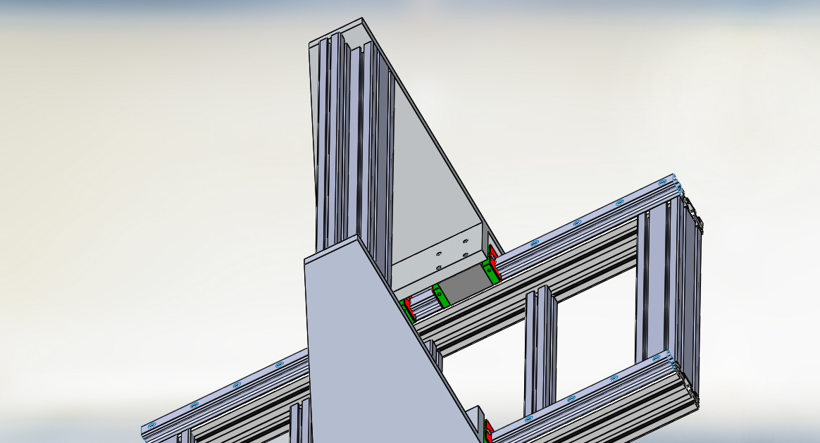

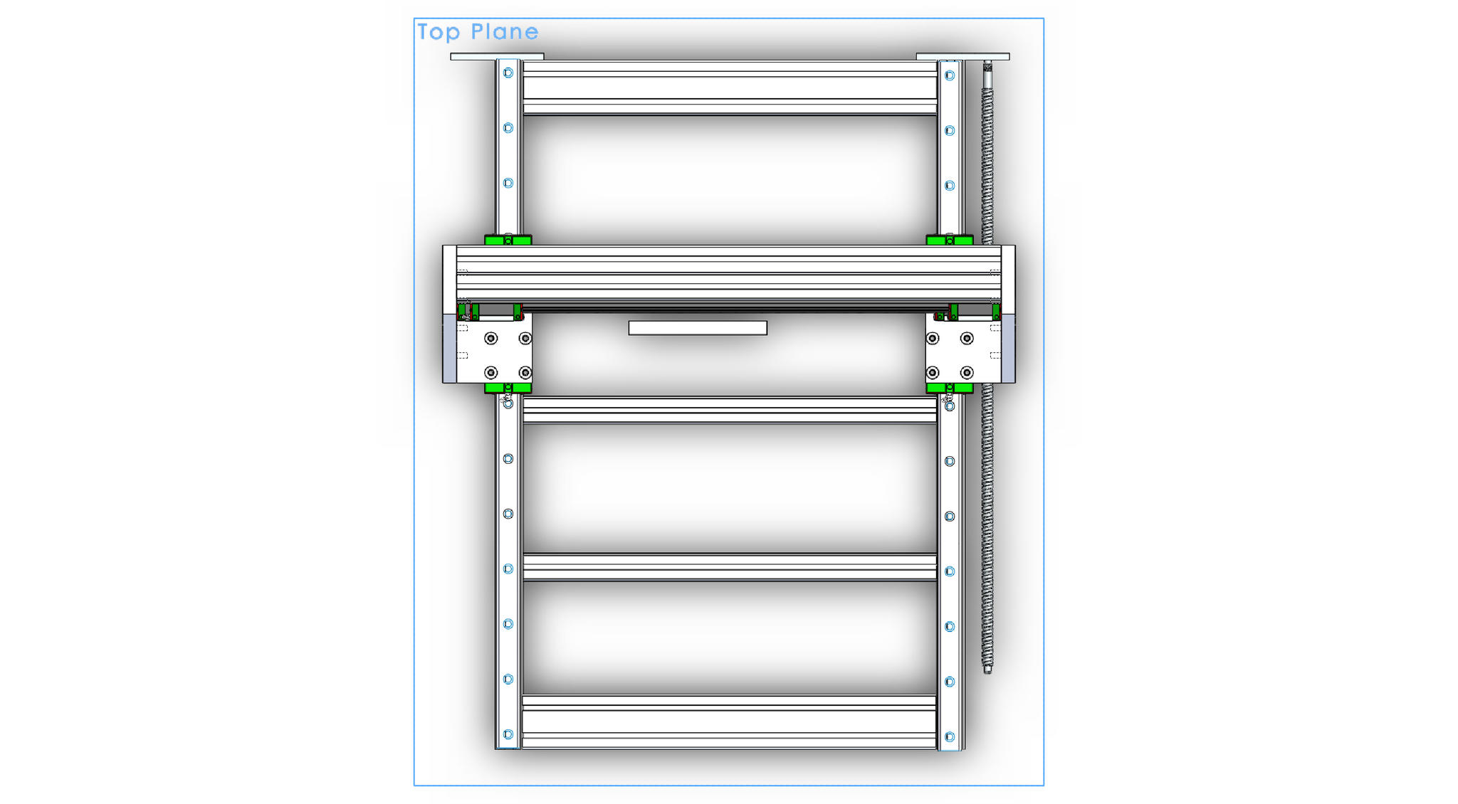

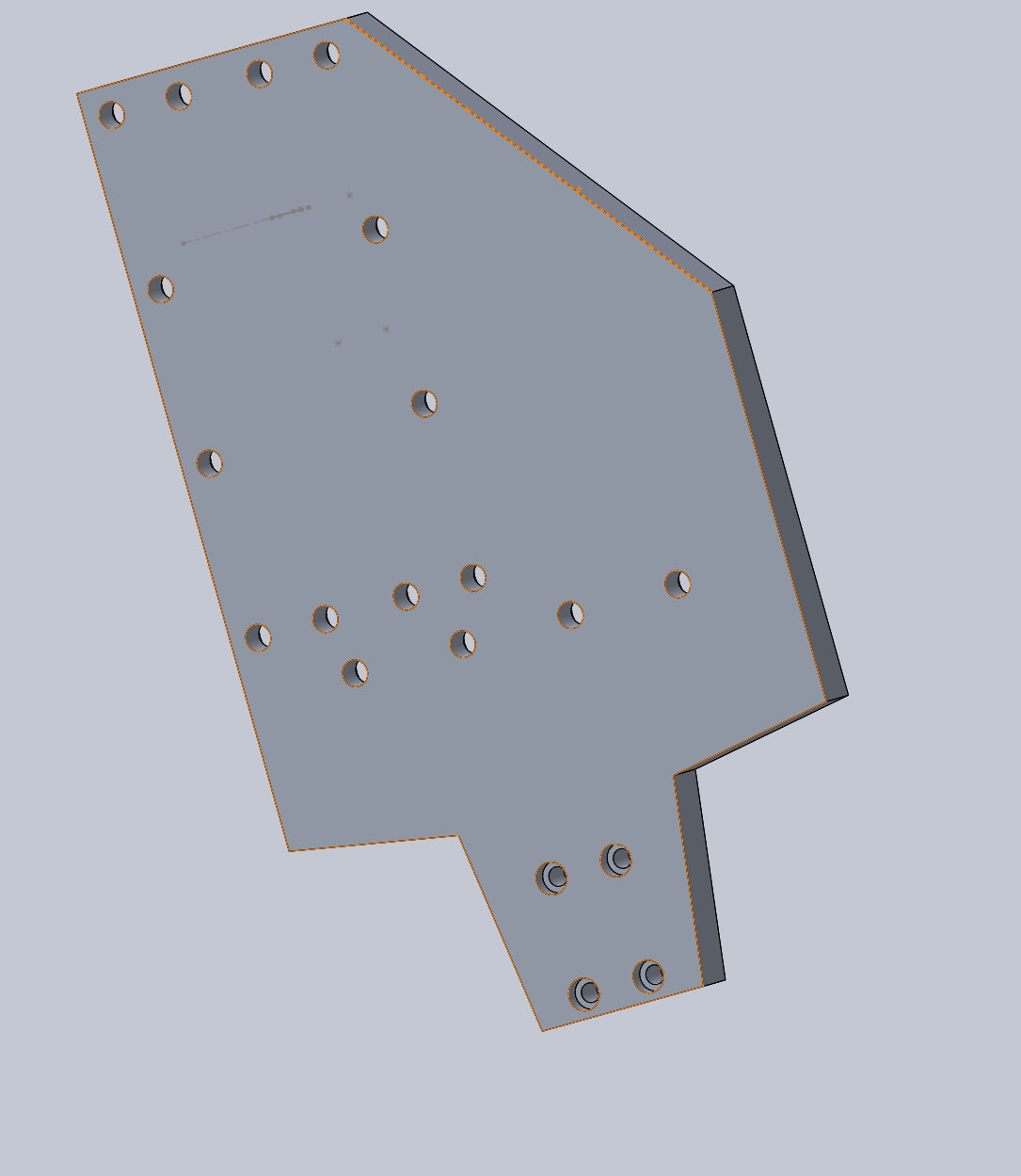

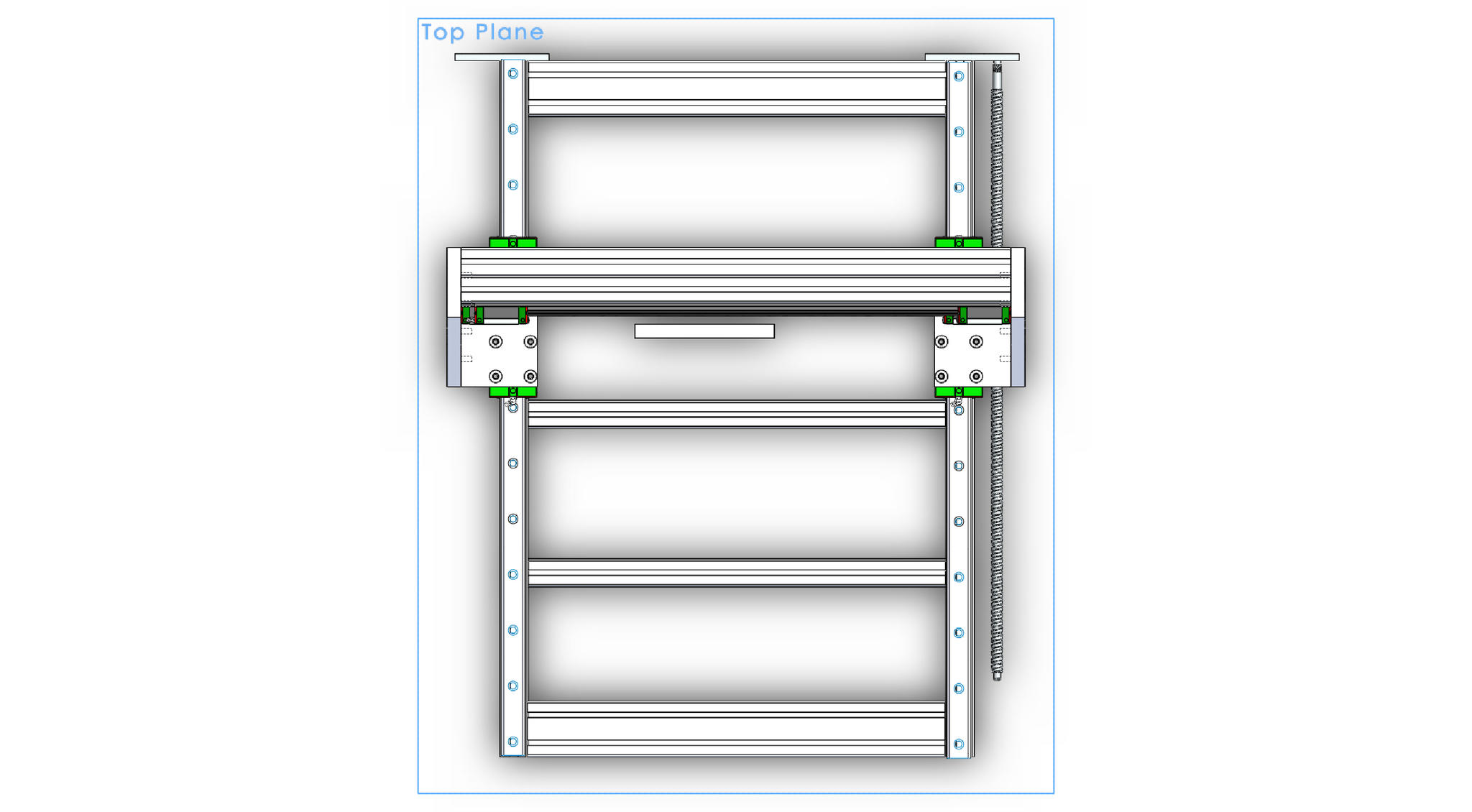

Hey guys, so just encountered an issue which is upsetting but hopefully with your guidance I can fix it. I didn't get a chance to take photos of the machine to show the problem but I'll explain it first now and hopefully post photos later if needed.
so I connected the actual side plates to the X Axis rail and ballscrews:
http://www.mycncuk.com/attachment.ph...id=15668&stc=1
if you notice bottom 4 M5 screw holes are for connecting to the ballscrew nut bracket, this is the same screw you saw in the video, what happens is there is a mismatch between distance of the (4 M5 and 4 upper M8 holes) in the plate and the screw and rail distance so I have to lift the side plate a bit up to match the 4 M8 threaded holes and the when I screw everything fit the ballscrew is forced to strain upwards and causing me jittery movement if going slow along with noise and stalling at the far end side ( tested with drill just like video ) . it is opposite of result in video , very bad hopefully ill capture it but I don't want to repeat putting the sides haha.
so my question, can you just solve this by machining the side plate to have the same slot solution as we discussed for motor plate?
instead of 4 m5 holes ill have a slot of same radius but gives me little tolerance to adjust the height correctly?
hope this is clear, if not I will post a photo of the real thing but the place I have my stuff in has no Air conditioner so I have to plan a shower after it haha.
You can slot holes so that you can have adjustment there's no problem there, of course it's better if they're spot on but once they're tightened up it won't really matter. I cocked up the dimensions on my Z back plate for the lower bearing plate for the Y axis and they're slightly slotted, it's still fine!!
After you have put in the slots and you get it all true you could then drill another hole through and put some dowels in to hold it in position. ..Clive
one of the local workshops made it for me, will test and cross fingers and hopefully no more stress on ballscrews.

This one has it right. Proven a couple of times. Also drawing circles with pulley external dimension / teeth/ as per specs, connecting circles with straight lines at tangential points, deleting unnecessary and using CAD to calculate total length has proven spot on, even for a couple of pulleys where small to none adjustment was necessary.
Sweeeet find Boyan, I couldn't get my head around it all when trying to work this out, this point and click link is great!
.Me
That calculator matches the sheet called "Belt Length" in mine:
http://www.mycncuk.com/threads/5848-...g-belt-lengths
Looks like there's a slightly discrepancy on the sheet where I did it the other way round. Perhaps I should have worked out the formulas myself, not copied the nearest source...It's two circles and two lines, how hard can it be!
I think the problem here is more the tolerances on the pulleys and belts - they're not much, but enough to require a small amount of center distance adjustment to get the correct tension.
Just had a go...
http://www.mycncuk.com/attachment.ph...id=15682&stc=1
Anyone want to check it?
Exactly. There is some small adjustment necessary as pulleys go bigger. So you should include the correct pulley formula in that calculations to begin with.
Here bellow is a screen snip from the parametric pulley i draw. The formulas are correct for any tooth count HTD 5 pulley
http://www.mycncuk.com/attachment.ph...id=15683&stc=1
Just checked, the mess I just posted correctly calculates the total perimiter for what I drew.
Silvaski - your formula there is helpful for drawing the pulley, as it includes the correction (0.57mm) for finding the difference between the pitch diameter and the actual pulley diameter. However for calculating the center distance and belt length, we only need the pitch diameter (D=N*p/pi).
Looking at the javascrip on the website you're using (http://www.product-config.net/catalo...r_functions.js), we can see the following:
Their expression for theta is the same as my alpha.Code:theta = Math.asin((pitchDiameterA - pitchDiameterB) / (2 * englishDesiredCD)); costheta = Math.cos(Math.asin((pitchDiameterA - pitchDiameterB) / (2 * englishDesiredCD)));
desiredBeltLength = 2 * englishDesiredCD * costheta +
Math.PI * (pitchDiameterA + pitchDiameterB) / 2 +
theta * (pitchDiameterA - pitchDiameterB);
For the overall belt length, the 2*CD*costheta is the same as my formula for 2*L, they just used trig not Pythagoras.
The expression pi*(D+d)/2 matches my formula - they've just factorized it and used diameters not radii.
The last item, theta*(D-d), is the extra length to account for the small angle of belt that is used due to the difference in pulley diameters. Again, if you re-arrange my formula then this term falls out. You can see if pulleys are the same size, i.e. d=D, then that part of the equation is zero.
So their formula is identical to what I just derived.
Then they round to the nearest integer teeth belt size and use some crazy looking formula to back-calculate the center distance.
Whatever floats their boat...Code:v = 4 * beltLength - 6.28 * (pitchDiameterA + pitchDiameterB); centerDistance = (v + Math.sqrt(v * v - 32 * (pitchDiameterA - pitchDiameterB) * (pitchDiameterA - pitchDiameterB))) / 16;

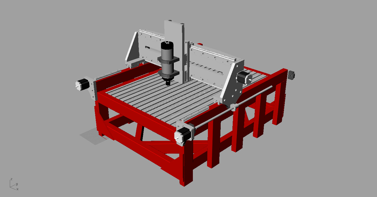

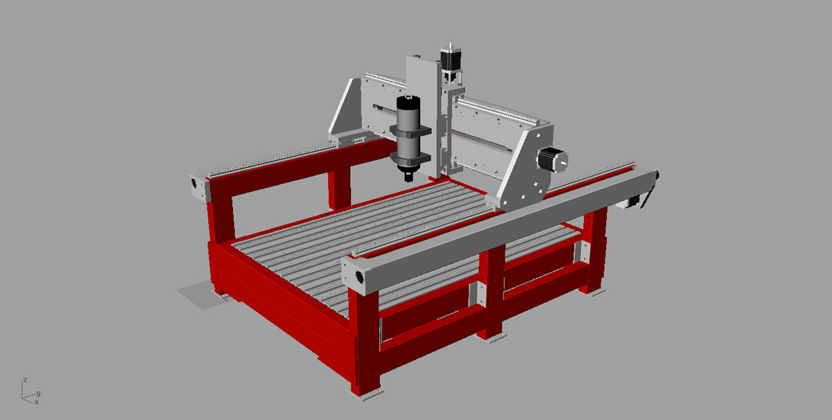

A quick photo of the machine:
http://www.mycncuk.com/attachment.ph...id=15949&stc=1
Video of axis movement , before mounting spindle( at time of this post it is still uploading but give me 20mins or so plz hehe)
https://www.youtube.com/watch?v=sIeMDkg2KVI
am sure u guys might have some comments, particularly on sound of long axis movement, had lots of issues with it being flexing/bending if I tighten the gantry too much or so, the ballscrew ends might need shimming but not sure how to approach it yet.
Your gantry motor belt is looking extremely loose on video.
Just google or youtube - timing belt tension - and you will be expert belt tension operator.
thank you already fixed it but I will have to learn the right procedure as you mentioned.
I tighten belts by making sure I can just about twist (by hand) the bit of belt run furthest from any pulley by about 90 degrees. I know this is also subjective but it should get you somewhere close
