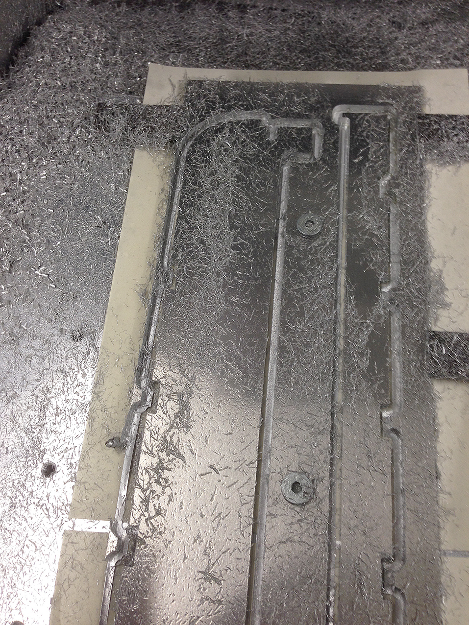

2 Attachment(s)
Re: Questions on using a moving gantry style mini-mill...
Made it's first full-job :)
Yes, I know it's a failed part - i lost a cutter due to it hitting a hold-down bolt caused by my messing with the CAM so much I forgot which file was which :distress: I didn't want to add wasted metal to a wasted cutter so i reset the file and cut the next run over the first one.
Attachment 18069
Onion-skin was perfect, too thick and hard to remove at 0.15mm but i did manage to take the job right through all the post-finish drilling, counter-sinking and fettling just to prove the process.
OK, education time...
Poor quality on the finish passes, 2mm single-flute cutter, 0.6mm DOC, 450mm/min cut, 23,000rpm - chatter I think.
Attachment 18070
How to improve?? It looked better on the roughing cut ;)

Job took 43 minutes including tool-change, mostly the delicate finish cuts, I will look at these a bit more as something is off a little there I think.
Any pointers?
On the next run I'm going to take the skin down by 0.05mm and also put a sheet of paper or card under so I take the fine detail - holes and slots, down to 100% depth.

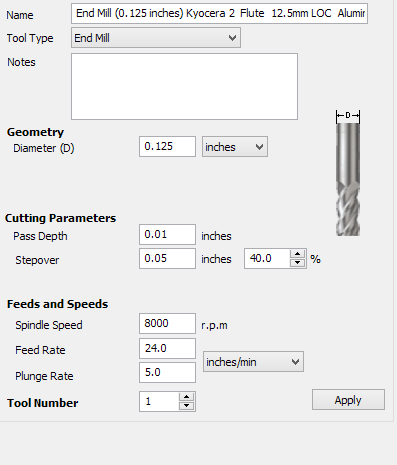

The pointers: i said it many times, and most disagreed. For perfect aluminum finish if the machine is normal, that combo gives me the best finish. I don't care about 12k rpm or 30 krpm. That combo for 3mm bits gives me best finish. On the yellow machine i could cut at 12krpm and 2500mm min at 1mm deep with 1/4 bit. But best perfect finish is around 600mm min/ hence 25 ipm/
Attachment 18071
Those settings are not far off where i was, I was a little slower feed and faster rpm, that may make a difference, don't forget there is a fair bit difference between a 1/8" and 2mm tool.

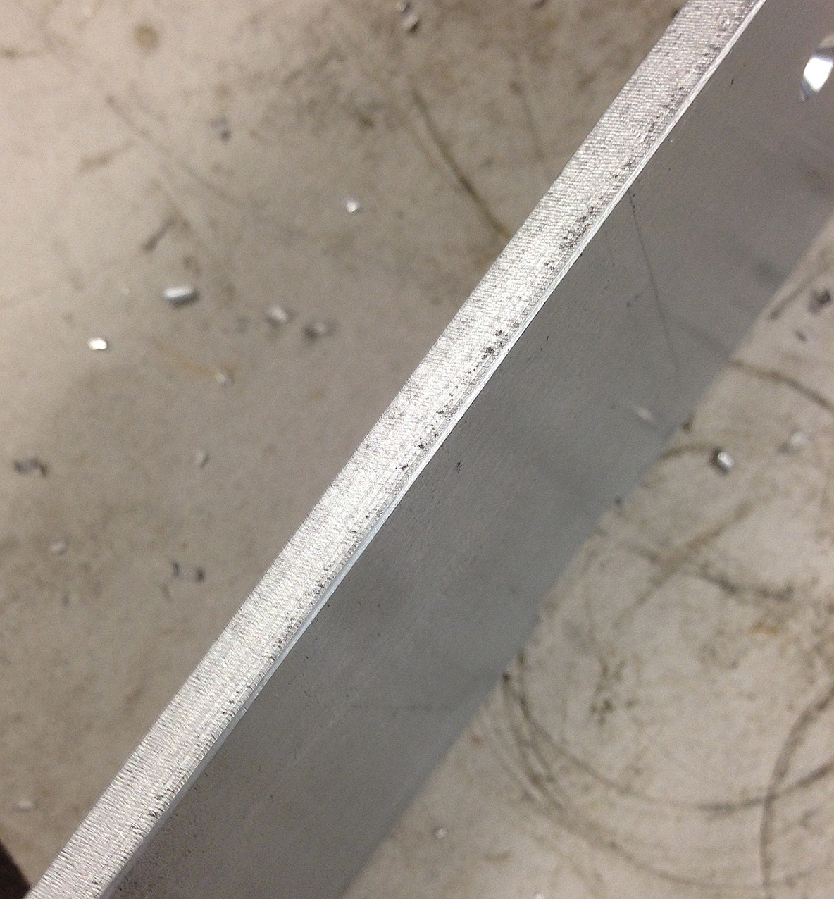

On the finish pass question - I don't often use small cutters so don't know what the problem is. But 0.6mm DOC seems small for the finish pass ?
I generally use 6mm cutters and for finishing I leave 0.1mm roughing on the part - how much are you leaving?. Then I cut at 3mm DOC as this works well but I could probably do anything up to 10mm DOC as you're hardly removing any material on the finish.
Here is the finish on a 10mm part using this method:
Attachment 18072
I left 0.1mm from the roughing pass.
The 2mm cutters are spec'd to 3mm DOC but I still have concerns where they hit the rads from the 5mm tool and also have to plough into the corners a bit to create the sharp internals. Maybe my option 2 above would work?

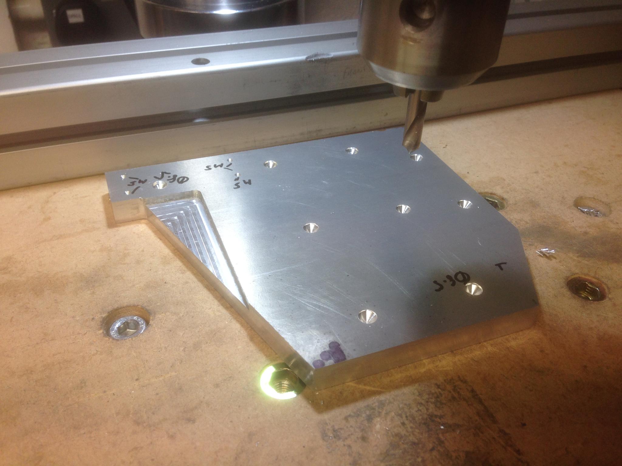

The machine made it's first saleable parts today :)
I did sacrifice two 2mm cutters, here's how...

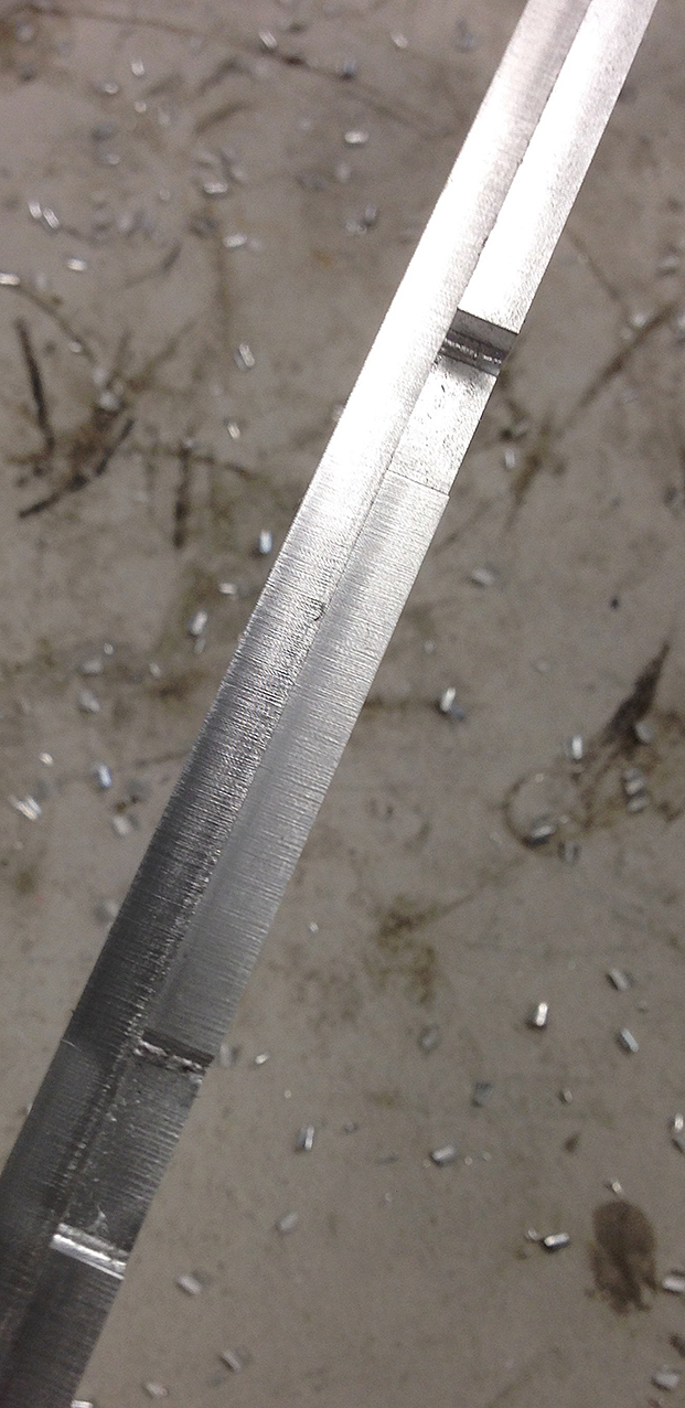

On the part in the OP, there is a little square notch, first from the left along the top edge, it's about 4mm square and as such was not roughed out by the 5mm tool on the first pass. I set the code for a 2.5mm deep cut on the finishing pass with the 2mm tool and added a reduction to feed with CAM rules, it worked nicely until the tool reached that notch when it died.
I then increased the before and after feed change in CAM so the rate slowed well before and after the notch - ping went another tool. I then reverted back to 0.6mm per pass and 450mm/min rate as before and it sailed through. Still got that slightly poor surface finish though.
So, it seems despite what HSM says, even on severely reduced settings, you cannot slot 2.5mm deep with a 2mm tool.

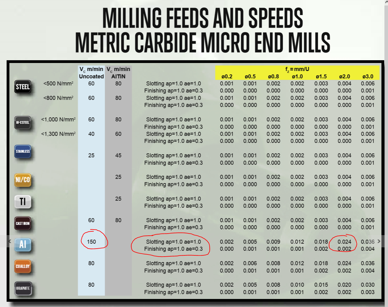

2 Attachment(s)
Attachment 18088
Attachment 18089

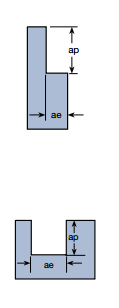

This is Kyocera carbide micro bits feed and speed chart. They are definitely one of the sharpest and overall best bits around. So if you are using inferior -30% at least on all data.
Vc - cutting speed
f - chip load or feed per tooth
Fr- feed rate mm/min
D- diameter of carbide bit
U- number of teeth on cutter
p=3.14
Ae - side removal
Ap - face removal
1.
determine spindle speed rpm/min depending an operation/roughing, slotting, finishing/
RPM=(Vc*1000)/(p*D)
so
RPM=(150*1000)/(3.14*2)=~24k RPM, so you are spot on here
2.
Calculate feed rate mm/min:
Fr=f*U*RPM
so
Fr =0.024*2*24000=1152mm/min for slotting
=0.002*2*24000=96mm/min for finishing
That all on a mill with very good cooling and chip removal. Diameter depth and 30% tool engagement
So if you play with the second formula you could easily see why you can no make a nice finishing pass. cause for 800mm/min feed you will need to have the spindle at 8000rpm, not 24000.
Now lower some percent that you ar not cutting on a mill with jet cooling the bit...
And bear in mind that the first speed calc is most probably for roughing bit, because that's how typically is done, that's why seems so fast.
From my experience there is no big science here, i have tested cuts on various machines and the only thing that really differs is the depth of cut that could be achieved with a particular machine.
Thanks Boyan, all I do is plug the manufacturers cutter specs into HSM Advisor, set the cut details and move the feed rate to 30%.
I was not feeding at 800mm/min, don't forget my tools are only single flute.
The cut is a tricky one though as the corners are more like slotting and the rest is plain finishing so a mix of heavy and light cuts.
If my understanding is better, after a good chat with the guy that supports HSM Advisor, it seems I might be a bit over zealous with the settings?
Plugging numbers again, I get for the 2mm tool, 18,500 rpm, 1,200 mm/min feed, 0.5mm DOC and 0.065mm/t chip load.
Reasoning - the limiting factors are the larger rads in the sharpened corners - this becomes slotting - also the manufacturers chip load limit of 0.065mm/t was set to not be exceeded, that gave DOC as 0.506mm as part of a balanced result to meet those factors.
So my earlier run was 0.6mm - too deep, 23,000rpm - to fast, 450mm/min - too slow. It survived but took a long time and gave poor surface finish.
The tool cannot give a 2.5mm DOC with any setting due to the slotting factor - the tool exceeds 100% torque limits = snapping - this backs up what really happened when i tried it.
So it seems lighter, faster is a way forwards, might risk a tool and try it I think. Its more passes but travelling at 3 x the speed so should still be quicker.

2 Attachment(s)
The 5mm cutter runs cleaner at 18000rpm and 1000mm/min. :)
Edge finish...
Attachment 18107
Nice pile of swarf...
Attachment 18106
I had the onion-skin set a little too tight and had to hold the parts in for part of the finish cut but that's easily fixed.

2 Jobs tested and in production :) 2nd one much less stress ;)
2010 screen-set, tool change routine...
On this job I did exactly the same as before but the first cutter seems to have run about 0.2mm lower than it should, made a bit more mess out of my bed but i'm not worried about that as it's buggered anyway ;)
The next two tool changes worked perfectly and did not gouge the bed.
Anything that can cause this?
I have verified the code and all parts are cut to the same depth.
Human error or the tool slipped in the collet
Vaguely possible but why only slip 0.2mm and not just keep going as usual?
The second and third tools were spot-on which indicates the initial height sense was good, i think.
If it did slip the torque from cutting and centrifual forces or heat generated in the tool could have locked it tight again.
