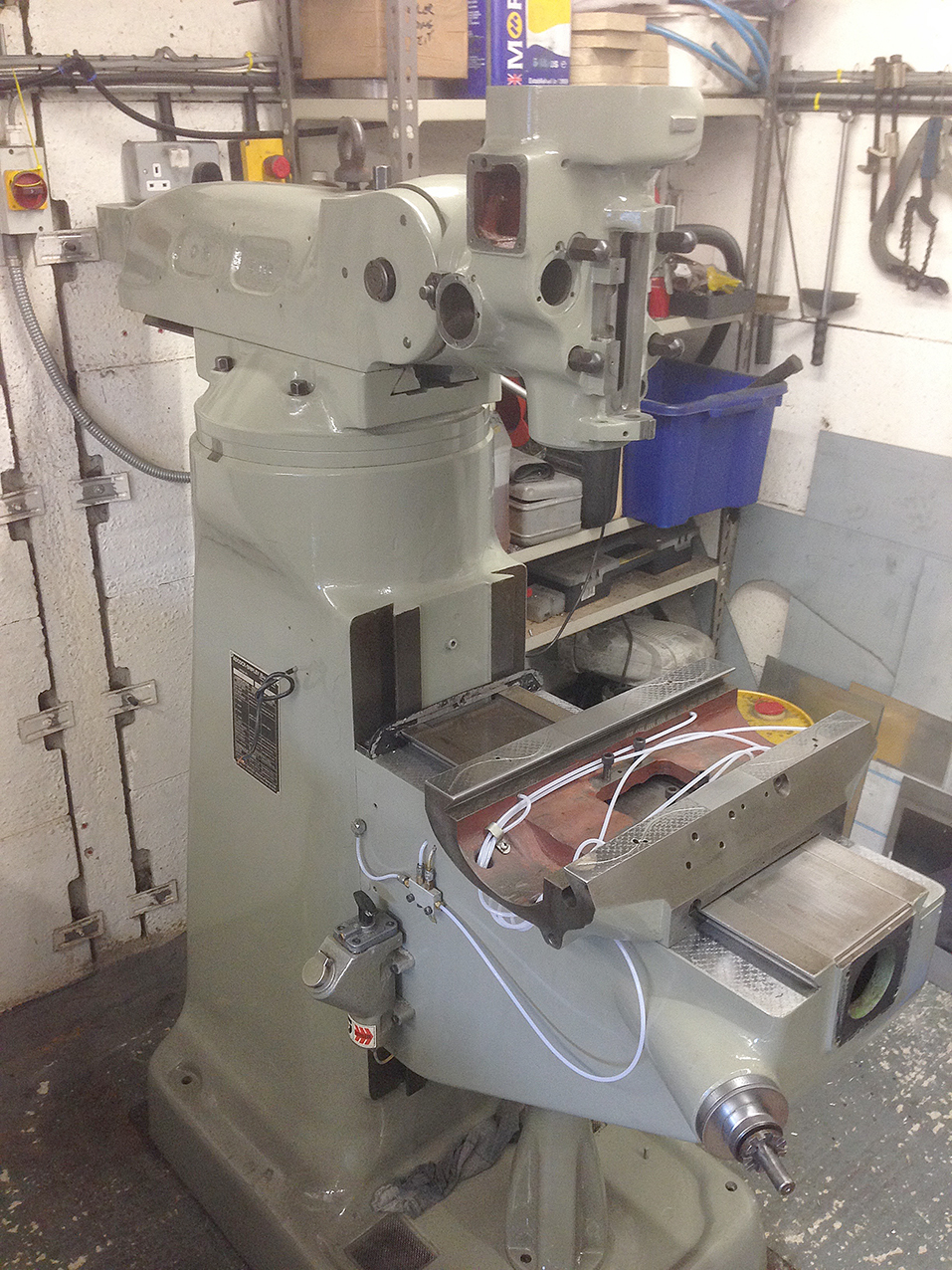

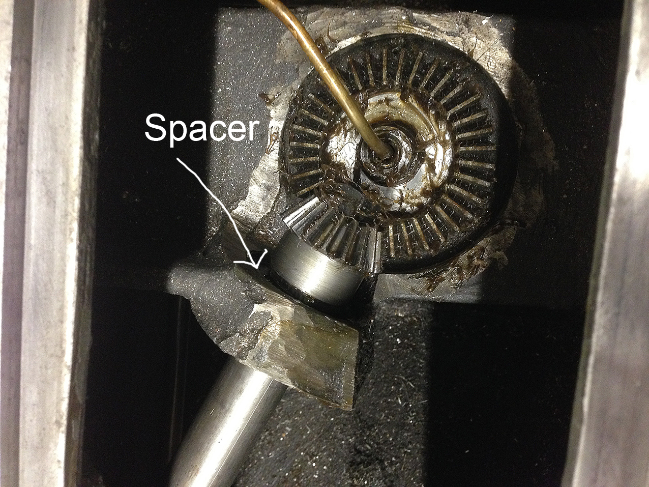

Got the ram and knuckle on this morning, also stripped and painted the saddle and head.
Attachment 18561
Also fitted a spacer here as the gear mesh was terrible, way too wide. For the first time in all the years i've owned her, the knee now glides up and down silently

Looking lovely Dave, looks so much nicer cleaned up and painted, should turn out to be a nice conversion/restoration.
