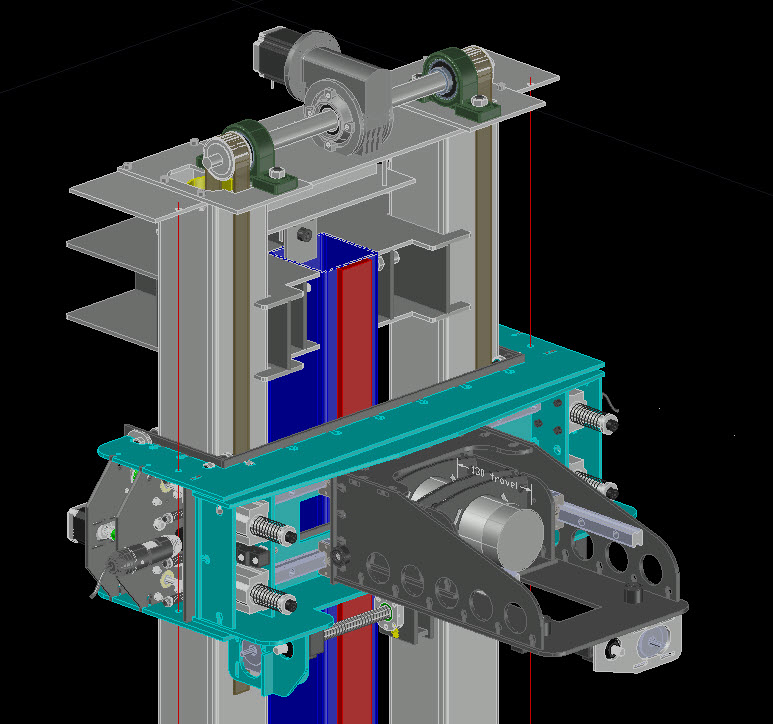

I have upgraded the files stored on GrabCad to version 35. https://grabcad.com/library/machine-...linear-rails-1
This is a major update many of the laser cut joints have been placed.
It provides a good example of the possibilities made possible by laser cutting.
Attachment 29458

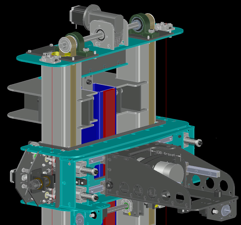

The model is coming along nicely, Nearly build able at his stage. Next step is to sort out the computer interface.
Attachment 29550
The files have been uploaded to Grabcad
