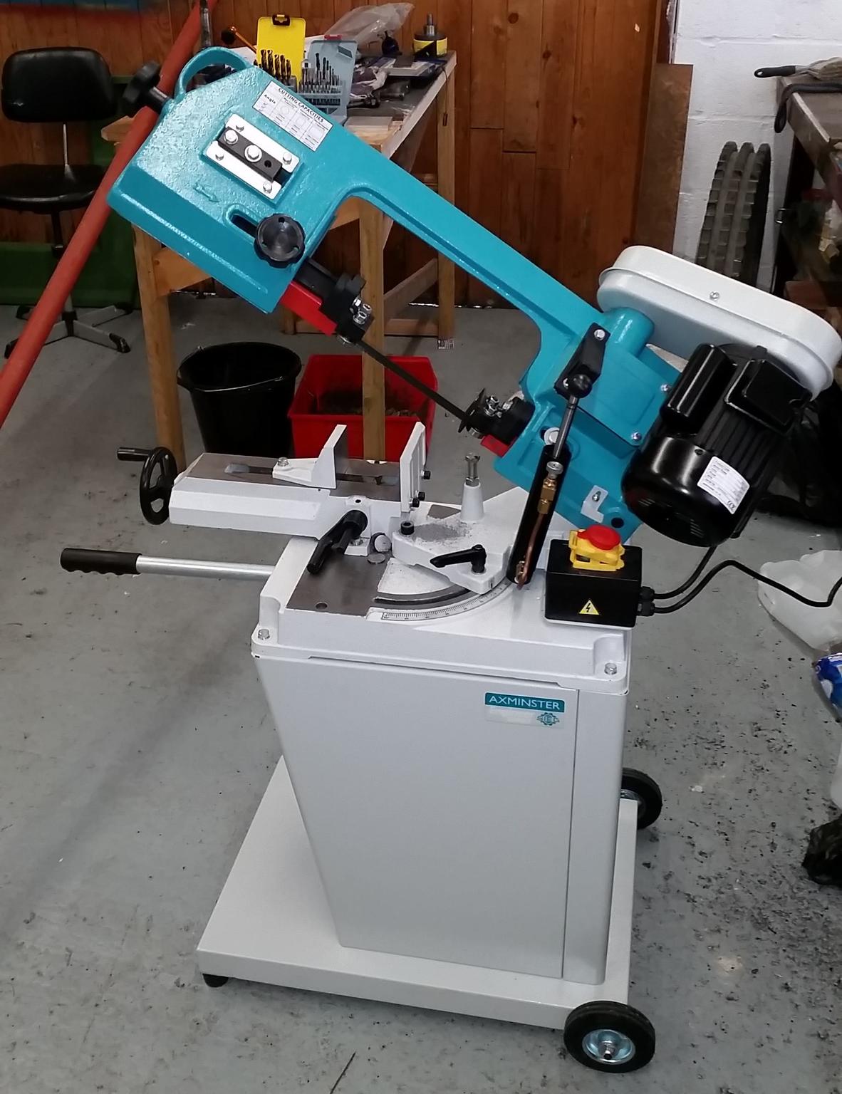

Not done anything on this since the last update but have been specifying a Nema34 and 240V driver for the router along with the pulleys etc needed. Just bought for work an Axminster horizontal band saw http://www.axminster.co.uk/axminster...utting-bandsaw which seems to work OK.
Attachment 13667
Gradually adding tools for making all sorts of stuff. I've got my small ARC welder and Pillar drill at work too so getting quite a nice little workshop together. only thing that would be better was if it was at my house instead of work but I do have access any time I like.
Tool collector or tool user ? that's the question. :joker:

That's the same saw as I have - they've just changed the colour scheme. Once I got the blade adjusted properly (i.e. not prone to fall off at awkward moments) it cuts well - nice and square.

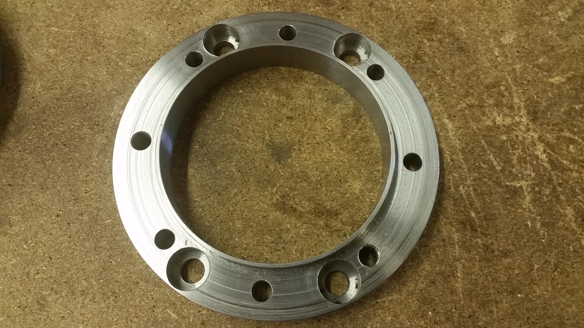

Using them for work... :wink: making spacer rings for some of our products, making jigs and fixtures for pressing in and out bearings etc.
Attachment 13668
Soon hope to be using them on the router (and mill conversion) but it keeps getting put back as more and more "one offs" keep coming in that I need to modify/make....not complaining as I'm being paid to play with the tools which makes a change from sitting at a desk all day long!!
