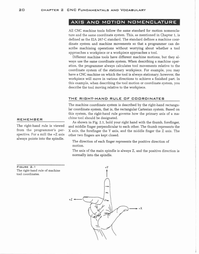

When you are in front of the machine X is left right, Y and A are the long axis. Its called "the right hand rule"
Attachment 21617
