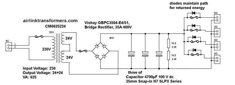

Re: 60-70v unregulated power supply recommendations
you can have fuses in the DC suppy wiring to stepper drivers provided you have diodes wired across the fuse holder to maintain the path for the returned energy
Attachment 22087
John
PS
the Gecko G540 has an internal 10A fuse in the positive supply line !
Hi Lee
Clive is correct , when a fuse blows the diode will only conduct
while the motor is generating a higher voltage than the power supplies output
just because its what I have in my spares box I would use
a 1N5408 - 1000V PIV 3A diode
( I think I used them to rectify the 250V mains )
with a 70 to 80V DC power supply a 1N5401 - PIV 100V 3A diode would be OK
John

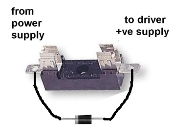

How would you implement this in practice? Solder the diode across the ferrules on the cartridge (I think it would fit back into the holder)?
Hi Joe
I would solder the diode across the fuseholders terminals
Attachment 22089
John
