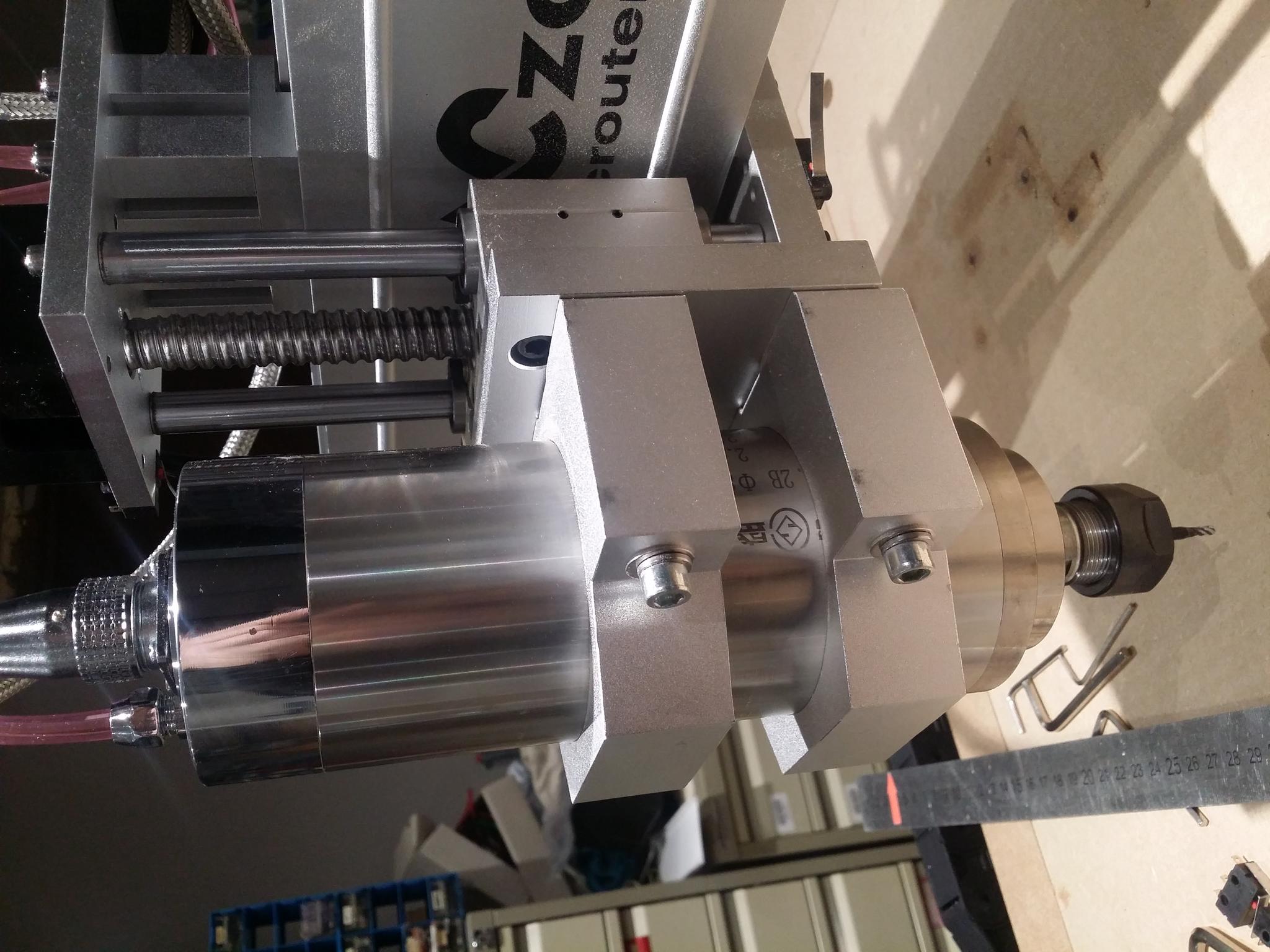

		2 Attachment(s)
		Re: My new 6040 improvement plan.
		The first and easiest (and free) change is to the Z-axis assembly.
On this model, a 35mm spacer block has been added on top of the top bearing, increasing the Z axis length/travel by 35mm.
The way it's been built, I can very easily remove it and instead, mount it under the bottom bearing. The entire Z axis will be moved 35mm closer to the bed, but I can recover exactly that much by raising my spindle in the mount. I couldn't do that before as my tools wouldn't reach.
This will shorten the length of the "see-saw" motion, so in effect, the spindle tool will not move as far.
I'll measure deflection properly both before and after the modification.
Here a picture of the spindle and the 35mm spacer block.
Attachment 23408
Attachment 23409
		If you're going to do what I think you are, it won't have any effect on the X-axis deflection. The pivot point (the rails), and the spindle/tool, will still be in the exact same positions relative to each other.
It will make a difference to the Z deflection, however I'm not convinced it will be that great. The Z-axis, although using unsupported rails, is quite a compact and stiff assembly. Although changing things around will reduce the pivot distance between tool and Z-rails, I wouldn't expect it to flex that much anyway. Certainly not much in relation to the flex of the X-axis.

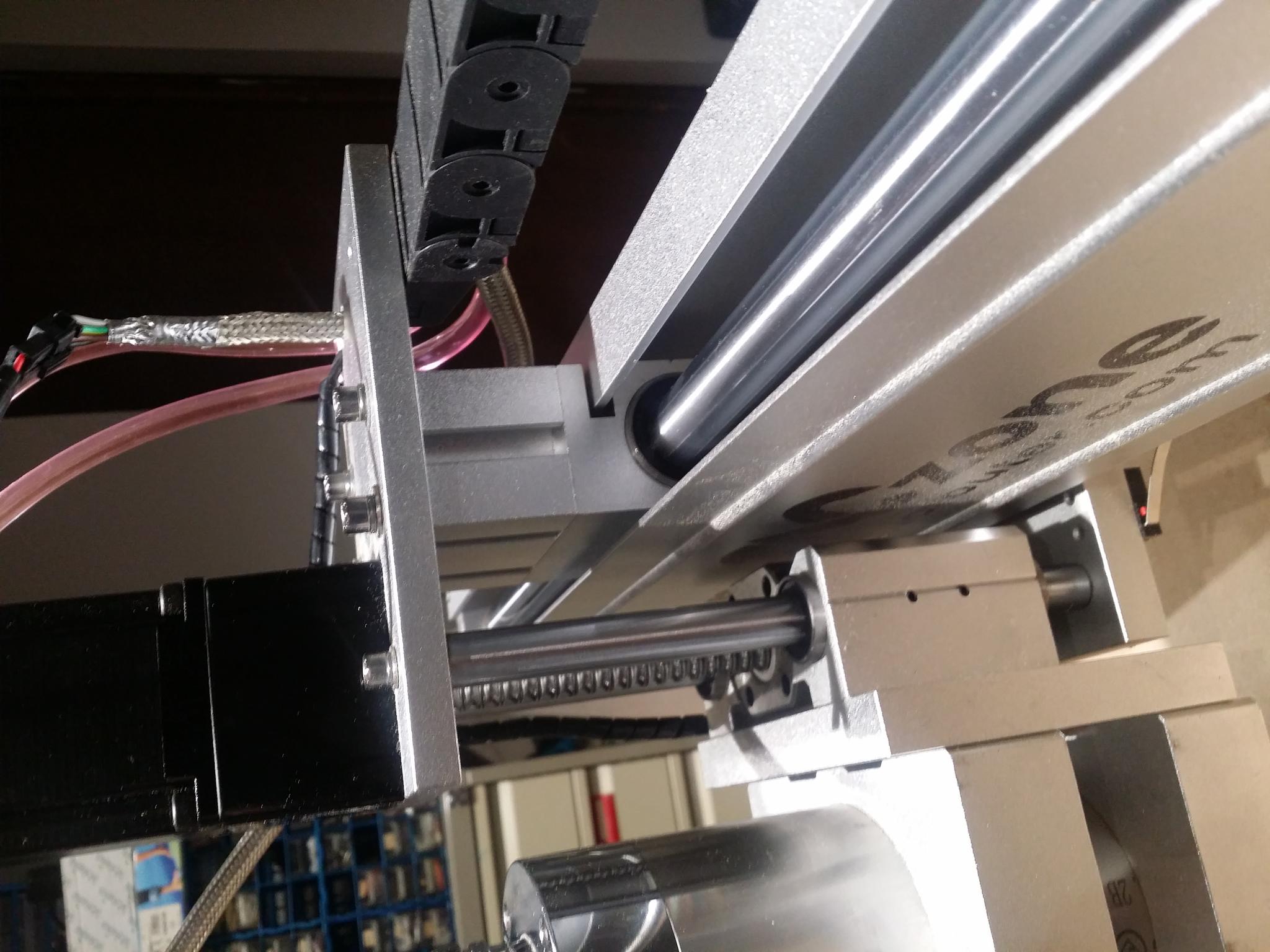

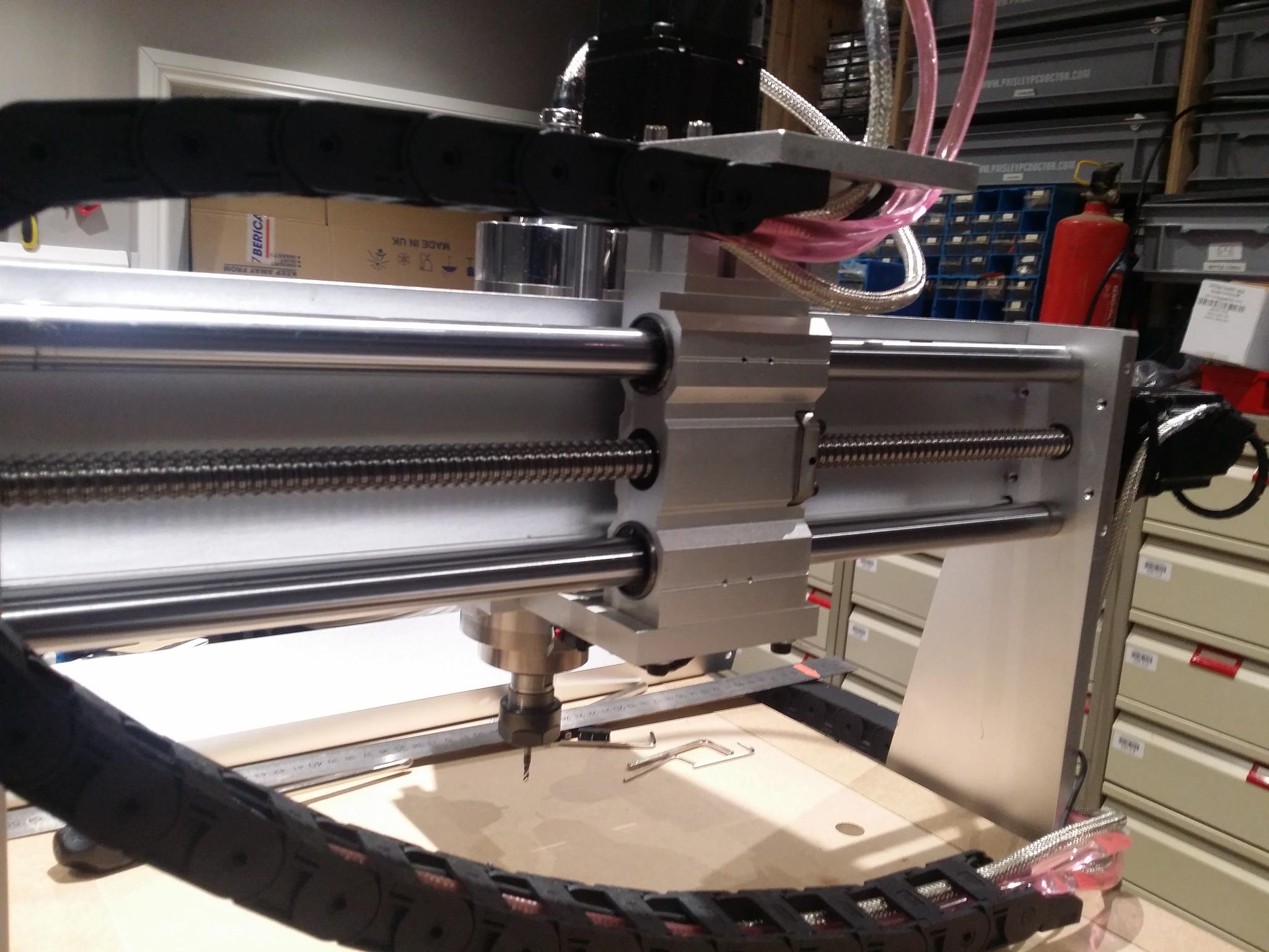

			My next area that I'm going to look at is the flexing of the unsupported x-axis 20mm linear bearing shafts.
 Give us a pic.
		2 Attachment(s)
		Here are pictures of the y axis assembly. Excessive flex in x axis direction.
Attachment 23421
Attachment 23422
