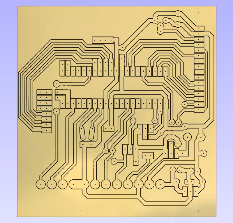

I wish someone had told me how hard it was to do circuit boards before I ran the last batch of 20 off this weekend without any glitches.
Yeah, that happened to me when I first started pcb milling too .....but next I had to make a pcb with something more than just two very large through hole components on it!

Attachment 5474
That's about 80 x 80 mm.

That's a large track width, all through hole and no tracks between the pins - I'd have been amazed if anyone had problems with that. A lot of SMT IC's have a quarter the pin spacing of DIL, which is when it gets more difficult.
If it's a circuit which is running at relatively high frequencies I do engrave it in the 'normal' way or etch it.
I cut plenty of PCBs on the Roland PNC2300A (same as one John S has) at school with a V-cutter. It's a very weak machine, yet did what I needed at the time (up to SOIC). So you don't need a massively rigid machine for PCBs, since the cutting force is minuscule, however if you're happy with the travel on the table and expect to use it for other things then clearly rigidity is good.

Curiously enough I've spent two weeks trying to coax 0.4mm tracks and 0.3mm isolation out of my little X1 - quite the experience for the reasons mentioned previously in this thread. I agree with the statement, if the machine is going to do the drilling it may as well do the milling, especially for double sided boards, and wanted to see if the X1 could hold the resolution before I spent any real money or even bought a 'real' CNC machine.
The results are looking quite promising atm, I think the next issue to address is spindle speed - 2,000 rpm does not make for a happy experience. I'm reluctant to add any additional weight to the X1's already over stretched arrangement but I reckon I can drop a 50mm spindle directly into the existing spindle hole. This looked just the job, ESX16 collet, 28,000rpm http://www.ebay.co.uk/itm/2307559193...84.m1423.l2649 but worried about its age and condition I was out bid :( If any of you fine gentlemen know of a suitable substitute I'd be most grateful.

... Oh, John, when they asked for a PCB with a bus I don't think they meant the #47 to New Street Road End ;) Joking aside, nice board John, smooth, good definition and more consistent isolation than I've managed to date.
