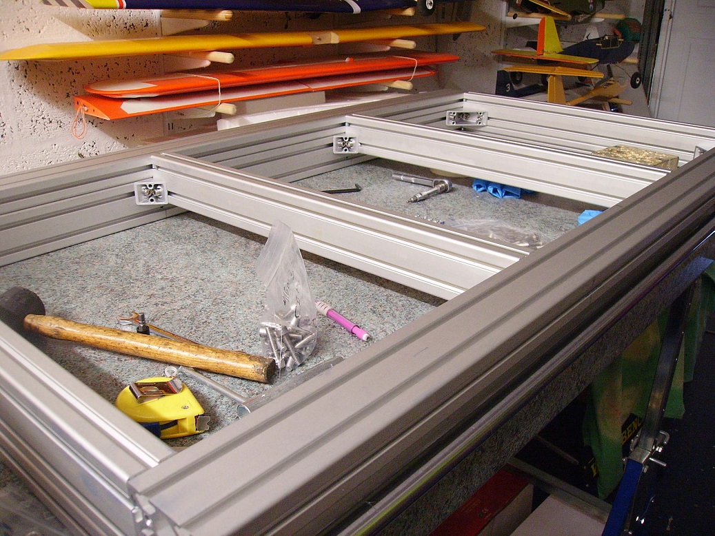

		6 Attachment(s)
		Re: Let The Fun Begain, New build on the Table.
		Ok here is another part done I had to cut 3mm off the aluminium plate, as they came to large. Now the only way I could cut the 3mm off was with a hand held router and a M6 end mill with the plate held in a wooden jig. That was hard going. Anyway with stops to rest I did start to assemble the bed.
Attachment 8975Attachment 8976Attachment 8977Attachment 8978Attachment 8979Attachment 8980
		Bit late now but a chop saw would have been a good investment for you if you have problems using a hacksaw.
With the right blade you could have cut all the aluminium both plate & profile yourself which would have made things a bit easier, plus it would also be handy for cutting aluminium to size before machining it once the router is up & running.
