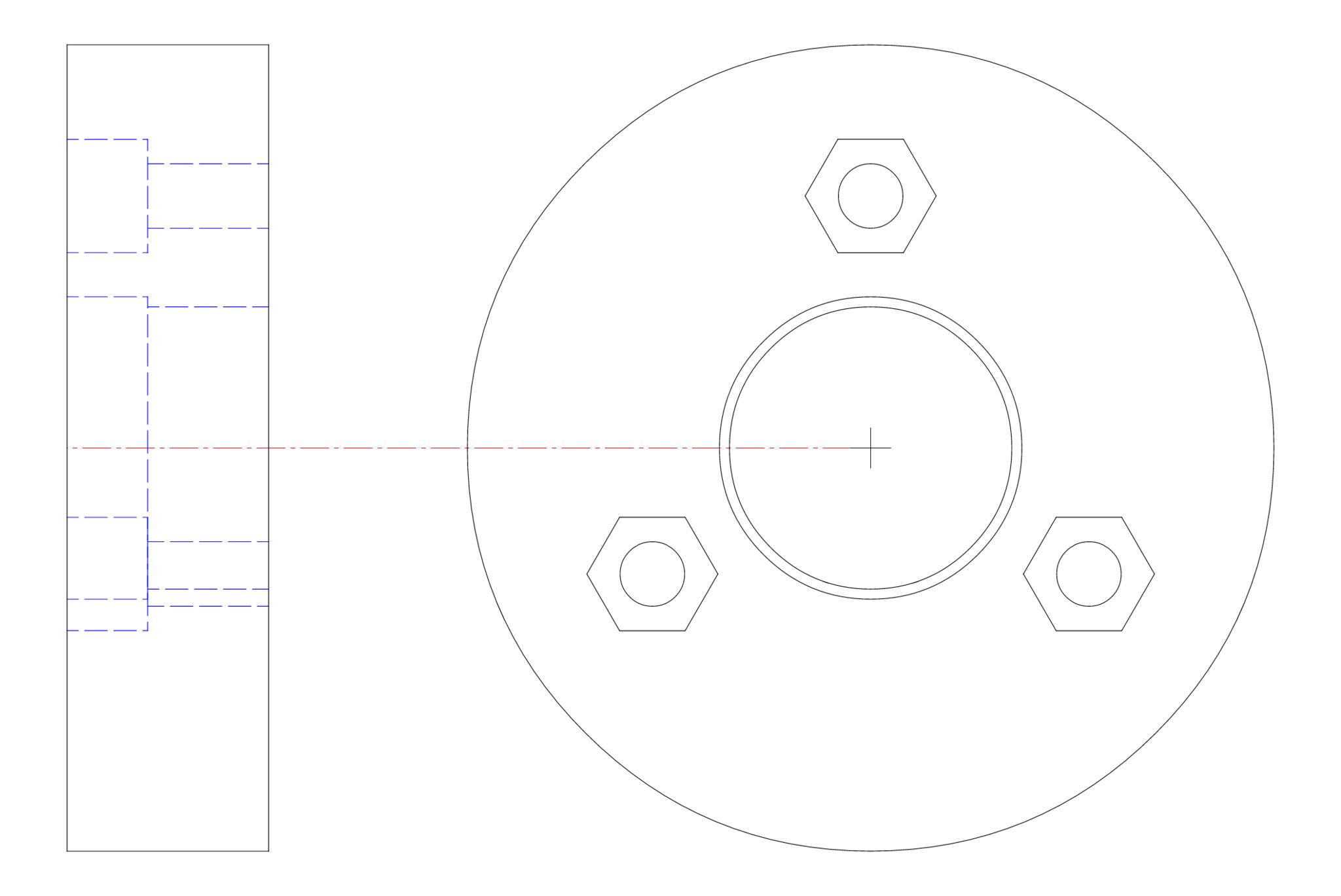

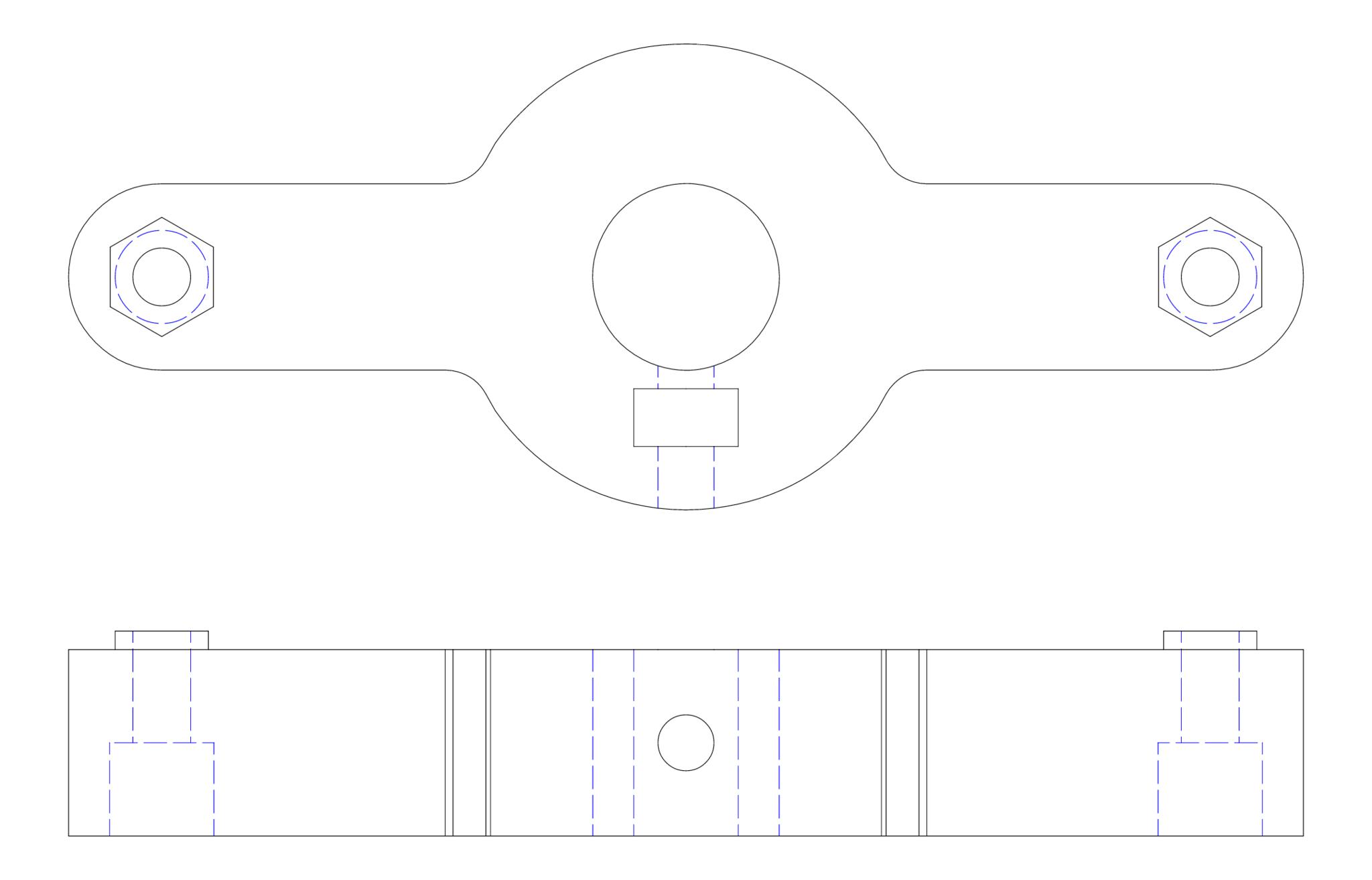

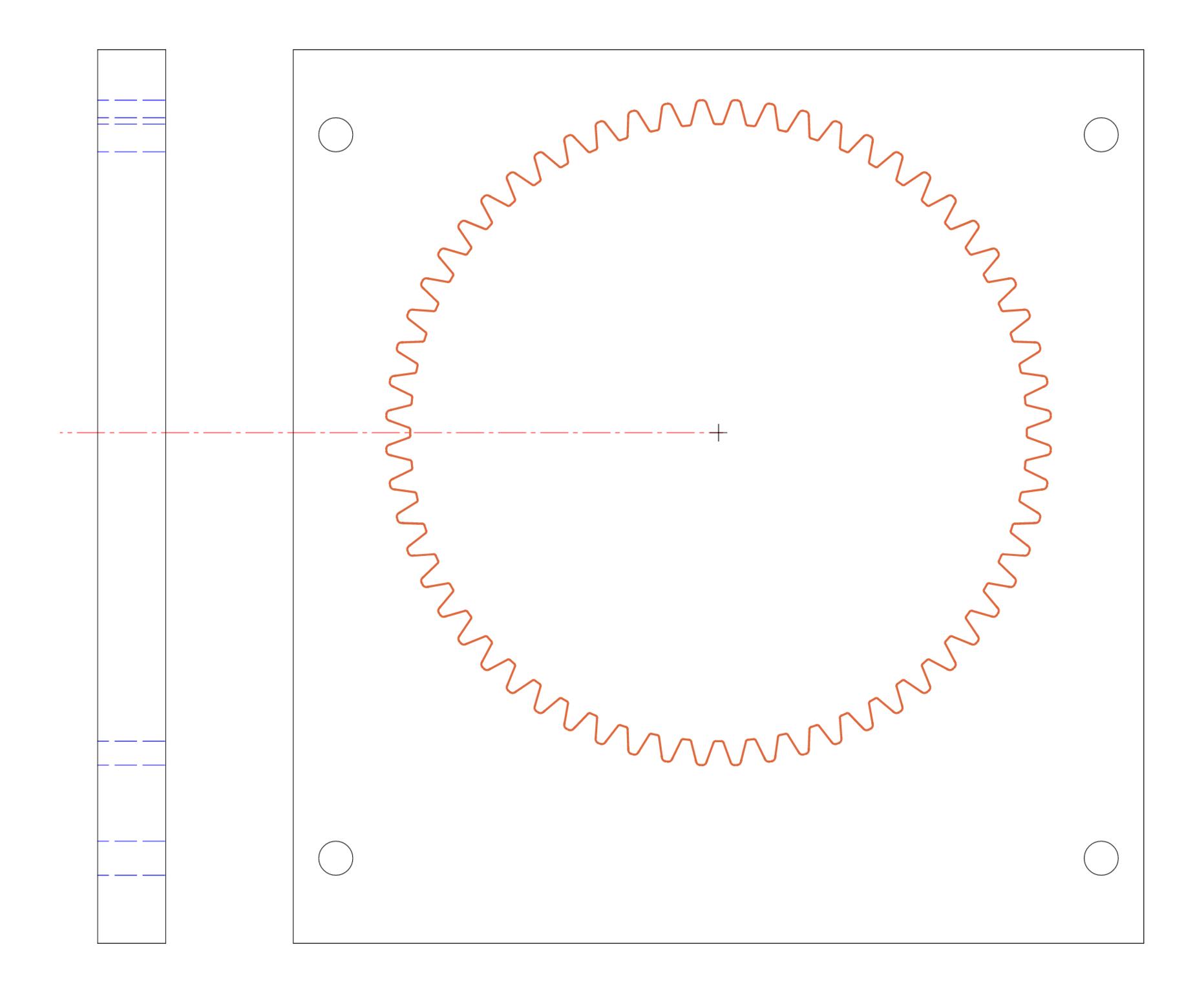

OK. Attached are image and DXF file for the 3D printable modded sun gear and rotor boss which now include a seat for a 15 x 10 x 4 magneto bearing. these go either side of the rotor and are joined by 25mm M3 cap headed bolts and captive nyloc nuts. Are these printable?
Crudely each contains 1.25e-5 cubic metres of material, which means 0.02kg of PLA
