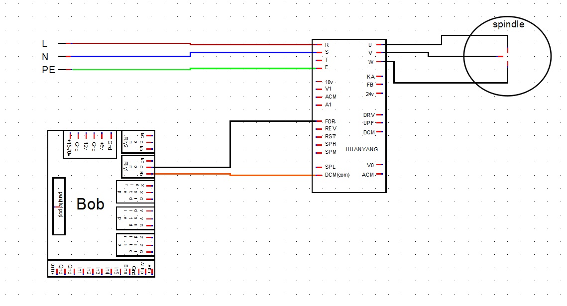

OK guys, just finished my electric installation, got all the wires connected, everything seems to work, except FVD, nothing happens when power is applied. So my question is, am I doing something wrong or do I have faulty FVD?
I connected mains to FVD like this: http://www.mycncuk.com/attachment.ph...5&d=1381658518
but did not connect spindle yet. I would think that it should power up (at least LED showing power or something) even if spindle is not connected.
My FVD and spindle: http://www.ebay.com/itm/250952872638...84.m1439.l2649
Any comments will be much appreciated!
Have you checked to see if you have mains voltage at the terminal in the VFD? With a meter or test lamp. (be careful) ..Clive
I could be wrong but isn't there a system on these that stop it coming on if there is no spindle attached, i'm sure I read somewhere that you shouldn't power them on with no spindle connected as it can damage them, I could have my wires crossed however.
