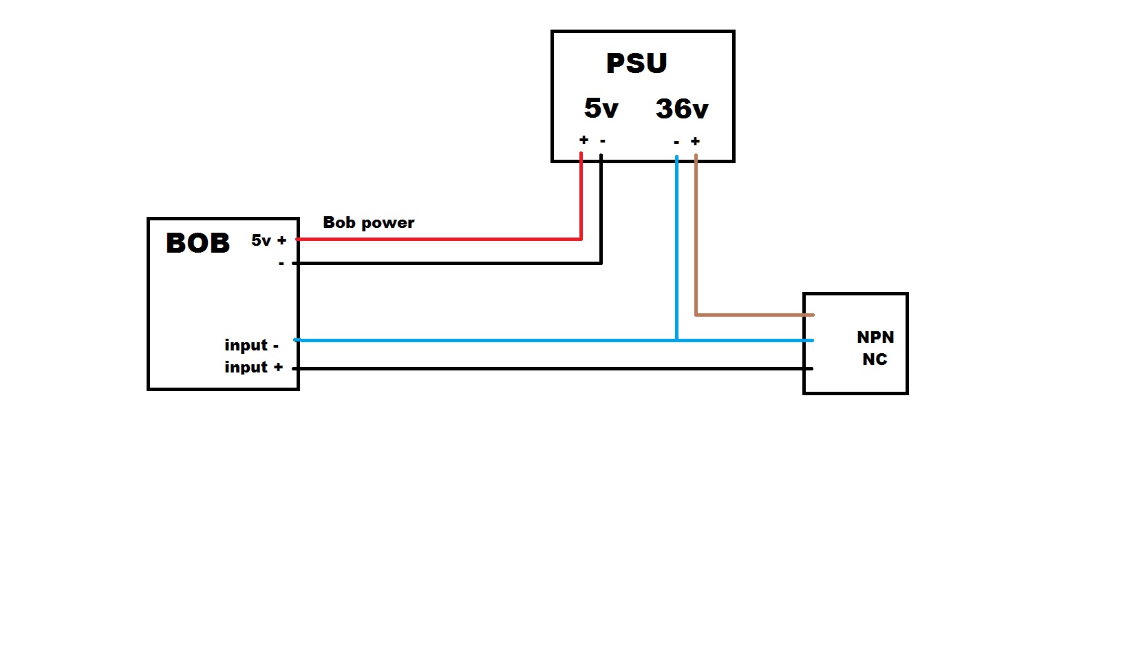

My BoB is powered by a seperate Transformer which has a duel out put of 5 v0lt and 36 volt

Yes, as long as they switch to ground and don't have an internal pullup. You can check this by measuring the voltage between the black and blue wires when they are powered up. If it's always zero or there abouts then you can without any other parts. If there is volts then you need a resistor between the black wire and the Bob.
Here you go ray this might help. (Provided Switch can use 36V)

Eddy, Jazz and myself have all said the same thing, and any supply to the switch between 10 and 36 volts will work.
The only reason I'm being slightly pedantic and suggesting you do some basic voltage checks is to avoid any issues or disappointment. Chinese supplied products can vary in subtle ways especially stuff on ebay. That switch comes in 2 variants. One is truly just a switch to ground and that's what you need. The other version has an internal pull-up resistor to the +v supply and if it's that version then there is a chance you could damage the BOB if you don't have a resistor between switch and input. All I'm saying is do the electrical equivalent of 'measure twice, cut once' :)
Ray This is why I postedIt truly is not that difficult just buy the switches and play with one of them not connected to the BOB and see it working. You need to mount them as has been said so that the target slides across the top and not head on so to speak. ..CliveQuote:
Just a thought although all of the above is correct are we assuming that the sensor has a resistor built in of say about 10K If not would it be prudent to put a current limiting R in.. My sensors have 10K internal so not needed.

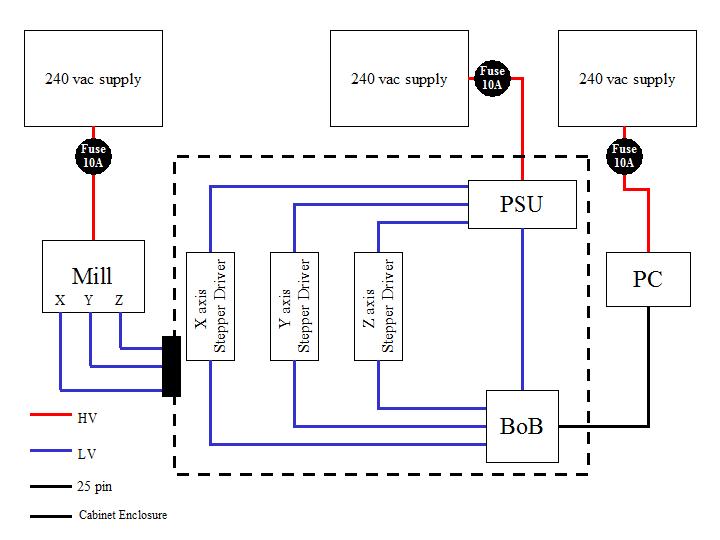

I got these from your earlier threads;
Attachment 12837 Attachment 12838 Attachment 12839

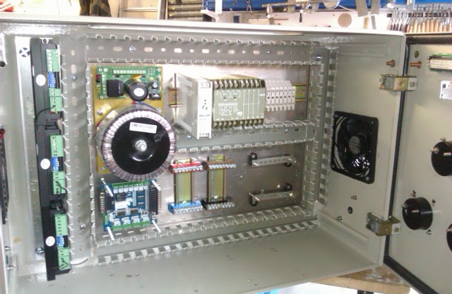

It looks like your power supply is this one;
http://www.zappautomation.co.uk/elec...-supply-7.html
You are using the 36v to power the steppers and the 5v to power the breakout board, you also have a 24v supply in there for the Pilz ?
Because the 36v is used for the steppers I would suggest not using that for the proximity switches as it could contain a lot of electrical noise, instead I would use the 24v supply provided it is DC and not AC.

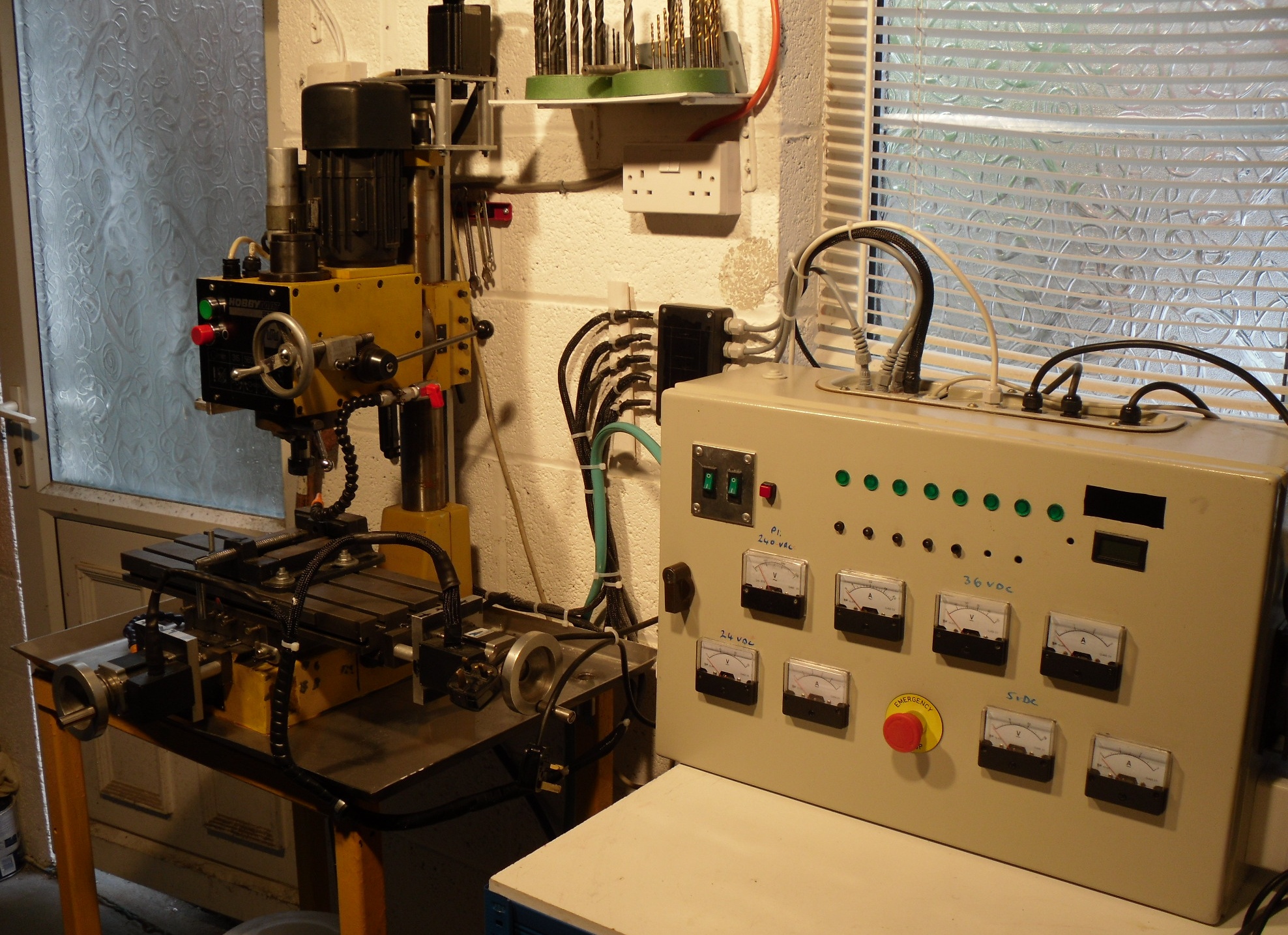

Also, off topic, have you cut any of those nuts yet ? what tooling do you intend to use for a 9 gauge string slot ?
This is maybe a daft question, but do not see a 24v supply for the PILZ unless it is that box to the left of it on the DIN rail.
What do these safety relays do that makes them cost £360? I can see a 4 pole contactor, which is presumably 3 phases and aux and I also presume there is some sort of RCCB and E-stop interface. If you are not running 3-phase, then it seems an overkill ('scuse the ironic pun).
An RCCB a break switch and NVR switch in series, would seem all that is needed for a good level of safety on single phase 240v.
