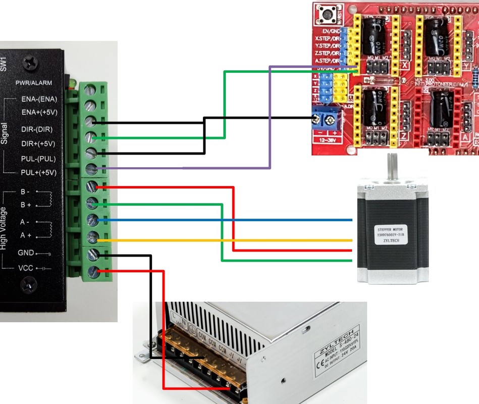

What about these for stepper drivers?
https://www.omc-stepperonline.com/st...or-dm542t.html
I can probably just about scrape 4 of these and a breakout board next week and run them at 24v until I source a 48v one.
I know not as good as the EM882 I wanted but 1/2 the price and means I can start with linuxcnc.

OK still need to source the drivers, would using
4 of these
with 2 of these (2 per motor)
http://www.ebay.co.uk/itm/Universal-...YAAOSwaMpZno1f
be suitable for my machine
3 of my nema 23's are 2.8amp (X&Y Axis)
the other one is unknown but based on shaft length, size and weight it's 2 amp (Z Axis).
I was going to go with AM882's but seems overkill for my application and it's unlikely I will make major upgrades down the line to my machine as it makes more sense to build another one and then sell the first one.
Re: New build with recycled parts on a ridiculous budget 120cm*60cm work area
If you are using a slaved axis arrangement then ideally you will need stall or fault protection to stop the gantry racking the AM882 will provide that.
The drives that you linked to seem to recommend 36V.

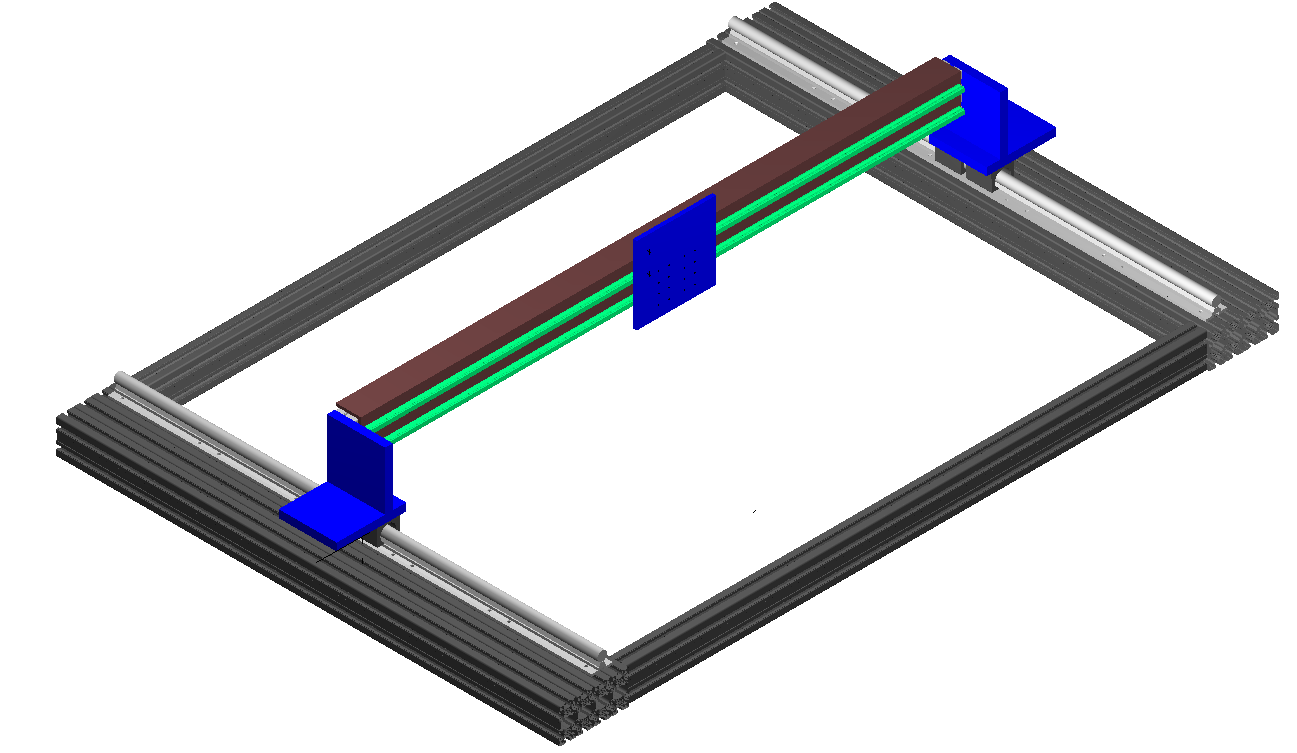

Have you worked out how you will home the gantry so it is square?
Neale
I use 2 motors for my X axis, and I bought EM806 drivers primarily because of the stall detect. The EM806 is a later version, effectively, of the AM882. That stall detect has saved my machine from potential damage on a number of occasions when I've got something wrong. Typically, I've hit the e-stop because of some silly setup or gcode issue, and as a result the gantry has gone out of square. Not a lot, but enough to cause one end or other to bind on rapid feed somewhere along the rails. I've wired the fault signals from the stepper drivers into the motion controller and the whole machine then stops before any damage is done by one motor continuing to drive. Resetting and rehoming is a small price to pay. I reckon that if you are going two-motors rather than one-motor-and-a-long-belt, stall detect is pretty much essential.
I was going to assemble it first then fit (High quality) microswitches both sides of the gantry I need to work out where to fit them because I want them drilled into the aluminium so they can never move, had issues with 3d printer microswitches but they were super cheap, plastic printed mounts a nightmare on the Z. Conversly it's the X&Y that are the hassle with cnc with 3d printing they're nowhere near as important.
I've not looked at Mach 3 or linuxcnc but I have assumed that the microswitchs have some software adjustment to compensate for inaccuracy when fitting the microswitchs I know grbl (And even Marlin for 3d printers both Arduino based) does so would be shocked if they don't.
I figured one step at a time lol make router move and learn Fusion (These are at same time) then start with linuxcnc if I really struggle buy Mach3 but I'd rather use Linuxcnc been a linux used since 2005 big believer in opensource.
I did also consider inductive sensors like I set up on my printer for the Z axis but the microswitchs I'm looking at have very high repeatability and the difference in accuracy between them is marginal, when I checked the datasheets the inductive sensors had a slightly higher accuracy but lower repeatability and in the end they were both in the 0.01mm range with is probably better than my router will be lol.
I have no idea how to make sure the gantry is properly square though in the first place, pretty certain a set square isn't going to cut it lol.

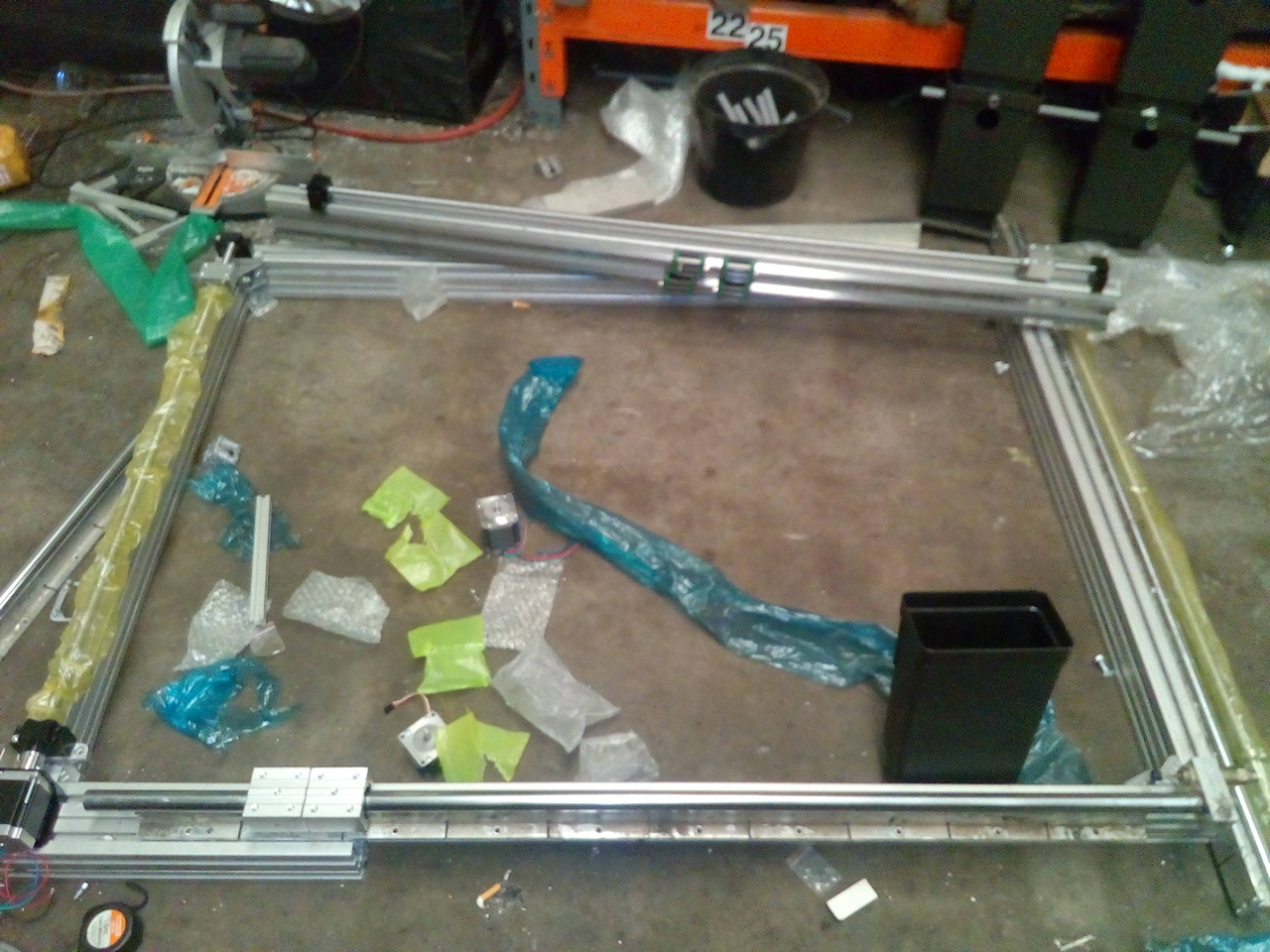

No problem with that - I use EM806 for X and Y, and a recycled M752 from my old router for Z. I was able to use the same 68V PSU for all of them but it's fine to run them off separate supplies if needed.
Desertboy
Machinist's square is one option, but they are expensive. I got a 200mmx130mm one (square to 0.005mm/150mm or better) from starret for about 80 quid with a 20% off code.
You can make a less perfect square work by flipping it and averaging the results, but once you get into the lower ranges of measurement just the flatness of the edge can become problematic and that's harder to cancel out.
You can also drill a square with diagonals that you can measure with eg a digital calliper (100x100mm square will give an easy to measure distance that your typical digital calliper will reach). Insert some dowels and measure the corner to corner distance. If both corners are equally spaced diagonally then it's square, if one is longer than the other then it's forming a parallelogram and is leaning towards the top corner of the longer diagonal...
One problem you'll probably encounter, which I also have on my current machine, is that your extrusions aren't particularly flat or straight. You will have varying curves along the axis rather than a perfectly straight line which makes fine tuning the squareness extremely difficult if not impossible as it varies from one section of the bed to another... so you just have to do the best you can.
I used the holes-at-corner-of-100mm-square technique to set up my gantry, and it's surprisingly sensitive to small errors. We're not talking super-accurate toolroom standards here, but for woodworking use it's more than good enough. I used a 6mm drill to make the holes and then 4 more with shanks inserted in holes as dowels. A digital caliper is pretty much essential for this as it's difficult to read a vernier caliper when it's in the middle of the bed.
I wrote a little bit of gcode to drill the holes so that I could guarantee approaching each hole in the same direction to take any backlash out of the equation.
Absolutely... you can theoretically detect around 15 seconds of arc with callipers that have 0.01mm resolution using a 100mm square.
That's about 0.004 degrees
If you nail it to within a couple of hundredth's of a mm then you have a pretty damn square machine. Depending on where I do the square on my machine mine it will be anywhere from about 0.02 to 0.09mm out iirc.

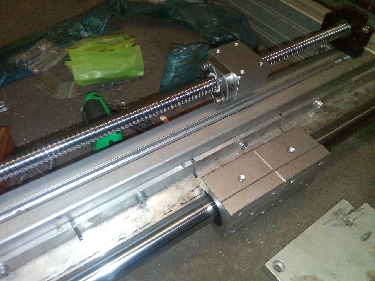

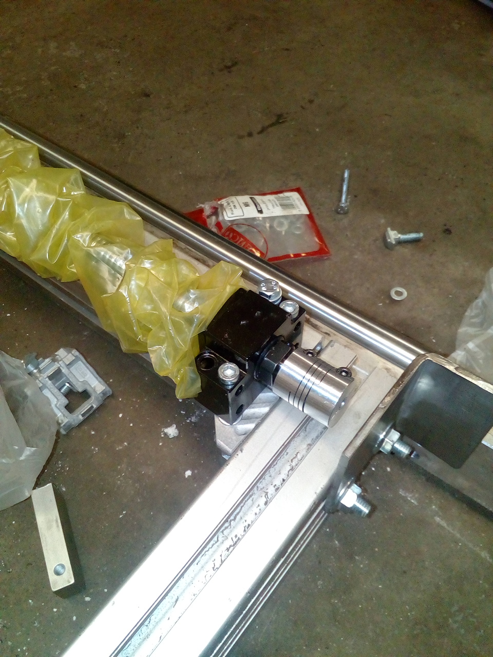

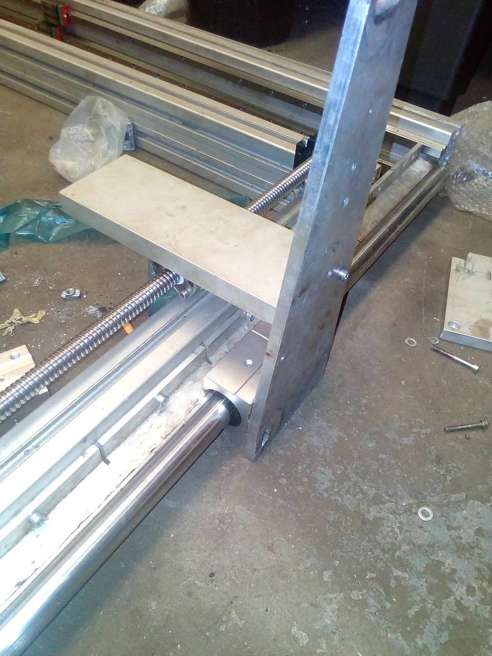

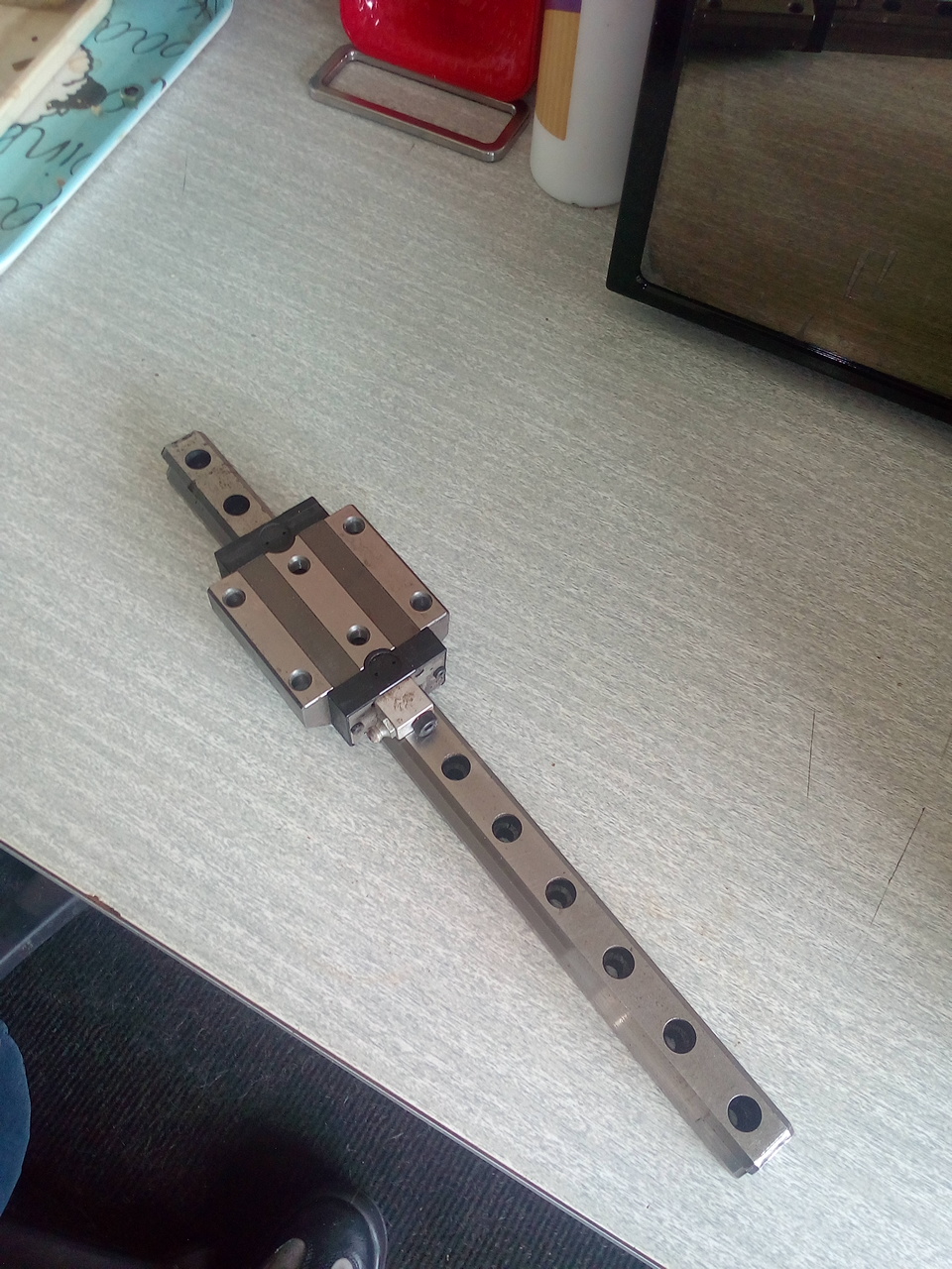

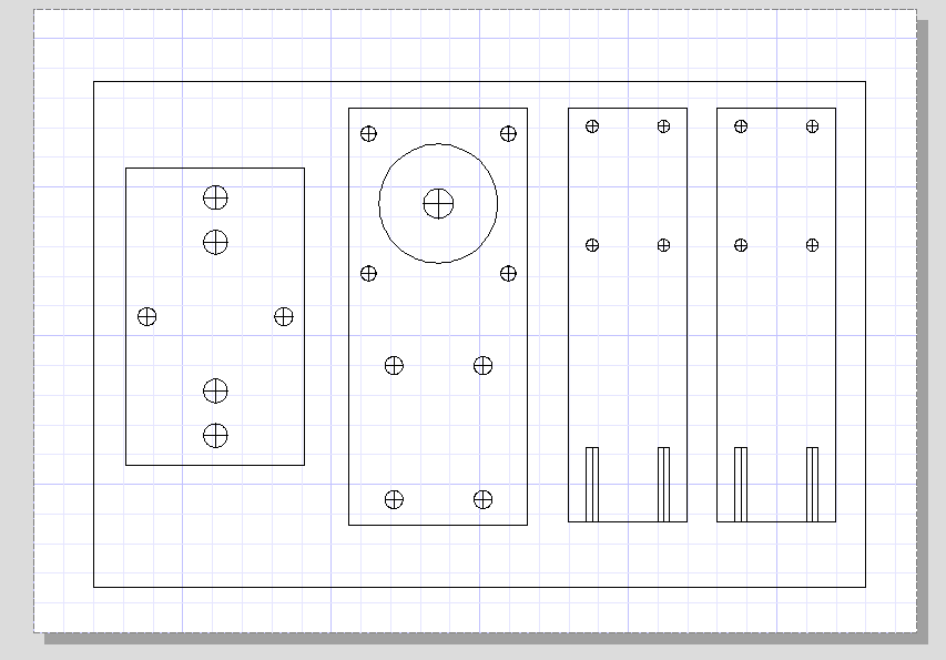

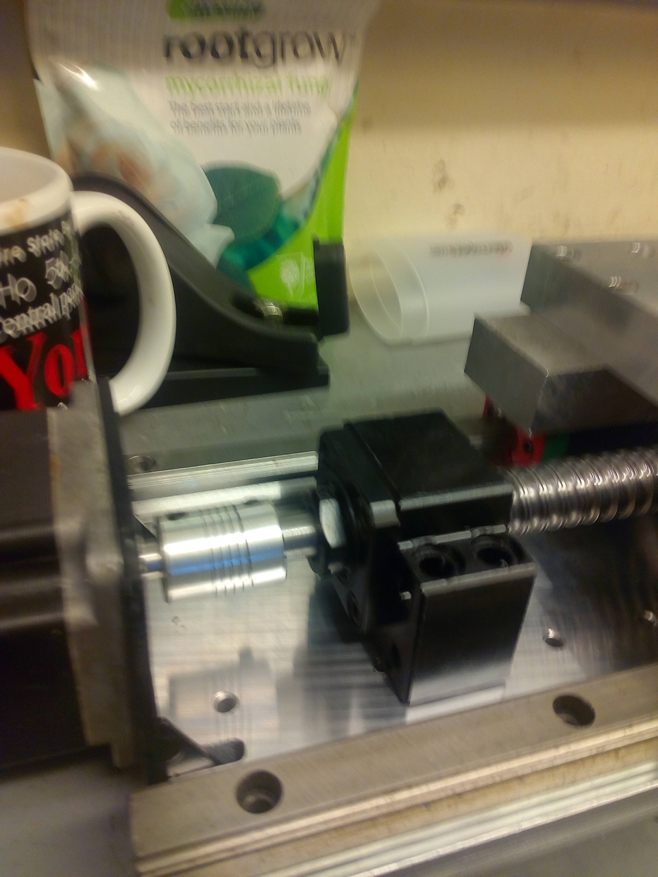

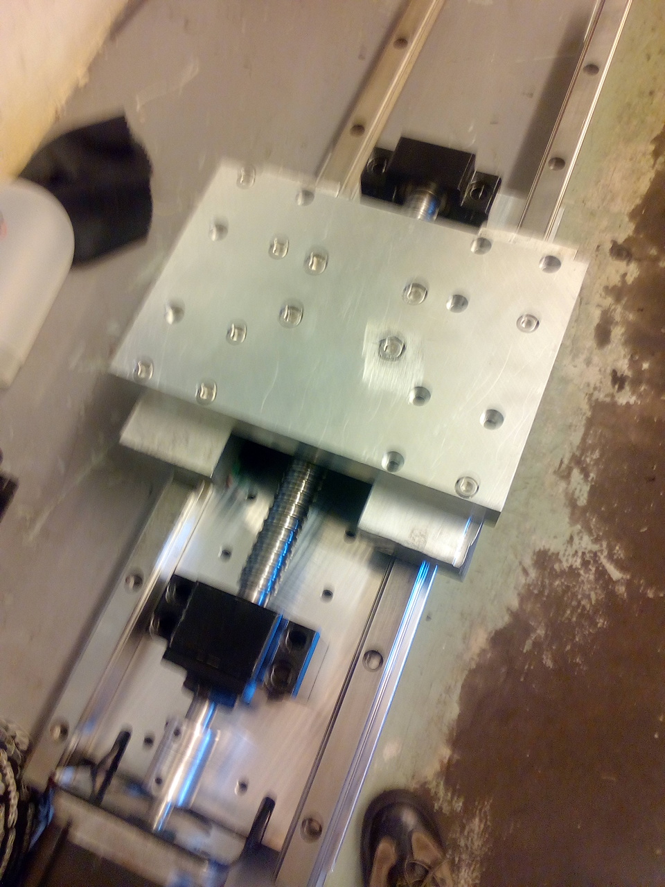

2 Attachment(s)

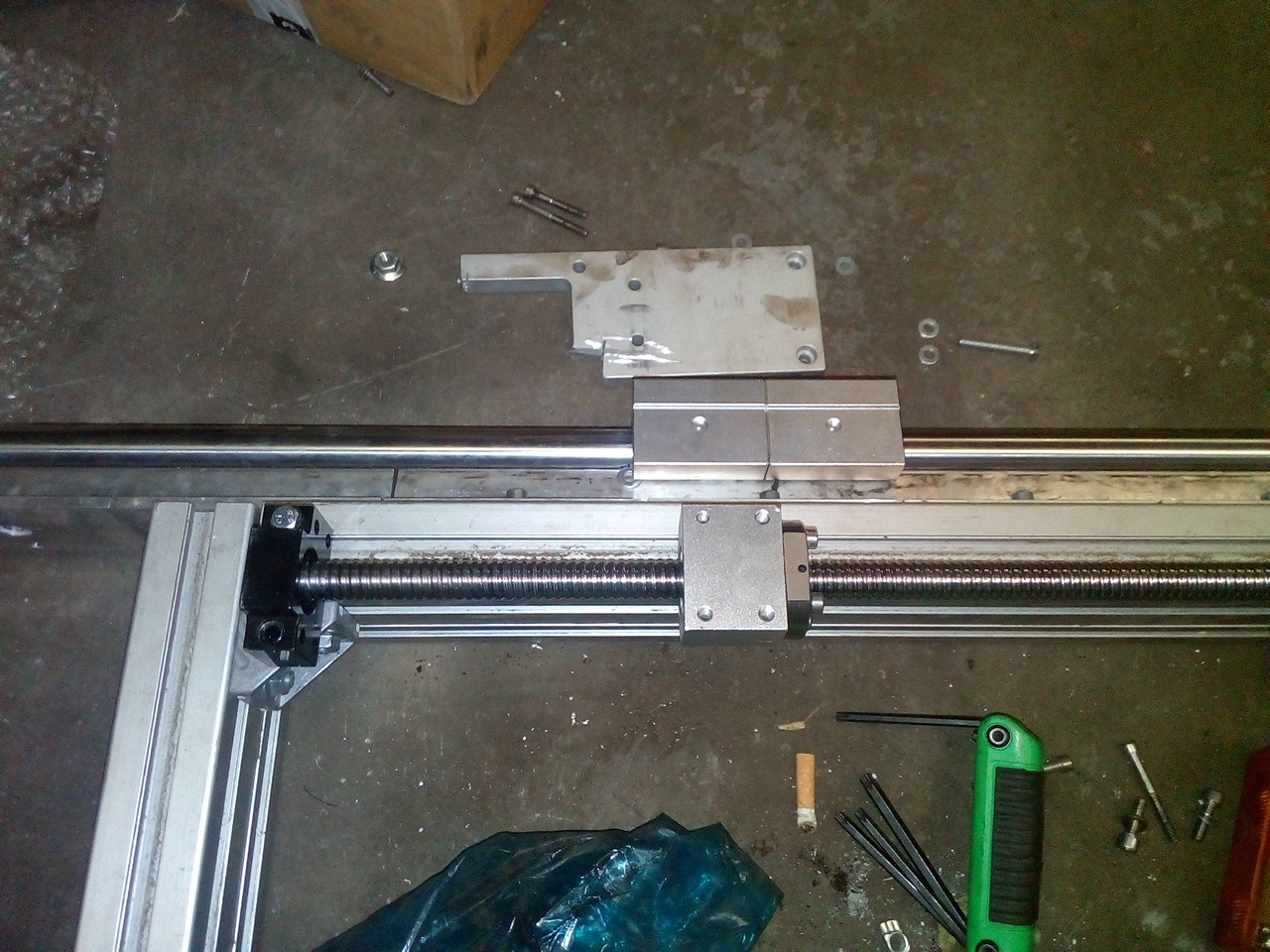

Poor photo's but got the final plate today all lines up ;)
I must have made one of the tightest Z axis ever lol
Attachment 22697
Attachment 22698
One more plate to collect tomorrow morning (Needed to have 4 10mm holes enlarged got an engineering firm to do it) and we can finally put it all together.
Been very happy with my nema to ballscrew alignement 3 of the 4 are perfect not tried the 4th one yet (Gantry motor) but I'm hoping we got 4 for 4.
The bolts in the Z axis top plate are 1mm too long at moment so need to cut them down as well.
I was worried about the Z plate most of all and it all seems good there's a couple of holes to counterbore in the Z axis but simple job.
I was going to chop my Hiwin's down for the Z axis but I'm going to leave them sticking over the top of the Z axis so if I do want to rebuild the Z I can get more travel, my travel is just over 8cm at moment.
When the top plate was being made an end mill broke hence the nasty bit on the top where the scratches are. The part is functionally perfect and the spindle mount is bolted onto this plate so it's also not visible so it would be pointless to remake and a waste of money.
The scratches I made when I was filing down round where the end mill had broke.
Big thanks to Chaz for making the plates and it was a pure pleasure to see Thor and an experience to feel her move lol, Thor truly is something else.

Gantry fits ;) Not bolted in yet just sitting in the recess's.
Attachment 22699
Again Nema aligns to ballscrew that's 4 for 4 ;)
Attachment 22700
Nice! :-)
I see an extra bolt laying in the extrusion groove, what kind of sorcery is that?Lol !

Nickhofen
Nice! :-)
I never even noticed that lol would explain the rattling noise the extrusion was making when I trying to get it into the gantry mounts which was not easy.
I had the plates recessed 5mm either side so the extrusion sits tight inside the aluminium plate, I had it made to a tight fit. Trying to get it on was not easy lol but once it slipped into the recess it was super tight and very nice! Top work Chaz making the plates and top work KJN aluminium for cutting the aluminium so accurately.

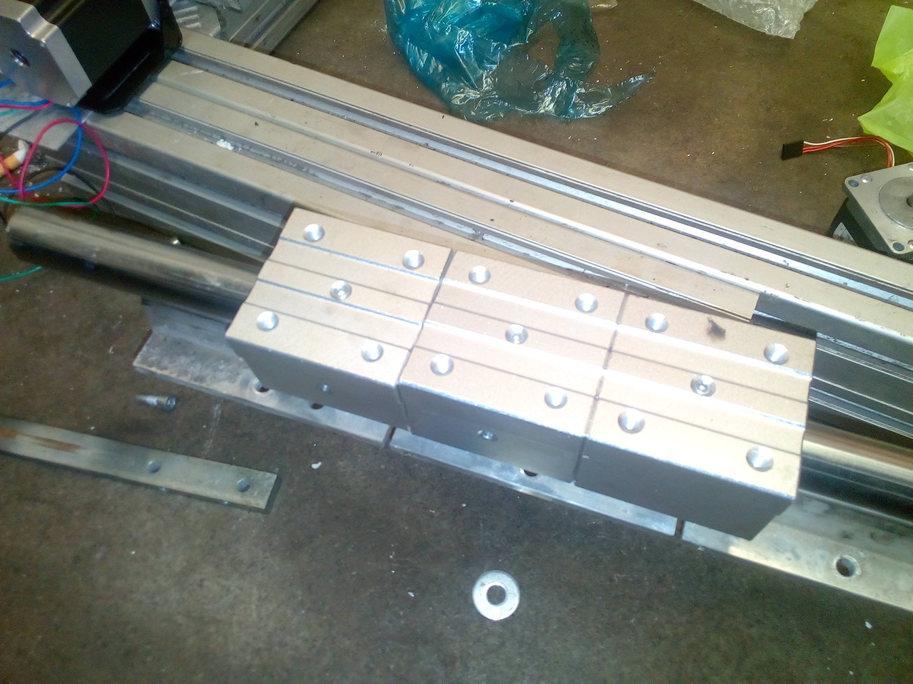

You can see the recess better on the picture Chaz took ;) The Hiwin's were meant to recess into the plate as well but I got the measurements slightly off and they didn't so rather than try and ground the plate out I chopped 1.5cm off the Hiwin's and then they don't need to be recessed.
Attachment 22701
And Nice one Zeeflyboy on the plate advice I used 20mm tooling plate for the gantry mounts, 15mm tooling plate for the back of the Z axis and 20mm tooling plate for the front of the Z axis. The rest was made from recovered aluminium (Nema mounts, BK12/BF12 mounts & spacers). I cannot believe I was going to go with 3mm steel for the gantry mounts that would have been pointless exercise in futility.
