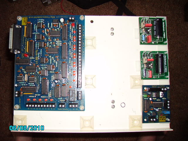

Started to get the basic wiring done.
First job was to identify the step and direction pins on the SD3 Drives using the SD3 manual. Once that had been done I fitted the transistors and resistors which addressed the fact that the SD3 drives use 12v logic and I will be using a 5v logic system.
With those two things completed, ive mounted the boards i have so far.
Attachment 2584
Ive begun to wire things in..
With the help of a post by Irving I was able to wire things to the default settings in MACH.
Attachment 2585.............Attachment 2588
Stepper axis wiring completed!
Attachment 2587
Motor speed interface to be wired between Lenze 534 and BOB
Attachment 2586
Motor speed interface has its own power supply (0-27vdc LM317T based board)
** remember not to wire the output up to anything untill you have set the voltage.**
Onward..
Rick

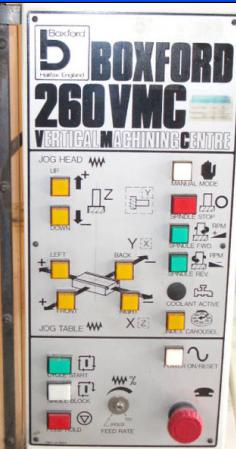

When I got the machine the computer side of things had a few problems. To be able to fire up the machine and test ALL.. the functions was what sold it to me, I liked the fact i could just get it home and start milling. Without some sort of manual control I would have been taking a real big chance with quite a lot of money im sure you will agree.. and although I suspect as you have suggested this may be a function that i will not often use, the fact that the Z axis can be tilted through 90deg means I am more likely to use that function with the head tilted.
The real fact of the matter is that I wish to retain all of the functionality of the original machine so it is something I have to consider, and may be of use to someone else, should I ever sell the machine (not likely, but still), not to mention the fact that other people reading this thread may find the reverse interlock system usefull.
