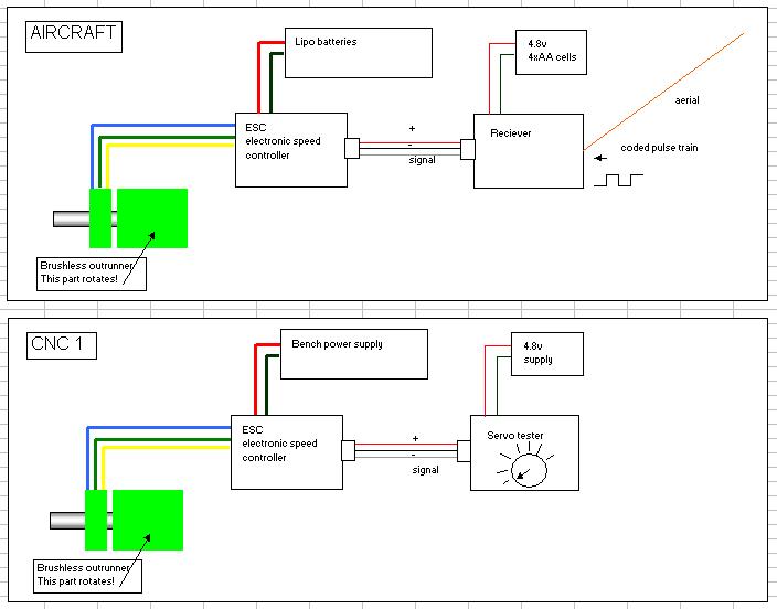

Hi Mark just read ball the thread,very interesting I use a 650kv outrunnnermotor on a mill with a 80 amp speed controller, servo tester and a 15volt psu supplly. I have run it on mach3 to cut some small bearing pockets taking a 1mm cut with a 6mm cutter Ihave not had any problems with heat build up. I have fitted a fan on top of the speed controller bolted to the main frame of the mill.
Tony
hahaha!!! that must have took some doing :)Quote:
Hi Mark just read all the thread
i dont have any heat trouble with the larger two motors, its the tiny 4000kv spindle thats giving the bearings im using a hard time m250cnc(phil) thinks it may help if i run them in bit by bit not alowing them to over heat or trying lighter grease, ill give those a try when i find the time
thank god somone has a rc brushless motor spindle working for them, loads of people seem to have a go at building them but iv had no reports of any useful results untill yours, are you running it 1:1 or are you on pullys and belts??

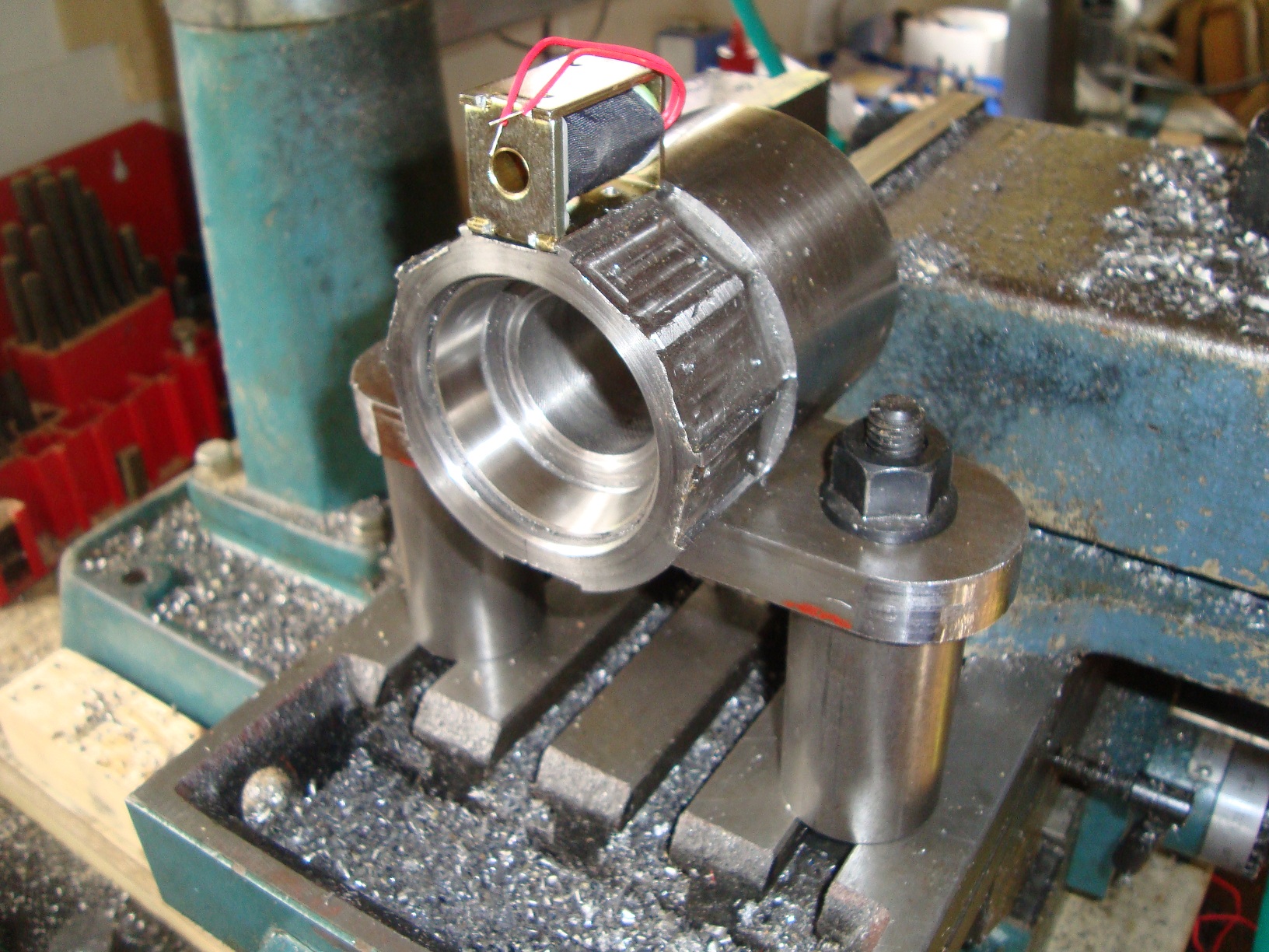

Hi Mark I use a Arceuro ER16 which is 1:1, the motor is actualy a 800kv have loaded a photo
Tony
Splendid!!! 1000w (ish) ??
i might need to fit a fan to my esc, it gets to hot to touch now and again
are you not finding the 800kv a bit quick to cut aluminium?
I use good quality aluminium and spray a small amount of WD40 to lubricate.

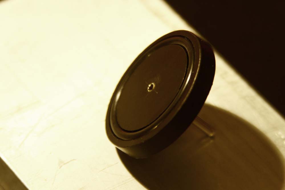

iv been looking at ways of clamping work to the bed without drilling and taping hundreds of blind holes that will inevatably clog with shit
im thinking i will drill and tap some choice holes as and when things develop
i may have a job with a hundred or so small control panles to engrave so iv been looking at ways to clamp easily and with repeatability
Attachment 3573
20mm o/d o-ring with 0.34mm protruding above face
Attachment 3571
one way valve
Attachment 3572
one way valve holding the vacuum,, at 20mm O/D it only just holds onto this alli plate
Attachment 3574
35mm o/d o-ring 0.3mm protruding above the face
Attachment 3575
Attachment 3576
takes quite a bit of effort to get this one to pull off
i left it stuck there like that for an hour and i had to give it a good pull to get it off, i wouldnt trust it to hold while on the cnc but it gives a good indication of how well the valve holds the vacuum
very simple and cheap to make in any size , im looking at machining both sides and just placing them between my bed and work peice out of the way of the cut
once iv proven the cocept i may use a peristatic pump (nice and quiet) to pull the vacuum
iv also orderd some transparent valves so i can see which modules are failing to seal
cant see it not working at least for engraving :)
