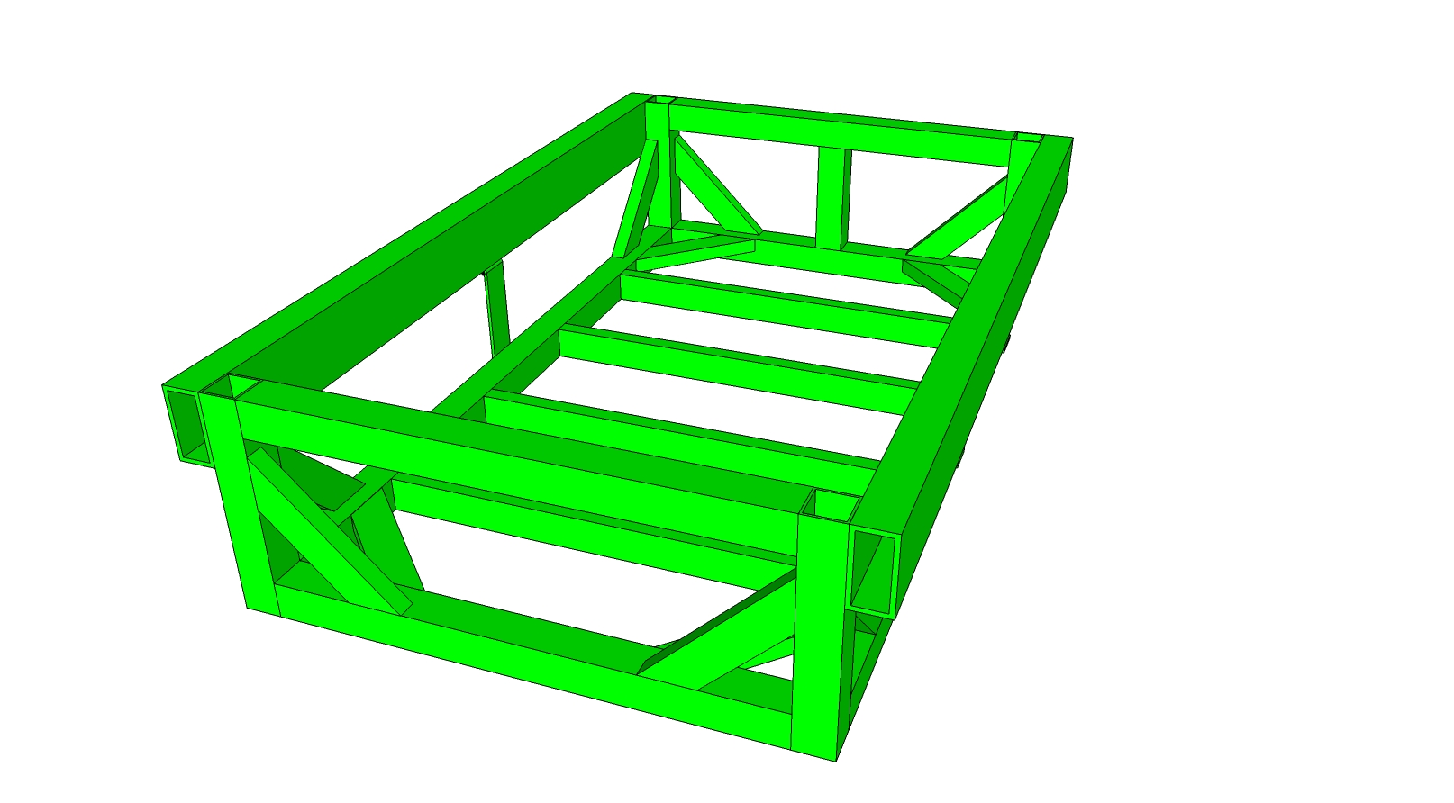

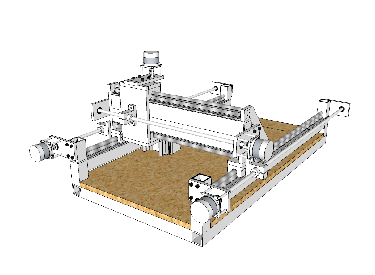

Spent an hour in the shed last night (half of it in the dark working by the light of the street lamp :smile: ) and knocked up a workbench. I'd calculated the lengths exactly and as is always the way I was rushing and cut the wrong piece so one leg (was going to put a leg in the middle of the bench as 6' long) missing. Still it's enabled me to tidy some bits away for the moment which should allow me to bring more stuff back from the fiancé's parents garage! Just got to get my bum in gear and make some shelves, though I'm away this weekend taking the daughter to Uni for the first time.
On another note I've just paid the import VAT and rip off fee (sorry clearance fee) for Parcelforce so should get my remaining linear rails on Monday. Just had the postie drop off some energy chain purchased on fleabay so components are building up! Best stop fannying around with my design and get buying some steel so I can cut and weld it to get on with the build!!

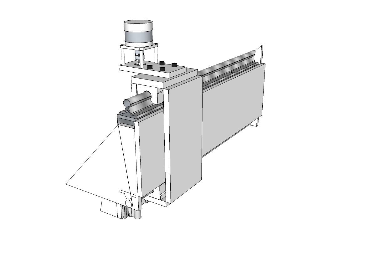

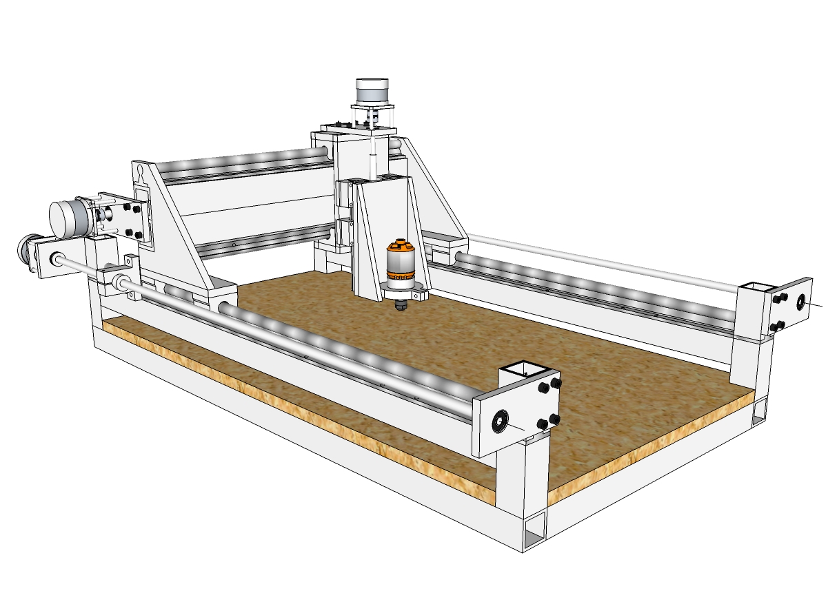

I've added braces at either end now to make it nice and ridged, also will be good when I come to do the self levelling epoxy for the X axis rail beds!
Attachment 10179
I've tried to keep a fair bit of the gantry as straight cuts but have the end plates to get machined and a slot in the front plate for the Y axis ballnut mount to be machined.
Question is.....do I get the square bits machined as well so the faces are flat and square or will the ends be ok as cut?

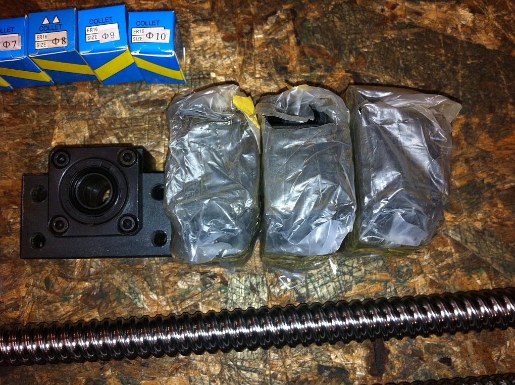

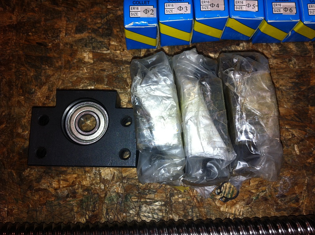

Good job I did as they are different from what I thought I'd be getting (best ask before ordering next time just to make sure!) so I'd best re-draw them and adjust the mounting points accordingly...
That's exactly why I won't make parts for folks unless dimensions are taken directly off the parts or they have them in hand so know which data sheets to work from.! . . .Even then I prefer them in my hands so I can do the measuring.!!

I'm drawing up the gantry plates at the moment in Draftsight so should have some CAD models soon. I'm in two minds whether to do the end plates with slots in so the top/bottom/front plates are located in the end plates (remember seeing something like that on a build you did for someone) or whether to fit the end plate on square to the ends and have less machining?
Yes I'm waiting to get all the bits in my grubby paws before doing the final drawings just for that reason, so I can check all components are as they should be...

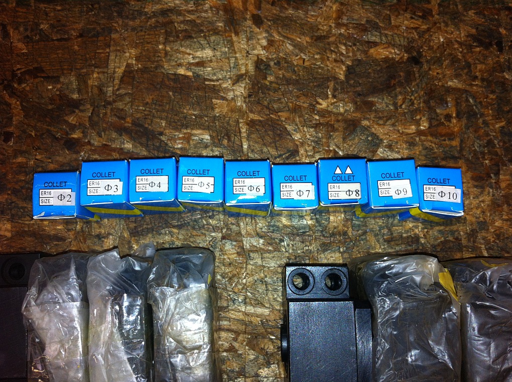

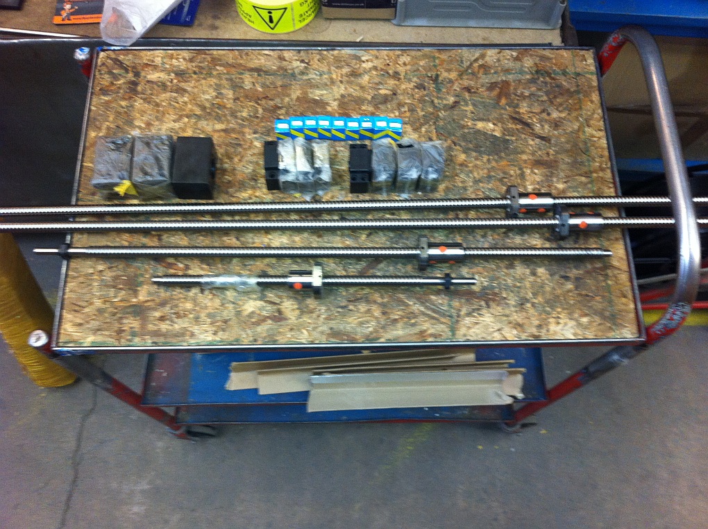

Got my delivery from Chai today...thought I'd got all 1605's but then took a closer look and all was correct! From me paying to them arriving at my door was 9 working days. Excuse the out of focus pics but they were taken on my phone :)
Attachment 10235Attachment 10236Attachment 10237Attachment 10238Attachment 10239

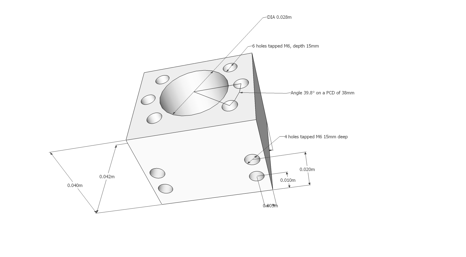

2 Attachment(s)
Re: Comments sought on new build: A CNC Router for RC Gliders and Planes
Jonathan
What's special about the Z-axis ballnut mount that causes you to need a custom one?

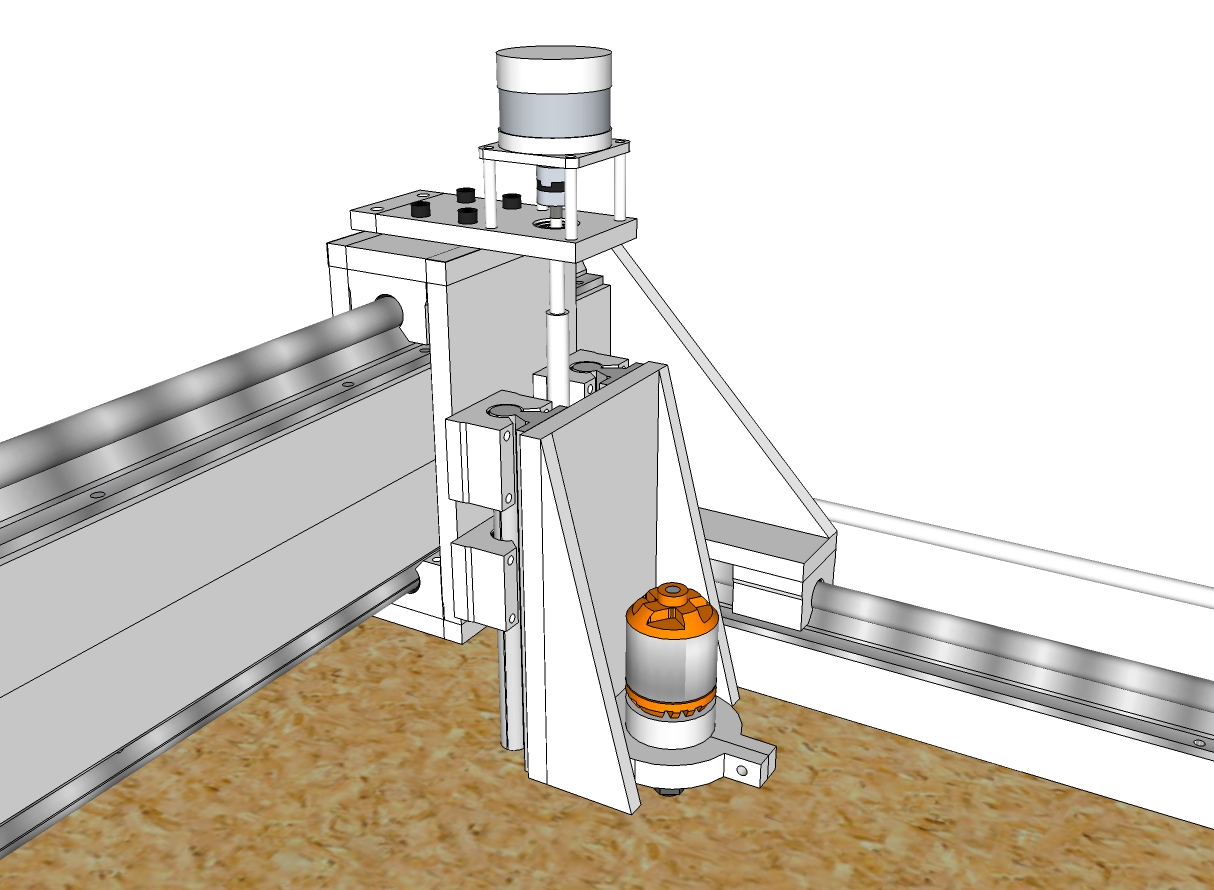

These are what I've drawn...
Attachment 10383Attachment 10384
I wanted them low profile to cut down on the machining required, i.e. so I don't have to get the Z axis plates machined for clearance and so I can get the rails nearer together which I know is not ideal but as I'm mostly going to be machining balsa, ply and carbon fibre will be fine!
They look very similar to these (which I'm planning to buy): Aliexpress.com Ball Nut Housing.
If anything I'd say they are lower profile than the one you've drawn up. The bottom bolt holes are in slightly different places but I'd be surprised if that was critical.
Looks like that's for a RM1605 ballnut, but your mounting holes for the nut don't match? The RM1605 holes are on 45 degree spacing and they're 5.5mm diameter holes so you'll struggle to get M6 through them!
Jonathan
And this is why I always insist the measurements on the drawings are taken from actual parts rather than Spec sheets taken from the Net.!!
So easy to assume they will be like the drawings only for something completely different to turn up.!! . . . .Thou in this case I reckon it's an Err has most ballnuts of this size use 45 Deg spacing & M5 bolts.?
Funnily enough I've taken home one of each item to measure with the vernier calipers ;)
Wobblycogs
I've asked for a price for 4 off (I can't see anything apart from a 3 off listing) so will see what they, well the 1610 ones, come back with as they look exactly what I'm after!
Just received some spiral flute taps from China so once I've welded up the frame (should have all the parts cut by the end of today as I did all the 50x50x4 box this morning and just have the 50x25 bed supports and bracing angles to cut at lunch!) and got some Ali cut for the gantry I can start drilling and tapping to my hearts content :thumsup:
Attachment 10386
Edit.....yep all steel for the router frame (not support frame) is now cut. Welding starts tomorrow :yahoo:
