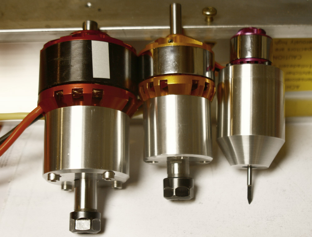

Had the spindle running tonight, coupled it up to my Trex 500 esc...it works!!!

Mark, you've got some smaller spindles haven't you? How have you done them? I want to make a smaller powered one but one that runs much quicker to cut balsa, but on looking the smallest shank of an ER11 collet holder is 8mm and I don't want to be messing around turning the shank down to 5 or 4mm if I can help it!
Cheers Jonathan, I looked at that but I was looking to do one if possible where I can change the tool without having to remove it from the motor. I was having a look to see if there was anything out there like a pin vice that could be used but thought I'd float the question.
I've got a Proxxon E50 that I was originally going to use but thought I'd go back down the brushless motor route.
I've scoured the earth looking for a good quality pin vice type thing... it drove me up the wall... i even did a search for ER3 collets lol ... alas... there is no such thing :(Quote:

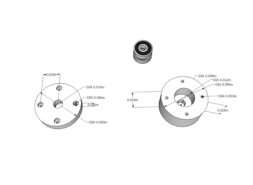

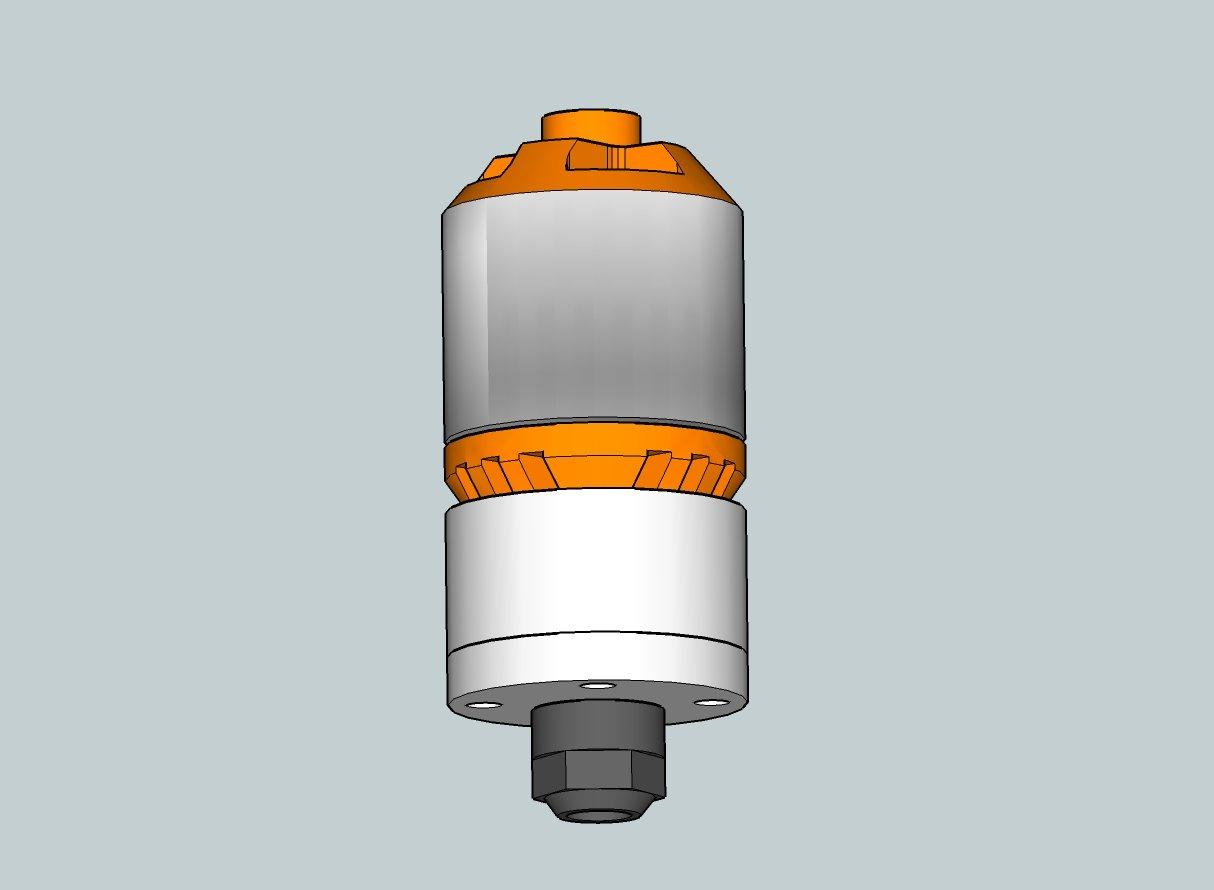

Many thanks for sharing all this info, it has inspired me to build a spindle based on a 5045 motor & ER11 8mm spindle :-) I have a couple of questions though which I hope arn't too simple !!
- The bearing arrangement is along the lines of: for the chuck/housing interface a pair of Angular Contact (AC) bearings with 4 pre-load washers between them? And for the housing/motor interface a standard roller bearing? Where would be a good place to buy the AC bearings with matching pre-load washers (either UK or eBay).... any spec available so I know what to ask for?
- I'm guessing the AC bearing assembly needs to sit proud of the housing before the cover plate clamps it all in place - how much of the bearing should be proud?
- I am looking at 24V power supplies and wondering if I need to have one large power supply to run both the NEMA17 steppers and the spindle of if I should really split this into 2 suppies with about 5A @ 24V for the steppers and 20A @ 24V for the spindle?
Thanks for any tips :-)

You require two magneto/angular contact bearings and they need to be pre-loaded, hence Belleville washers are mandatory, unless you can find a matched pair of bearings but that wont be cheap. There are sellers with 8mm angular contact bearings on Aliexpress.com - Online Shopping for Electronics, Fashion, Home & Garden, Toys & Sports, Automobiles from China.
Thanks Jonathan - looks like finding the Belleville washers is going to be the hardest part, wonder why they are so rare.
I have spoken with www.simplybearings.co.uk but they need to know more tech info to allow them to advise - any idea what I should be asking for.... or perhaps there is another (afforable :-) bearing in their range which would get round the Belleville washer requirement?
