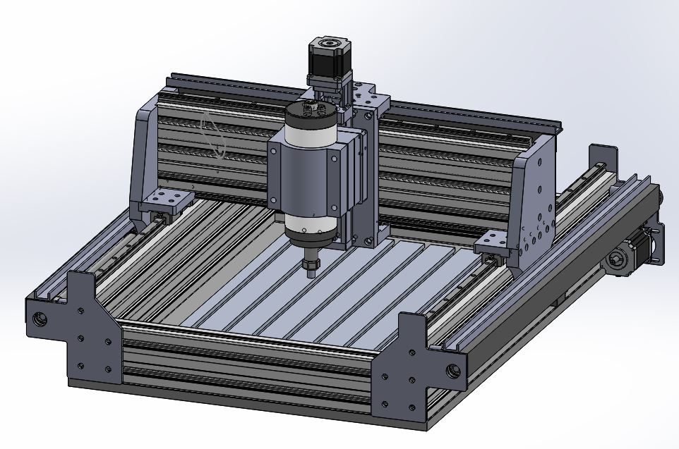

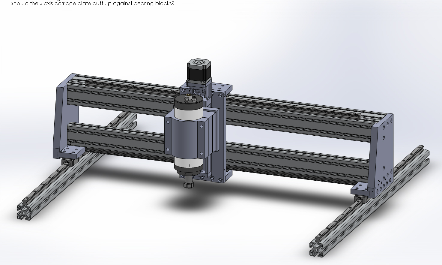

Still tons of work to go but a few pics of the latest design... I went back and reduced the overall size fairly substantially as I realised I didn't need it. I'm a lot happier with the general direction now.
Attachment 16570Attachment 16571Attachment 16572
Coming together but . . .
the spindle hangs a long way out in front of the gantry - what's happening with the Z axis? Can you show a side view of the Z axis ? Is it profile rails on Z - looks like they are very close together and possible you are not pocketing the ballscrew etc. therefore giving large overhang.
Stiffness drops off significantly as you move out from the gantry so worth getting it more compact if possible.
Dave drop that Linear stage for the Z axis it's massive weak spot on machine.
I'd also look to beef those plates holding motors etc but other than those 2 things it's coming together nice. .:applause:
Edit: didn't see Rout's post same thing really.
One other thing regards the Drop bracket on the Y axis at rear it needs more support from a brace.

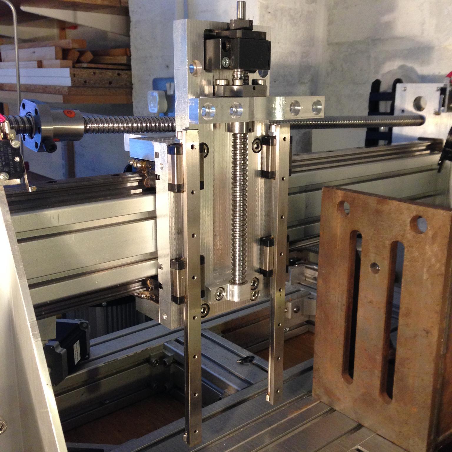

I know what you're saying, that is a concern of mine. At the moment I'm using a thk kr33 assembly as I bought it a while back. However, I am planning to use the excess thk linear rail that I'll have left in the future. Perhaps I should design that in now...
OK, I'll get onto that tomorrow! I assume 2 linear rails with the ballscrew in-between them sitting in a slot to reduce the overall depth? I'm using THK HSR15 carriages for the other axis, I assume these will be OK for the Z too?
The drop brackets on the rear are 5mm steel at the moment. I can increase this and also add some kind of right angle bracket perhaps.
Lee - How do I delete a reply I made ?
Even if you don't really need them for strength, this is one place where "20" rails and carriages can be useful to give just a bit more clearance between Z plates for the ballscrew and nut. If you have to buy them and don't have something in stock already, this might be something to consider.
Yes more than enough regards forces etc but has pointed out by neale 20mm can work better regards spacing etc. Personally I use 20mm on all axis for simplicity and hardly any difference in price.
Yes you need more bracing to stop deflection. 5mm steel isn't really upto to it without being braced.
I have 15mm rails on Z and they work ok but they use M3 bolts on the rail and carriages which look very small compared to M5 on the 20mm rails on my Y axis. When cutting I can feel vibration across them especially the top ones and for this type of machine I would go with 20mm on Z.

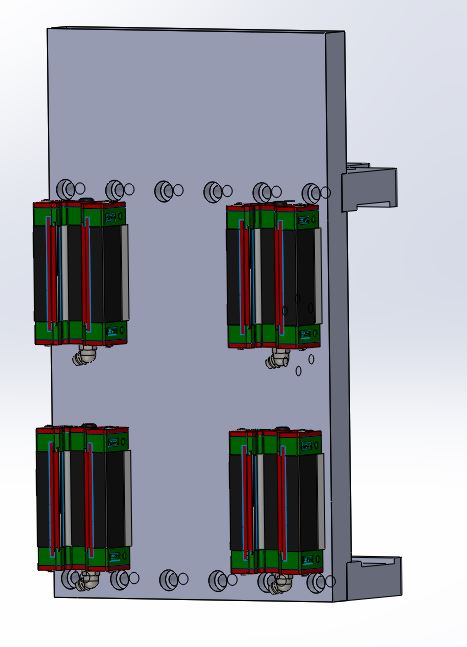

Thanks for all the feedback guys. I think I'll go with Hiwin 20mm for the Z axis. What would be the "minimum" recommended centre distance between the two rails? I want to keep this as small as possible to maximise the effective Y axis length but without compromising rigidity. At the moment my whole Z axis assembly is 130mm wide..
My Z axis plate is 147mm wide and the Z rail centres are only 115mm apart. I did this to maximise Y travel and placed my Y axis bearings pretty much back-to-back.
This works fine for me, but it can give you more stability and less likely to rack if the Y bearings are spread further apart, but you are trading Y travel. If you do spread the Y axis bearings out further, closer to Lee's figure, then I don't think you need to follow suit with the Z rails and can keep them fairly compact.

I've increased the plate width to 170mm now. The z rail centres are 118mm apart at the moment. Do you think the carriages need to be separated more in the z axis? (They are 119mm centres) I'm trying to reduce this length as much as possible in order to reduce the total height of the z axis plate (if that makes sense.
Also, is it worthwhile pocketing the carriages slightly like I've done elsewhere?
Attachment 16587
My rear plates are between 180-200 wide which I find is good balance between strength and space saving for a small machine. On larger machine I will try to make wide has possible to get most ridgidty. Carriage separation I make wide has possible and take the bearings to the edges of plates. Vertical Separation is roughly half the rails length.

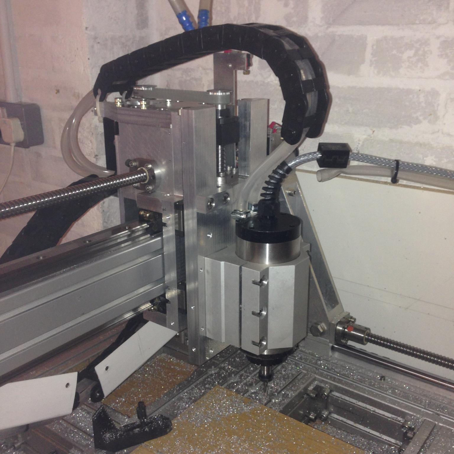

Well the time has finally come... I THINK I'm finally finished! :eagerness:
I've decided to keep the steel end plates. I can get them cut for free (which is a big plus) and I'll paint them to help prevent bi-metallic corrosion.
Attachment 16920Attachment 16921Attachment 16922Attachment 16923
Looking good now.
The X axis stepper motors have the adjustment slots horizontal - will this actually give you much belt length adjustment? Any reason the slots cannot be vertical?
