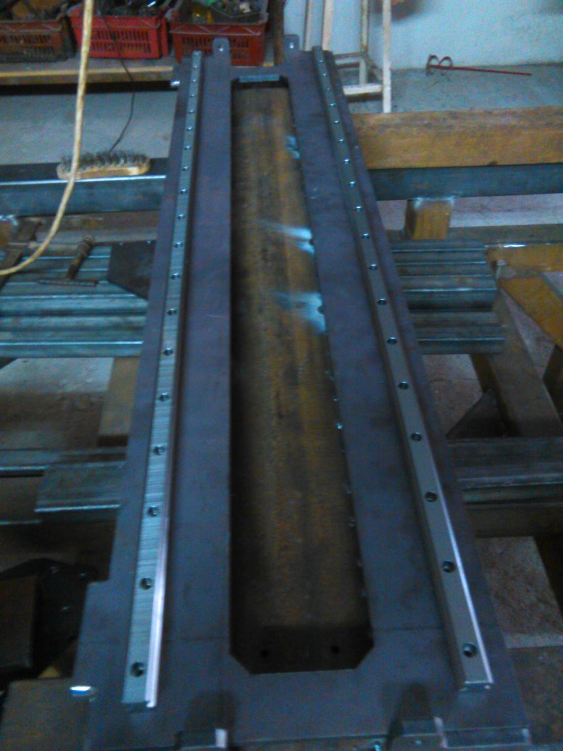

New photos of the progress
Yesterday i cut the steel and the aluminum pieces for the bed
Attachment 12879
I install a winch at the roof , as the weight of the table is big ( nearly 140 kgr so far) to handle with my hands
I turn the table upside down to full weld all the joints
Attachment 12880
I remove the middle piece as i change my plans. Another three pieces will be welded vertical to the sides of the machine
Attachment 12881
I put temporary the steel and aluminum pieces of the bed to get an idea how the machine will looklike
Solid works is very good but the real world even better.
Attachment 12882Attachment 12883
I will use epoxy for the rails level but i try to be as precise as possible.
I chek the level of the table and the results are very good
I use two diagonal threads that they just touching each other ( that means the orners are at the same level)
Also i use a digital level that shows RELATIVE ANGLE between the diagonals 0.0o.
If you see the videoa the absolute angle is 2.0-2.1. That is not a real mesurement as the level fall from my wifes hands and has an offset 2.0o. That is not matter as what maters is the relative angle
Here are the videos
http://youtu.be/3d5rWFlVGiQ
https://www.youtube.com/watch?v=mZRs_tw1Dv4&feature=youtu.be

Here is my progress the last two days.
Yesterday all the day pass drilling and taping the bed and the table for attaching the bed
Attachment 12913
Attachment 12914
Attachment 12915Attachment 12916
Attachment 12917
And that is how i end up today
Attachment 12918

15 Attachment(s)
Re: Stell frame cnc 1500X1000. Adjustable table your opinion please
Today progress
I have to weld the upper 80X80 pieces ( where the rails will rest )
The lower pieces ( over the foots) make i little curve ( nearly 5-6mm ) at the middle as reult of the heating.
So i decided to weld 4 spacers at the corners. Put the upper pieces with spot welding after make everything square and parallel as possible
Here we are
Four spacers 120mm at the corners
Attachment 12957 Attachment 12958
Then i put the upper pieces and before i spot weld i try to make everything square. I use the 1160mm pieces (this is th excact distanse that the upper 80X80 pieces should have) that i will use for the gantry, and other parts of the cutting bed to make everything parallel
Attachment 12959 Attachment 12960Attachment 12961 Attachment 12962Attachment 12963
After having the tubes as parallel as possible i messure the excact distnace and cut the rest of the spacers. Then i spot weld from the middle to the corners. After everything was in place i start to full weld the table. In order to avoid too much heat i make 2-3 cm welds at a time from one spacer to the other and from the on side to the opposite. So i pass along the table 20-55 times( welding and cleaning the welds). In order to have better welding results i rise the table to have better angle
Attachment 12964Attachment 12965Attachment 12966
End of the day and after turning the table upside down to full weld all the sides, i think the result is more than acceptable
Attachment 12967Attachment 12968Attachment 12969Attachment 12970
0.0-0.1 radius ( messured at different spots) the offset between the upper rails and the vertical pieces.
This offset will be zero after epoxy ( ...i hope so )
Next step is to make the tuning foots. That is why i weld a 80mm piece at every leg with a hole in the middle to pass the m18 bolt.
Attachment 12971
Then the epoxy method will take place
Till now i think it must be nearly 200 kgr. The winch save me from a lot of work
Thansk for your comments
P.s Do you think that the legs should be connected at the lower part of the table?
Vagelis

4 Attachment(s)
I bought M25 or so bolts for the machine, soldered the nuts to the legs, thinking that will hold. When the machine was ready i left it on the nuts only and they lay on the hockey pucks. cause i did not find M25 bolts sturdy enough. On your machine M25 6cm bolt on the legs will shake like a plastic, once that heavy gantry starts accelerating.
The pucks are made from hard PU rubber. make sure they are the solid ones, not refilled with something.
You call 1cm imperfection :joker: , i have to deal with 6-7 cm inclination in my garage and i plan to level it with cement. Thats what is best to do, to level the floor under the machine. If i had to deal with 1cm, i would simply stick 10mm steel plate below the leg.
Translate for you design:
I meant these pieces in blue Not to be welded until the gantry is ready and mounted and rectified in all directions:
Attachment 12974
Then bolt these 2 together with a piece of paper between them/that for the later paint thickness
Attachment 12975
Then bolt all that is in blue together as it would be at the end, trying all bolts to be in the center of the holes. the bolts must not be tightened very much
Attachment 12976
Now move to one end the gantry and spot weld with 5- 6 spots 1 of the pieces in blue from the first picture. Rotate by hand the screw and move to other end of machine. Now you spot weld the other fixture.
then dismount all in blue, ballscrews , etc. Then weld well the 2 fixtures. No everything is in parallel/guide rails and ball screws/ and perpendicular/ball screw supports.
When painted and ready, mount them the same way. So the only necessary adjustment will me made by the play of the bolts that hold the ball screw end supports to the fixtures. Tighten them when gantry is at that end.
In other words, now all 2 rails and 2 ballscrews are exactly parallel and have exactly same travel. Doesn't matter if one is up or down, otherwise using other method that also should be taken care of.

27 Attachment(s)
Hi everybody
Here is my last week progress
Firstly i get the bolts and the steel pieces laser cutted last Friday
Attachment 13035Attachment 13036
In order to save money i didnt laser cut the holes ( wherever needed ) except the straight slots. I just ask to point the center of the holes
So i use these centers and then i drill the holes
Attachment 13037Attachment 13038Attachment 13039
At the following photo you can see two pieces that will be bolted together. The upper piece will be welded with the gantry tubes and then it will be bolted with the lower piece. The holes of the two pieces should be excactly coeficient so i drill the upper piece an the i put the one piece over the other to mark the ceter of the holes
Attachment 13040Attachment 13041
After pointing the centers i had to drill the holes. That took me A LOT OF TIME. Even more time i need for the tapping
Attachment 13042Attachment 13043Attachment 13044
Today i start the adjustable foot construction. Syliavski suggest me not to put that foots. Even if i use them or not they are very usefull to level the table as perfect as possible for the epoxy method. You will see each foot has 4 holes. The one at the center is for the bolt the other two ( the smaller ones ) are to bolt a softer material at the side of the foot that touch the ground. The fourth hole is for bolting the foot at the floor
Attachment 13045Attachment 13046Attachment 13047Attachment 13048Attachment 13049
Then i lift the table with the winch and put the foots
Attachment 13050Attachment 13051
https://www.youtube.com/watch?v=S1RO4O7IUfc
After that i go on with the tapping. Too much time but the result was more than good
Attachment 13052Attachment 13053Attachment 13054Attachment 13055
After i bolt the side parts i start to work with the gantry. I put the two side braces on the table and then i attach the vertical 10m plate.

15 Attachment(s)
Hi everybody
Today i go on with the gantry
I start by drilling the holes for the bf/bk on y axis. to do this i remove the 120X60X3mm middle tube of the gantry. I put the ballscrew on place and point the holes
Attachment 13094Attachment 13097
Then i put the tube back to the gantry and start aligning the tubes with the steel plates. After that i start spot welding the pieces. With small weld in order not to produce muh heat
Attachment 13096Attachment 13095Attachment 13099
At this photo you can see the 1120mm long m8 bolts that i use to keep in place the side 10mm steel plates
Attachment 13098Attachment 13100
After the side spot welding i had to weld the tubes at their side that atteced each other
First pass i start with spot welding every 10-12 cm. Second pass i weld between the old spot welds ( every 6cm) and so on.... In order to have better result i turn the gantry a bit
Attachment 13102Attachment 13101
Finally i end with this result
Attachment 13103
Attachment 13104Attachment 13105
Then i put the front steel plate on the tubes construction and temporarily i put the rails on, in oredr to see where to drill the holes in order to bolt the plate to the tubes
Attachment 13106Attachment 13107Attachment 13108
The only question i have is about the way i weld the tubes. Are these spot welds ( every 3-4 cm) enough or i should make a full weld
Thanks for your time
Any suggestion will be glad to hear
Vagelis
That with the long screws holding the plate is great idea, thanks for sharing the photos. I will do the same, as i don't have long clamps.
All looks very good!
I fully welded the gantry on the machine i finished and spot welded the Z. Now that you have all in place why don't you repeat the spot welding until all spot welds are very close?
If it was me, i will fully weld it, though it seems that will work both ways. Welding precisely takes a lot of time , i know. I made 5cm stitches, and took care that the temperature of the gantry not to rise above 60 degrees. Used an infrared thermometer. And had to wait a lot for the metal to cool.
You were lucky if your long plate was straight. I had to hammer down to rectify some of the laser cut stuff. Good that i have very big plastic head hammers.
silyavski
Syliavski i think ( not sure, that is why i ask ) that i have nothing to add to the stiffness of the machine. One small spot weld is too strong . On the other hand too much heat may cause deflection and twist . Dont forget that my machine is bigger than yours ( y axis is 1160mm long) so it is more possible to have twist issues.
silyavski
I think it is not but when i bolt it on the tube construction it will be as straight as the tubes. Even then i am not sure everything will be straight. May be machining or epoxy method will be applyied.
