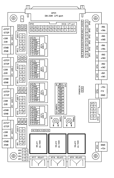

		I'm waiting for the drives ( EM806)  ,bob ( PLC4x-G2) , and motion control( PLCM-E3) card to arrive from Zapp.  I just have the 70 V DC  supply hooked up . i 'm hoping i'll have the electronics from Zapp tomorrow because i'll have a weekend run at the panel so hopefully the voltage will drop when i hook up the electronics and motors as you say. i 'm reading a steady 230 v ac at the input side. i haven't got the bleed resistor hooked up either and i'm still reading 45 v dc at the cap even though i powered it up for  a minute or so yesterday. still, this is progress for me because i never built a supply before , so hats off once again to the heads sharing the knowledge.

		O.K.   state of play so far is that i have the back panel in the cabinet and i'm doing some electrical dwgs so i can at least give myself a fighting chance to get it right . i have a couple of queries  before i go and start lashing in wires though.      this is what i think i know from reading the posts , so i just need some nudging .
1......am i correct in saying that i need a separate  input for the slave home switch?
2 ....  i need a separate input for the rest of the home switches combined in series.
3...  because i'm combining both limits and home into a single switch i must keep the e stop on a separate  input.
4... i also need an input for feed / hold
5..... and an input for  stop.
 bring my total of inputs to 5  ( MAX. allowed)
i also have alarm terminals on my drive  so i'm curious about how i can get these in to an input.   i will  post some drawings of my proposed electrics as soon as i'm finished.

		Ok
1: = yes
2: = yes
3: = yes
4: = yes
5: = yes
You can add an extra two BOB's to your motion controller if you like then you would have 15 inputs.   ..Clive

 The way I do it is to use a Relay for limits. This means I can use 24V thru the switches to power the relay coil, in my case Proximity switches, which gives best immunity against noise.
The drive enables are then sent thru one set of NC contacts, The Limit input is sent thru another set NO contacts.
Override is by way of Momentary button and Alarm buzzer to between 24V and relay coil to allow limit switch to be over ridden.

		Ok well think things could all change now if you wanted because I'm pretty sure that Bob can handle 24v thru it's inputs.? The manual certainly shows them using 12V.
So in this case you could remove the Relays and run 24V thru the Limit switches wired in series just the same but directly to the BOB Limit inputs. I think you'd still need an Over ride button as the Inputs are driving the Enable output so Mach's Auto limit override won't turn these back on.
Then connect the Enables on the BOB to the Enables on drives.
Or just go with my first suggestion if you prefer and want to play safe regards what the Inputs can handle.!
New pic.
Edit: Yes those inputs have 30V Max so your good to go with this Pic.

		i have my drives on the back plate and i'm at the point of wiring up the signals from the B.O.B. . I am using shielded twisted pair, 24 awg , 6 core, for the pulse, direction & enable signals.  do i earth the shield or leave it ? the cable run  is not very long and its in the cabinet.   i know i 'll earth the shield of all the out side cables once they return to the cabinet , (star connection). i'll be using shrink wrap to tidy up the loose ends when i trim the cable back.
 i could use  8 core twisted pair  ( shielded) and that would bring my alarms from all drives back  to a terminal block where i can wire into from my power supply. i have to read up a bit more on the alarms though, the more i read the more questions i have!
Re: Let the fun begin !!! ???
		Will be fine without shield to earth for short runs just try to keep any signal wires away from higher voltage wires like Mains.
