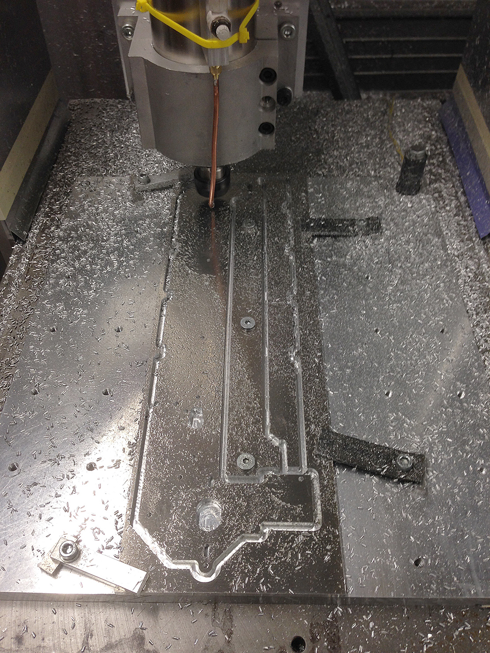

Z Zero, again.
yesterday the job cut perfectly, onion skin just about held it together and a nice part came out. Tonight, same file, onion skin failed as the tool chewed the bed by about 0.1mm or a bit less - this meant the part got 90% of the way and failed on the finish pass, luckily the cutter survived but the part was toast and now resides in the scrap bin.
So, I have two issues here, top-of-material setting and work-holding.
Here is the part before it went flying to the bin in a red-mist:concern:
Attachment 18197
Now, after cooling down, I miked the metal up and it seems the thickness is not very reliable, the 7 bits i have left ranging from 5.05mm to 5.25mm depending where you measure it - I think this accounts for the failed onion-skinning and subsequent junk output.
My first resolution to this is to mark a spot with a sharpie, measure it, note it, CAM the part specifically for that thickness, set the tool zero exactly on the sharpie mark and try again - I do not think this is a machine error, more a material error.
Work-holding, these parts must be 100% flat and clean, if I tried adding some carpet tape etc under it, would I be able to get the part off the bed when cut?

If this is a regular job I cannot see why you do not create a jig waste board to hold material in a recess with appropriate hold downs permenantly in place so 4 nuts or so to lock jig onto bed, material in recess and locking tabs clamps (cheap chinese 120kg hold downs or similar you could have a couple to swing in after finishing pass goes by if needed and cut clean threough each time) to hold material off you go, no more biting into the bed, cutting through not going to matter occasionally one out quick vacuum next one one in, seems to me a lot of wheels being reinvented.
Ok, but if the part is finished all round that would mean diving in to fix clamps while the finish pass is running ? Or pressing feed-hold mid-cut? Neither sound good to me personally. I'm not deliberately trying to reinvent wheels, I just do what makes sense to me at the time i need to do it. The plate is fixed with the three bolts down the centre, these go through the scrap part, the outside clamps don't really do too much.
I just can't 'see' a way to clamp the parts as they are being cut.
As for spoil board then yes, if the bed was not already damaged I would fit one, this one sacrificed itself in the name of education;)
Use a M00 at a convenient point, then press cycle start to continue, spindle stop might also be good at this point :)
Re: Questions on using a moving gantry style mini-mill...
CharlieRam
Yes but the finish cut is one continuous cut, you don't want an M00 in the middle of a continuous cut because you will not get another lead-out and lead-in so a tool mark is going to show, let alone stopping and starting the tool mid-cut will probably break it.
Fitting clamps will mean working in the short space of time while the cutter is up the other end of the job, these parts are small so time is short and this is therefore dangerous. The Z axis mount is wider than the job so all clamps have to be low-profile <=10mm high or it means using a longer stick-out on the tool which again is not good on a 2mm cutter.
These are difficult parts to make well but that does not mean they cannot be made ;)

Hi Dave,
I tend to use the tab method but this does leave a small witness mark (although the parts are just for me so that's ok). For customer parts I can understand why you are trying not to.
So I think if I were to try the onion skin method I would skim the bed first then zero the end of the tool to the BED. Then MDI jog the Z axis up to 5.1mm (if the part is nominally 4.9-5.1 say) and then ZERO the DRO again.
In your CAM you would than ask for a depth of 5.0mm. This would leave exactly 0.1mm of onion skin. This method is independent of the variation of part thickness.

When I use the M00 I simply extend cut into scrap section past end of cut or put in a small loop and restart on a corner with change of direction and no signs of me doing so. think about it like cutting it on your manual mill overshoot on external long straightish edge to fascilitate later clamping, pause in scrap material on overshoot, add clamps to suit which could be pre mounted to swing over and clamp and carry on.
Looking at your part, there are quite a few holes to screw into a spoil board so I would have the M00 after the holes were drilled to insert some screws to clamp the piece down, then just cycle start for the profile

yes there are some 3mm holes on one part and a couple of useful apertures but nothing at all on the second part, on the right in the picture, I can't add any holes either :(
OK then, complete the outer profile, m00, remove waste outer profile, clamp right component leaving room for profile cut, cycle start and finish profile cut to separate parts. Easy :-)
Ah, now that's interesting ;)
So i would modify the drawing to make the outer edge of the two parts into a single path, then connect the inner edge of both parts into another solid path that overlaps the first path at each end, then as you say, run the small holes and the outer path to finish state and full depth, remove junk frame, add clamps to each part and run middle path to finish.
I'm liking that, thanks. It means adding another two tool changes but thats not really relevant if it ensures the parts come off in top quality AND without any onion-skin to clean up.

WooHoo! :)
Thanks CharlieRam, your idea worked perfectly, best parts so far and a lot less stress on the nerves ;)
I need to make some decent clamps etc but the extra tool changes were more than made up for with the time saved through not having much clean-up to do, just a quick run with a de-burrer and a little emery cloth.

Also made up some nice clamps to replace the bent bits of scrap I had on it ;)
Attachment 18208
The bed does need a skim though, I have found in the tool drawer a nice 12mm inserted tip carbide cutter that should do nicely for this.

Well done looking good now
I'm sure you know the clamps are better if the bolt is at the work piece end rather than middle - slotted clamps and more bed plate holes would be a good next step when you get a moment. Good stuff anyway . . .
Yes, thats standard clamping law - bolts close to part and back end of clamp slightly higher than part;)
They do work well though, todays part was another total success, I don't think the stress on the part is that high in this case, there is only one cut that will put it under strain - the second/last pass on the 5mm roughing tool which separates the parts from the central stub, after that it's just light tickling with the 2mm tool.
The next major issue is getting some sort of chip control round her - the mess is ridiculous.
