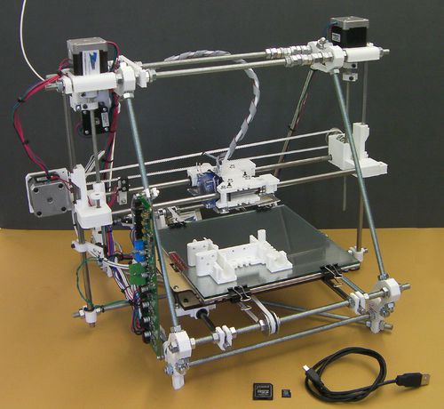

This was the mendel
Attachment 22343
One of the early FDM 3d printers for the home
