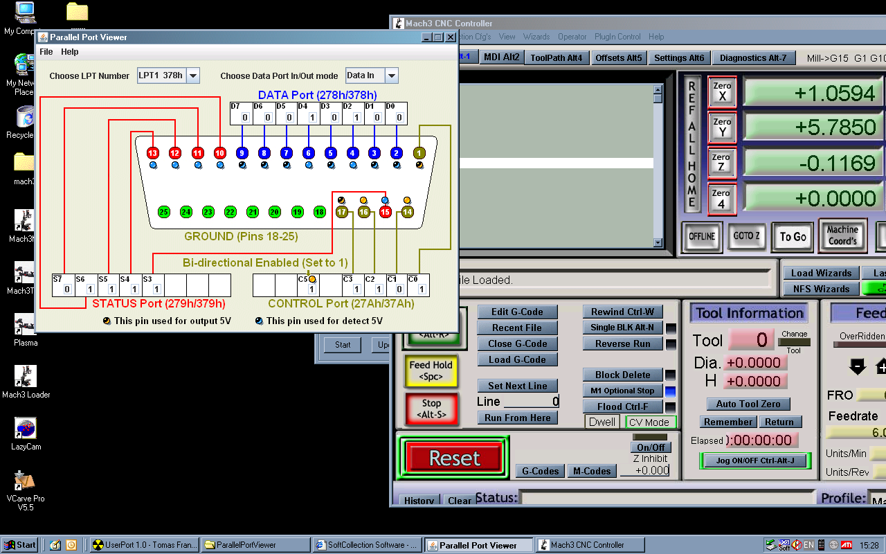

Gents,
Something of interest, well maybe.
Having the suggestion of testing the parallel port on my PC I downloaded Parallel Port Viewer and installed, so I dont know what the pins do or mean my a couple of point of interest.
Without selecting anything and with Mach3 running I pressed the X+ key (left arrow) to see pin 1 change to on and off when X- (right arrow) was selected. So I thought this was giving an actual account of what the pins were doing.
Also when C5 was selected in the PPV screen (screenshot shown) then all the motors buzzed louder, engaged type noise. I dont know it this is significant. Also with C5 (1) C3 (0) C2 (1) C1 (0) and C0 (1) all 6 LEDs i on the board were lite. Again I dont know the significance of the LED's.Attachment 2961

Suceess at last!
Further to some comments/advice about the possibility that my Parallel Port may not be sending the correct signals and testing it via the Parallel Port Viewer I borrowed an old, simply machine from my father in-law as a test.
Plugged it in, loaded the software, entered the values as suggested and movement! A little slow and jerky but all axis move as requested by the key board and test g-code.
A big thank you to everyone.
A couple of things now come to mind. My machine was a very high spec 10 years ago with fire wire, 1mb or ram etc, the machine was built for rendering back then, a specific build for me, also the machine has a trial version of Mach3 installed before I got the router. My thought are now that I must have a conflict somewhere in the system which is preventing Mach3 working. The first thing I will now do is format the machine, install Mach3 and test with the settings I am currently using, if this still fails then a PCI Parallel Port maybe required as an option.
