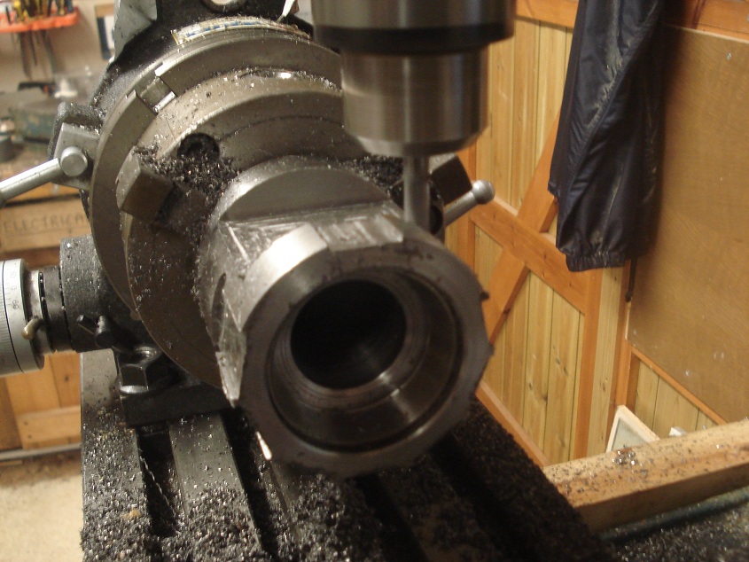

that 4th axis looks posh, what bearings ??? stainless body??? what are you going to drive it with ??? what gearing ???
for a moment there i thought you were using a hi-tec harmonic gearbox but im gessing the hi-tec box i can see has shoes int it lol
I mentioned it somewhere else on this forum...not sure which thread though.

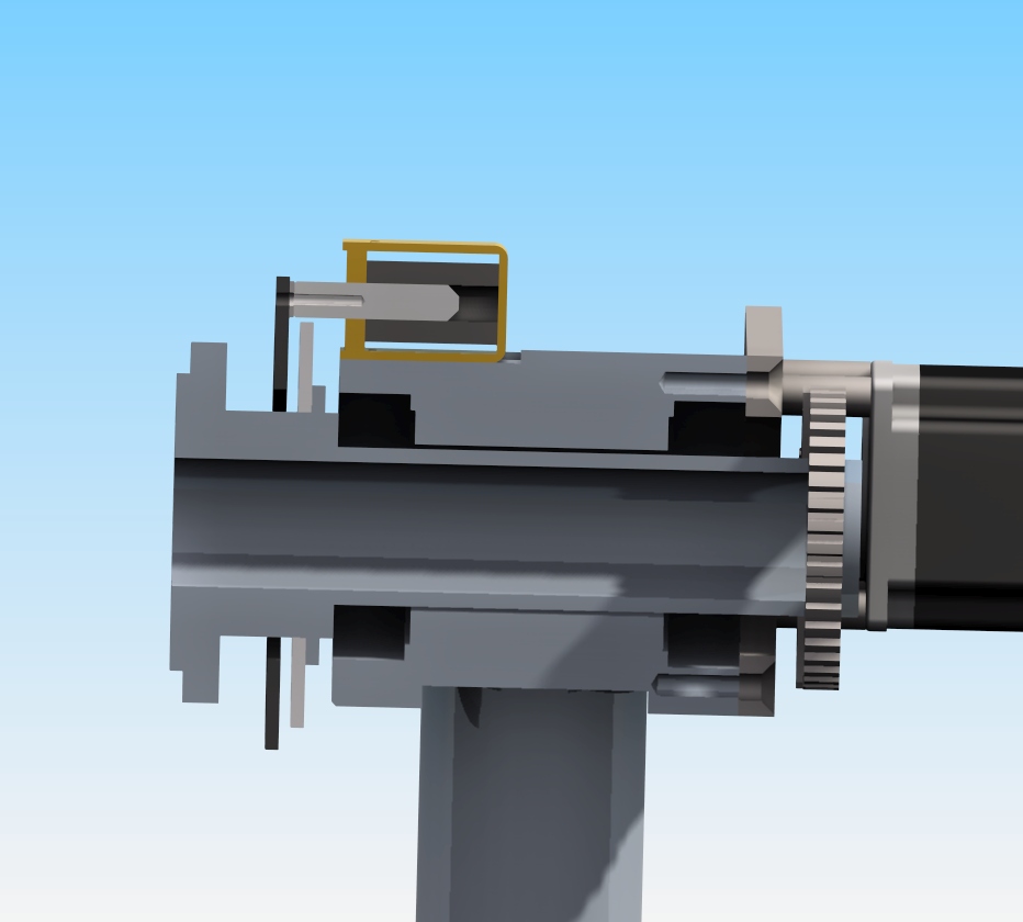

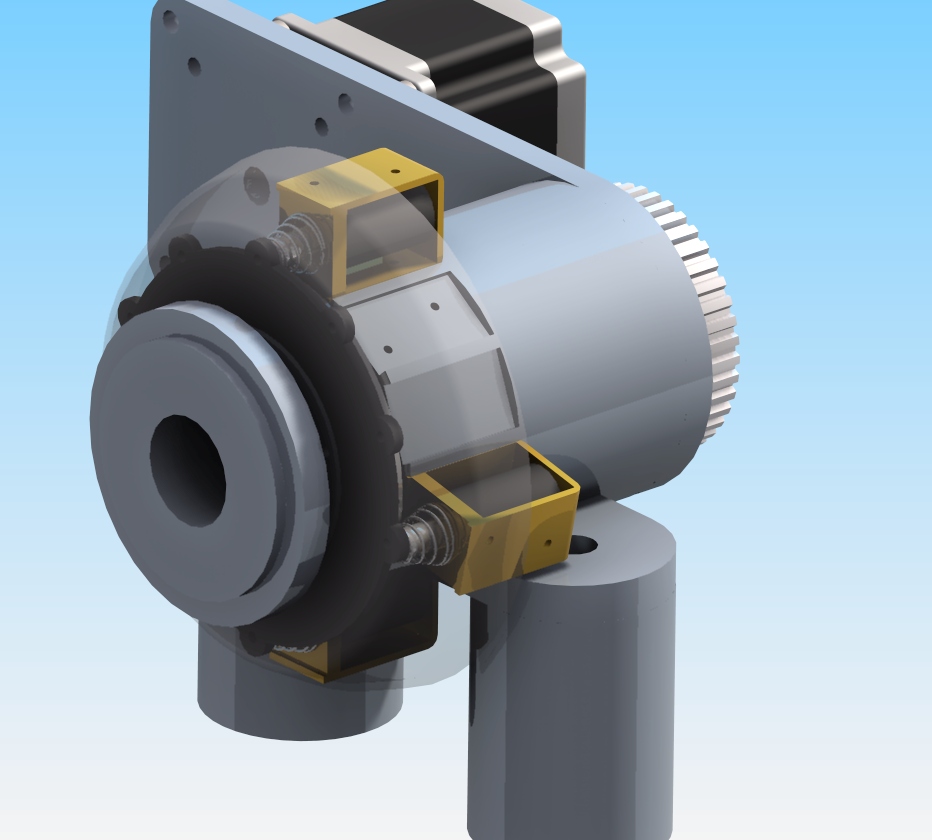

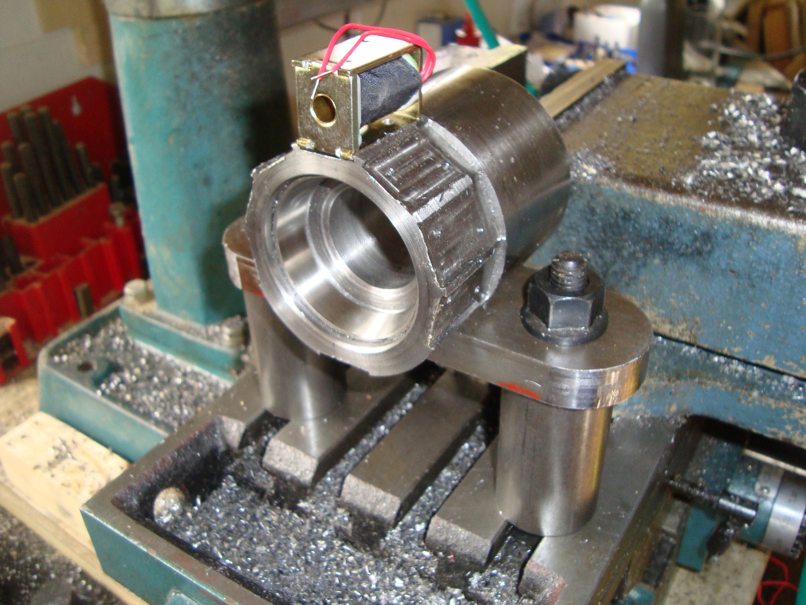

They're a pair of L 68149/L 68110 taper roller bearings. It's all mild steel - shows the dehumidifier is working as it's ages since I machined it. I'll use a stepper motor via timing belt to drive it since there's no way I could afford a servo. Also putting a disk brake using solenoids to hold it steady whilst milling. When I want to use it as a lathe I can put the big brushless motor on it. 6000rpm at several Kw would make a nice CNC lathe. I made it mainly to use with the milling machine, but I may well use it on the router.
I've machined the shaft to fit an 80mm chuck, same as my C3 lathe, but I'll make an adapter to put a 5" chuck on it.
Using 4th axis to make 4th axis (or should that be 5th?):
Attachment 3479
Cross section, note disk break arrangement:
Attachment 3480
Attachment 3481
Mounted on mill:
Attachment 3482

hahha!!! sorry jonathan, you did... on my build thread... it looks so much smaller on your router i thought youd built another oneQuote:
im still pondering the options for my fourth axis, im leaning towards a 50:1 harmonic with a stepper... it'll only be on light duties
youve got me thinking now though.... it would be nice to be able to isolate the gearbox and run it up to lathe speeds
think ill just sit back and see how you get on with yours :)
Could you use a timing belt inside the harmonic gearbox as the flexible gear thingy? Milling the inside out pulley would be fun. Probably do it in two semicircles...
Yep, that's my plan ultimately - to be able to accurately switch between stepper and brushless motor drive.

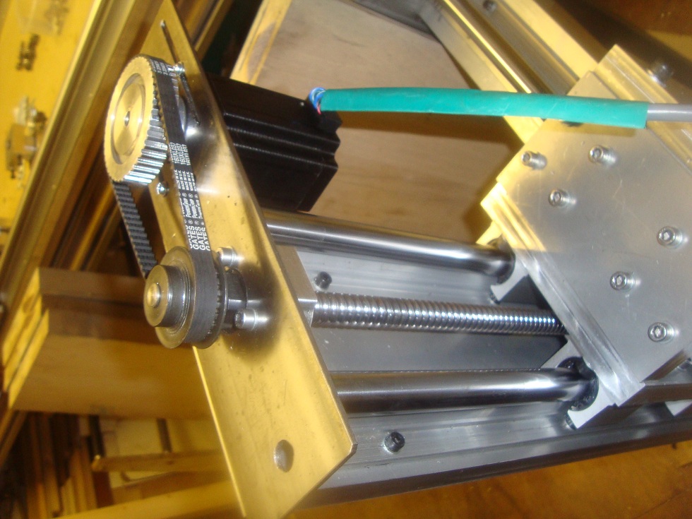

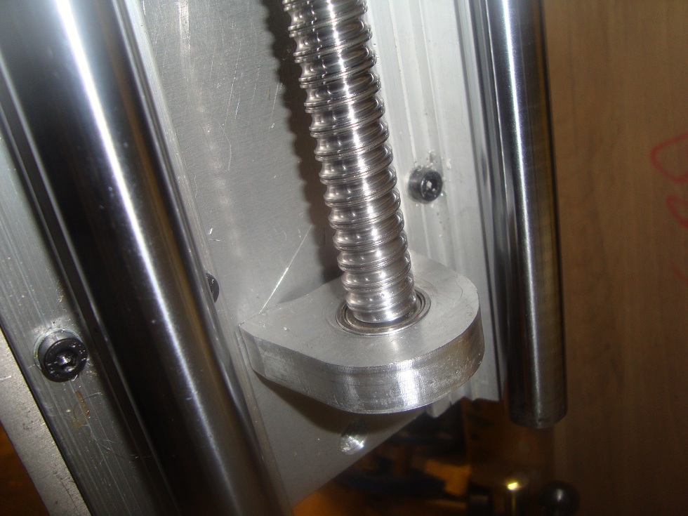

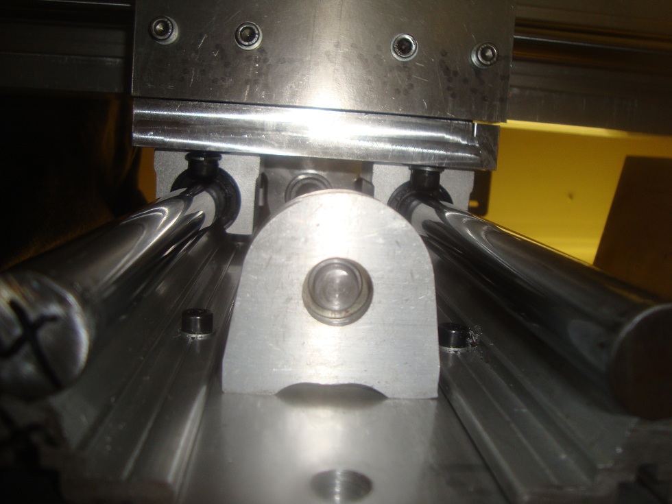

Made good progress on the router today. Milled and drilled aluminium box section and channel to mount X axis linear bearings. Also drilled and milled one side of gantry to fit that, and put slot in for timing belt to go through. Lots of smoke and blue swarf when drilling the steel. It's a 20mm wide slot so I chain drilled @ 16mm (biggest I have) to save time with the 20mm milling cutter. Will probably make more sense when I put photos tomorrow.
Attachment 3484
I'm 14 holes and one slot away from finishing :) Plus a bit of assembly and wiring I suppose.

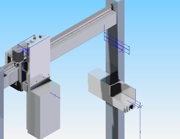

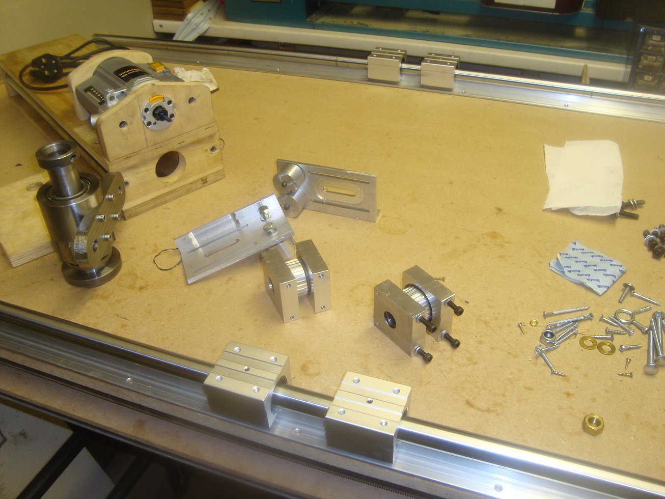

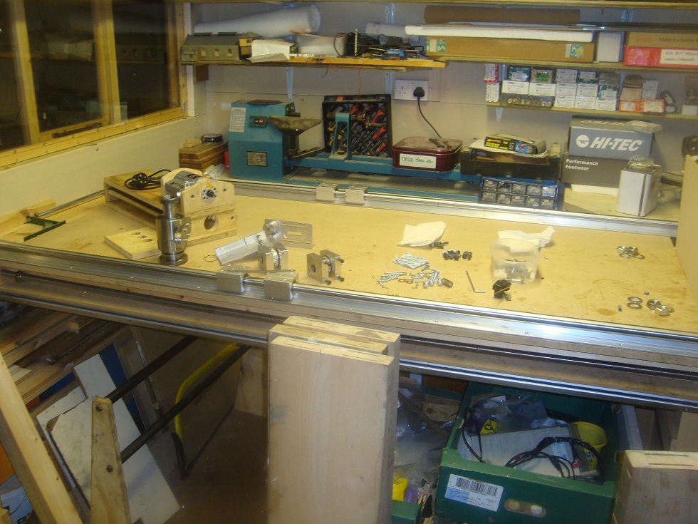

Finished all machining for router this morning! *Just* needs assembling - waiting on my dad to put some bigger legs under it since the previous arrangement was designed for a 10kg gantry, not >50kg!
Been thinking about how I can clamp stuff to the bed to machine it. It would be nice to have T slots like on my milling machine since then I could use the same clamps and easily put the vice/rotary table etc on it. I do have some HSS T slot cutters however I think cutting MDF will destroy them.
My plan is to buy two sheets of 18mm MDF. Glue/screw one down to the bed, get the router to cut the wider part of the T in that and level it, then put another sheet of MDF on top of that and cut the top of the T slot. That way I can use standard router bits...My only worry is if MDF is going to be strong enough?

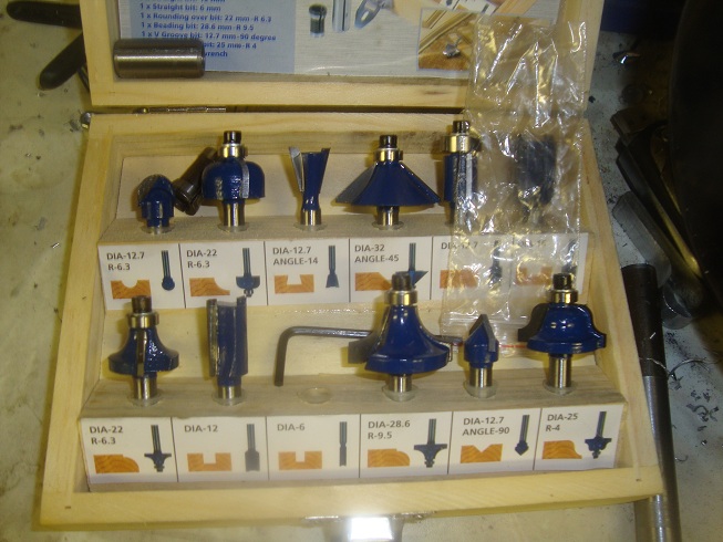

Just been making collets for the cheap router I'm using. I'll post a video here soon...

Can you think of anything better to use that's not too expensive? Maybe plywood, but I guess that's not much better. Vacuum table isn't much good for metals. Bear in mind it needs to be about 800x1900mm ... so clearly I can't afford a nice piece of tooling plate that size!
I'm not sure about the epoxy idea either, wouldn't it just crack/crush?
Making collets for router:
http://www.youtube.com/watch?v=m98fPg-_vUU
