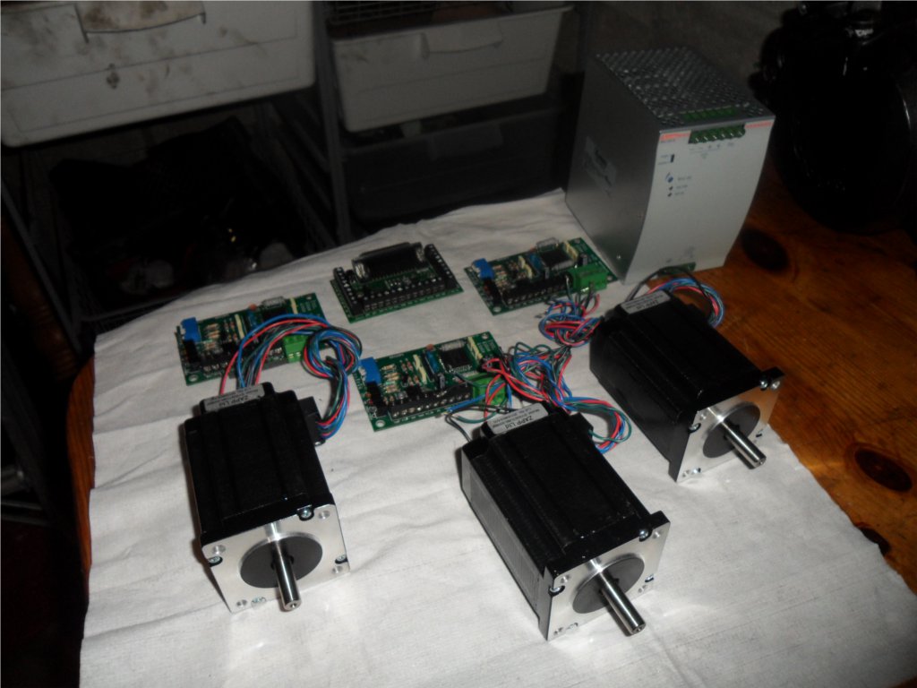

So, Not really an update but finally got my electronics sorted :D
Attachment 4330
and I think I hit my Aim of it being cheap-ish.
all of it for just under £180 quid, still £170 too much though!! :heehee:

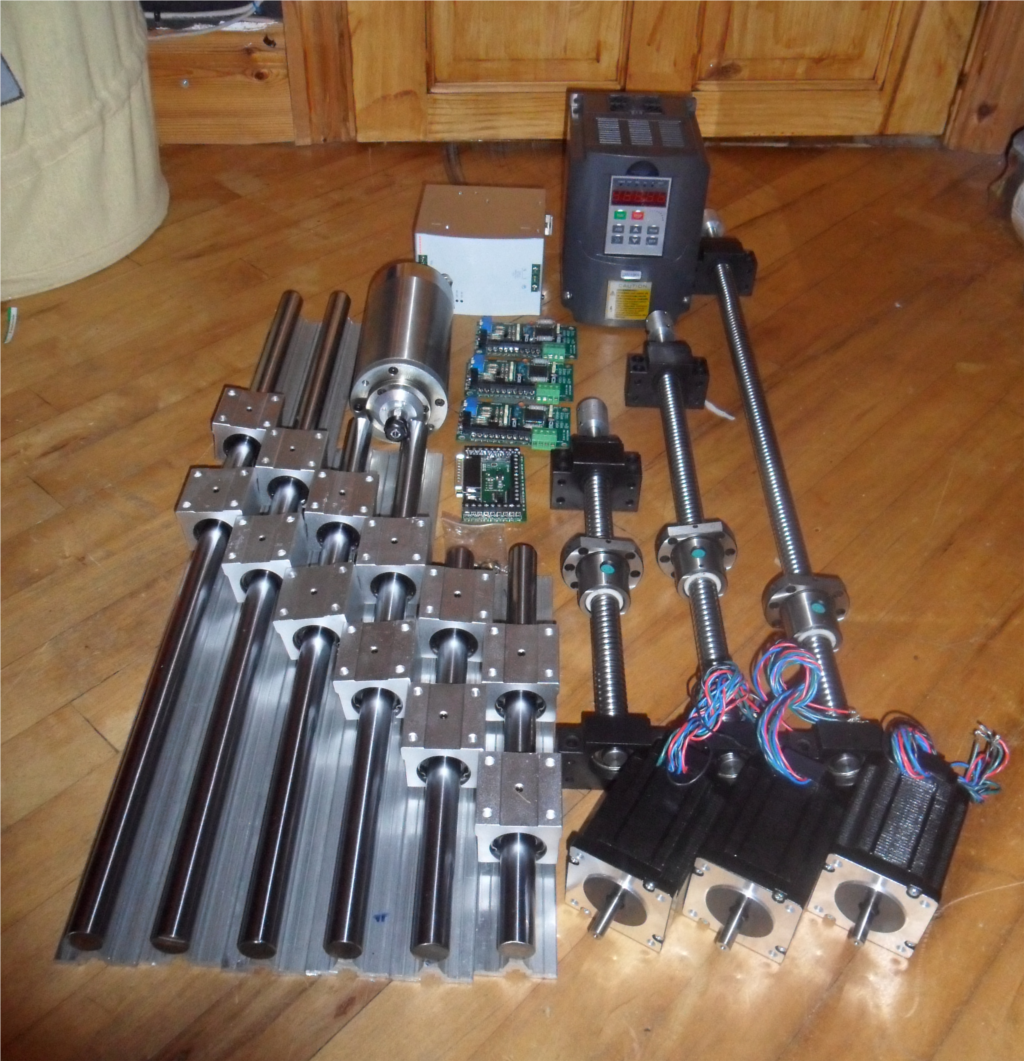

Has finally got all my stuff!
Attachment 4335
Why do i have to go on holiday now!!
I also picked up some 1104 three bond instead of the 1194,
1194 is safer to use as it doesn't use Lead. but i thought, I ride a 2t, I'll live on the edge for a bit :P
Now, all I need is some electrical wire, a Crap load of Aluminium and I'll be done.
I really need some spindle mounts, Nema 23 Mounts and Ball screw mounts though......
jess
only one ball screw on your x-axis??
James
yes, I have a sliding Bed design so I only need one, not only that, but the entire cnc will be more rigid and make things better,
Jess.
A sliding bed does not mean you only need one ballscrew to drive it. When the cutter is at either limit of the Y-axis travel and cutting parallel to the X-axis the cutting force will create a significant torque on the bed causing it to deflect. How much it deflects depends on the spacing of the bearings supporting the bed, the distance between them and of course the cutting force. Two ballscrews completely eliminates this problem. It's like trying to go round a corner fast in a Reliant Robin...it does work but not as well.
