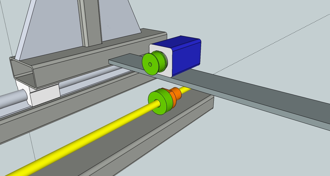

I know if asked to build a machine with 16mm screws of this length I would re-fuse and recommend 20mm with correct size pitch to suit the intend purpose of the machine.
My proposal to use geared 20-05 was work around to no cheaply available 20-10 and wasn't saying they are the ideal solution just an easy one that I know works thru practicle hands on experience.:wink: . . . The right pitch for the job wins every time but theres always other ways to skin a cat.
