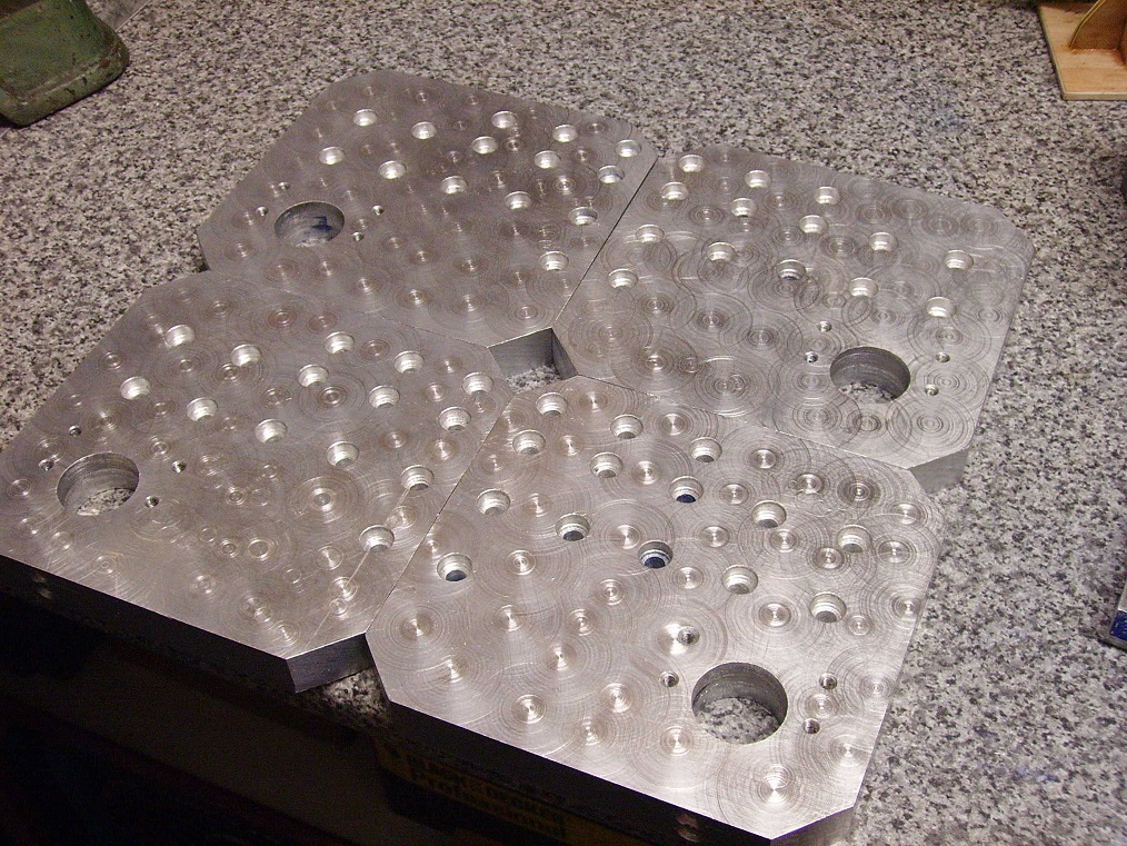

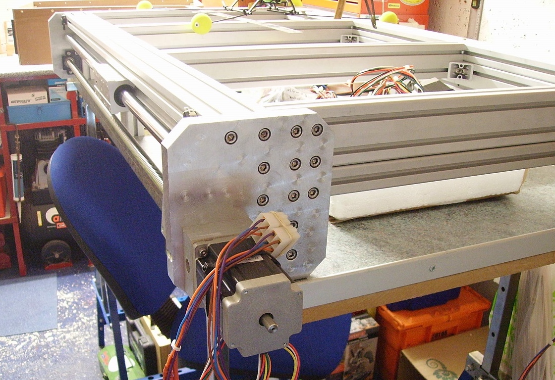

Another picture got finished counter boring the X axiz end plates with a bit of luck I will get them bolted on to the frame today.

The next question That I have is about stepper motors and drivers. What is the advantages to having separate drivers for the stepper motors to having all drivers on one board?
I think I will buy the four separate drivers but wanted to check before sending a order.
Now I will buy nema23 motors but what holding torque should I buy 3.1Nm. or will 2.2Nm work just as well, with the RM1605 ball screws I have. Now I know That it would be better "faster" to drive it with belts and pulleys to change the ratio but at this time it will have to be direct drive. I can change it at a later date if I don't like it.
I will be cutting Balsa and ply 98% of the time but I will require the CNC to cut 3mm aluminium and some hard wood now and again.
I have been reading builds on the forum but it seems that most talk about speed but why? I would be happy as long as it does a good accurate job, if it takes a bit longer to cut I don't mind.
For every material there is an optimal speed (feedrate) at which to cut it and a minimum speed. Optimal is hard to define - it could mean the speed which obtains the best tool life, the highest material removal rate or numerous other factors. The reason we're concerned with maximising the feedrate is if it is too low, you wont be able to cut some materials. Again, weather you can or cannot cut a material with a particular machine is hard to define - for example you could cut aluminium really slowly with a file, but that doesn't really count. For example, since plastics exhibit poor thermal conductivity, they need to be cut with a (relatively) high chipload, to reduce the heat generated by the cutting. Since the spindles we use generally operate best at high speed, this necessitates using a high feedrate to cut plastics otherwise at best the tool life will be poor and at worst it simply wont work. There are ways round this (e.g. using tools with less flutes, use a different lower speed spindl), but in general it's a much better option to choose a drive system which will meet the requirements you expect from these materials.
Even if you don't end up needing the high speed available, the fact the machine is capable of it is advantageous since the machine will be more reliable at lower speeds - e.g you can pretty much guarantee if you've chosen motors/drivers which will move the machine at 10m/min they will never stall or have problems at 5m/min.
In princible there's nothing wrong with having several drivers integrated into one board, so long as they're reliable and suitably rated. The problem is in reality none of them will output enough current/voltage for what you need, so trying to get one to work will not be reliable. Just forget them and please don't post more pictures of TB6560 drivers ;)
You can try Irving's motor calculation spreadsheet (just search that on the forum) to work out which motors would be best. I'd advise using the common 3Nm motors with a 75V power supply. The difference in price between this and other options isn't that great, and it's the best performance you can get without spending a lot more money. I think CNC4You is currently the cheapest place to get the motors and eBay/aliexpress for the drivers.
I have just done a member search on ebay but aliexpress have not been trading in the last 12 month
But I will take your advice and order 3.1Nm stepper and four separate drivers.

Jonathan thanks for the update in finding that site, I have now placed a order for drivers and have also bought the 3.1Nm stepper motors that you advised, That was a good saving in cost. Thanks.

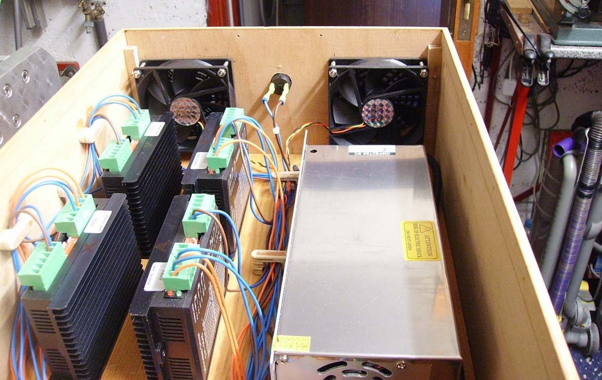

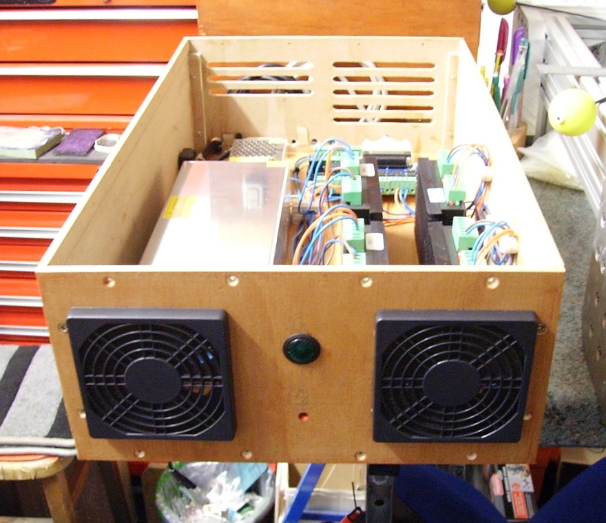

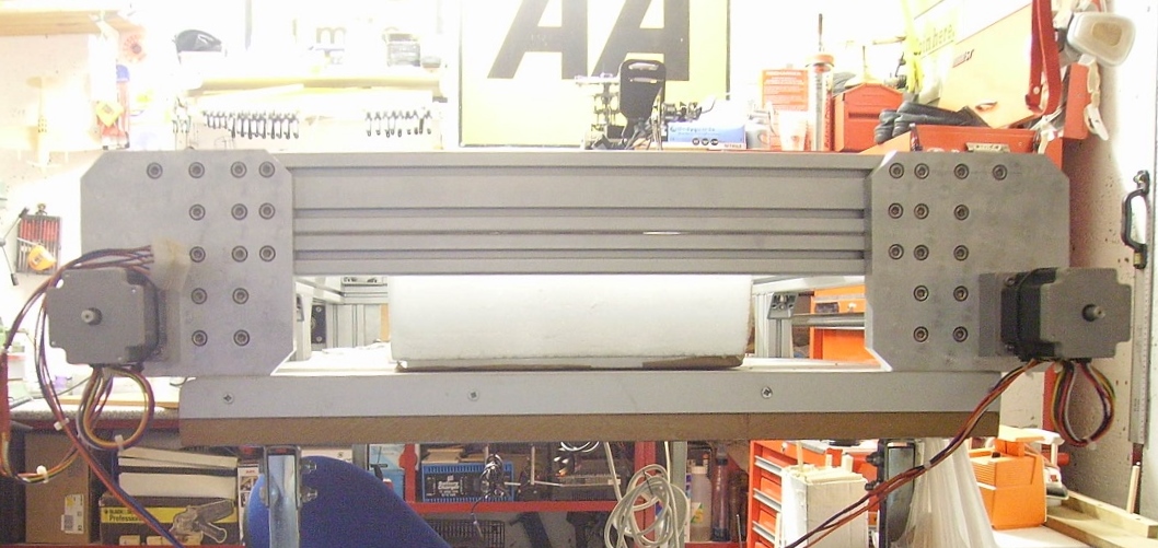

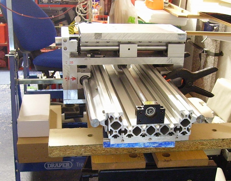

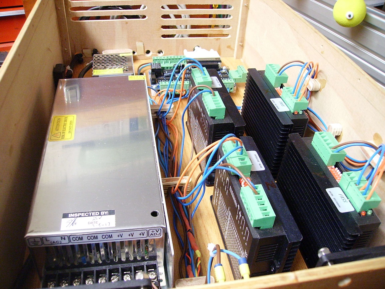

Been a while since I did any work to my CNC router as I was in Hospital again for a few days and the wife has band me from the garage. But I did get some wiring done, but have a lot more to do, I'm waiting on a E stop switch and more wire.
So just some photo's where I stand at this time. I hope to get going again in the next couple of weeks.
Attachment 9237Attachment 9239Attachment 9240Attachment 9241Attachment 9242Attachment 9243
