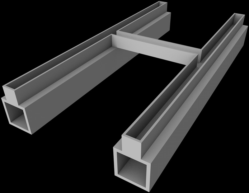

you dont need to be to exreem about the wields, as long as its sort of level on the top, and measures square ( you will see any twists when cutting the steel into parts, its easy to avoid any visible distortions, just use the best bits for the top ). I did the same as your suggesting though, i got a firm to do the welding, after i had cut and marked the pieces.
Epoxy does most of the rest,

I can't really recommend an epoxy as I haven't used this particular technique, but as I understand it does need certain properties for it to work..
Firstly, to be clear - I'm not talking about the method used on this build:
My First Router, Built in Steel - Page 17
The method I'm referring to is the one where once the frame is assembled/welded, a couple of channels are built onto the rail bearing surfaces (the channels don't need a bottom as the surface of the frame will serve that purpose) these channels are joined by a bridge (probably more than one, which will - of course - need a bottom). Once the frame is reasonably level and the epoxy is poured in, the bridge(s) ensure that the epoxy on both sides of the frame sets at the same height. Once everything's hard, take away the channels/bridges, scrape away the meniscus and voila - parallel, same height rail mounting surfaces.
Attachment 12529
A few folk on here have used this method and will be able to elucidate further.
Wal.

Cool guys, How deep are those channels? Epoxy can be very expensive...and sueply you'd only need a couple mm max!
They don't need to be as deep as I've illustrated 'em - I think 2mm would be under-doing it a bit - mix too little (or if the frame's level is slightly off) and you're maybe gonna end up with bald-spots... I'd calculate for a 5mm thickness of epoxy and don't forget to make the channel wide enough so that the resulting strip of epoxy supports the full width of the rail.
That's about the extent of my knowledge regarding this technique - someone will be along soon to better advise!
