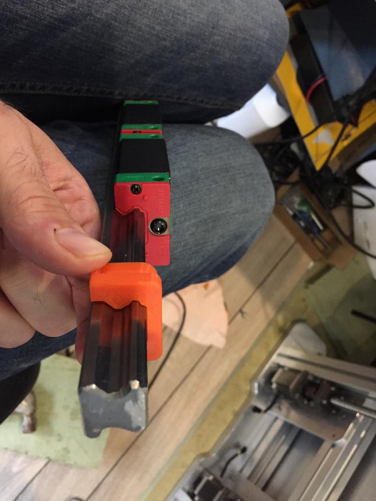

 So had a chance to make my rail alignment doohickeys:
 http://i.imgur.com/1n65YYA.jpg
 http://i.imgur.com/aMjuOP5.jpg
 http://i.imgur.com/4qO62TL.jpg
 http://i.imgur.com/kwu3PZM.jpg
 My plan to cut them so that the critical height is on the same part of the ballscrew seems to have worked well:
 13.499mm
 http://i.imgur.com/BaTkHVp.jpg
 13.500mm
 http://i.imgur.com/QPTPRDa.jpg
 Biggest variation i found was 13.497 to 13.503, so max variation of 0.006mm (0.00024 inches if you are that way inclined), so pretty happy with that.
 I 3d printed a jig and made some drill bushings on the lathe, looks like a shocked robot:
 http://i.imgur.com/tjaaNk3.jpg
 After drilling, tapping and a quick de-burring I gave the 20mm bed plate a good clean and laid the machine down on it upside down. Wiped each piece and area with an alcohol wipe to try and minimise any dust or dirt before fastening the rail spacers into position against the bed plate as a reference.
 http://i.imgur.com/7zRe8mL.jpg
 http://i.imgur.com/90aqn9D.jpg
 Then finally gave the rails a good wipe with a vanguard anti-corrosion wipe (hopefully minimise any naughtiness between the steel rail and milled aluminium mounting surface) before mounting them against the rail guides.
 http://i.imgur.com/lhoav8o.jpg
 Next up will be re-making the front plate after my motor mount height snafu, then I can crack on and get this lower frame finished off before moving on to the Z-axis next.

 Thought I'd experiment a little with the seals for the Z-axis. I have some red material on order so we can stick with the colour scheme but for now to dial it in I'm just using what I've got which is a nice orange!
 So this is the part, I've designed it now so that it has a locking flange to prevent it from going walkies... it should just push into the top/bottom plates and wedge in place.
 https://i.imgur.com/E6uc8yg.png
 https://i.imgur.com/mbvXvTC.png
 So off to the printer to try it out... I'm using a material called Cheetah by ninjaflex. It's a fairly firm but flexible rubbery material (shore hardness 95A) which is abrasion resistant, resistant to chemicals and pretty tough.
 https://i.imgur.com/cOEYhje.jpg
 https://i.imgur.com/MJLvY7X.jpg
 https://i.imgur.com/Pbqde1t.jpg
 Here you can see the flexible rubbery nature:
 https://i.imgur.com/YlollN5.jpg
 Fit is excellent, but maybe just a smidge tight. I need to check it with the part actually held in the plates, but it may just need a very slightly enlargement of the interior cut out.
 https://i.imgur.com/0lg9mTv.jpg

		1 Attachment(s) Re: El Beast - Initial design phase, comments and critique welcomed!
		Charlie:
 How about this - the last photo showing the 3D printed part on the rail:
 Attachment 22836
 Zeeflyboy:
 Great timing - I've been thinking about how to seal the rails on my Z axis.  I've planned ahead and have tapped holes in the base of the Y axis to accept a plate with some sort of brush/seal, and I was playing with ideas for the actual seal.  I was thinking about cutting them out of a small piece of plastic with the router, and inserting them into the plate, as you have done.
 But 3D printing is a much better idea as you can get tight into the corners, cheers for that.  Also by chance bumped into a colleague today with a 3D printer and he is now lined up ready to make me some parts.  I just need a slot this week to get back onto the CAD and draft something up as a trial.
 I think as you say it is a matter of fine tuning something to keep the worst out but not rub too much.

		Really odd - I've been using imgur for all the photos so nothing has changed... I really can't think why it only affects you, and only for recent pics... how odd.
 RouterCNC - I just printed one out which I enlarged the cut out by 0.15mm on and I think it's perfect. Given you are using 20mm rail too you are welcome to have my model to modify as needed to make the exterior fit your machine? You use fusion right?
 If you need them printed out I can print them out and pop em in the post for you too if that helps. Flexibles can be a tricky thing to get right, some printers cope better than others (bowden types really don't tend to do great for example) and stuff like cheetah is pretty expensive to buy if he doesn't already have something comparable.
