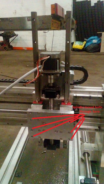

Z axis, I need some bolts to finish it off they were ordered yesterday will come tomorrow. I could have used normal bolts but since everything is A2 socket caps I thought I might as well stick with them and buy more. I haven't cut the Hiwin's down so I can remake the Z axis to get more travel
Attachment 22731
Attachment 22732
Finally worked out how to fit energy chain, no way going to fit my water lines in the chain but at least the wiring will be ok, glad I bought chunkier chain for the Y axis as it will have another cable in it.

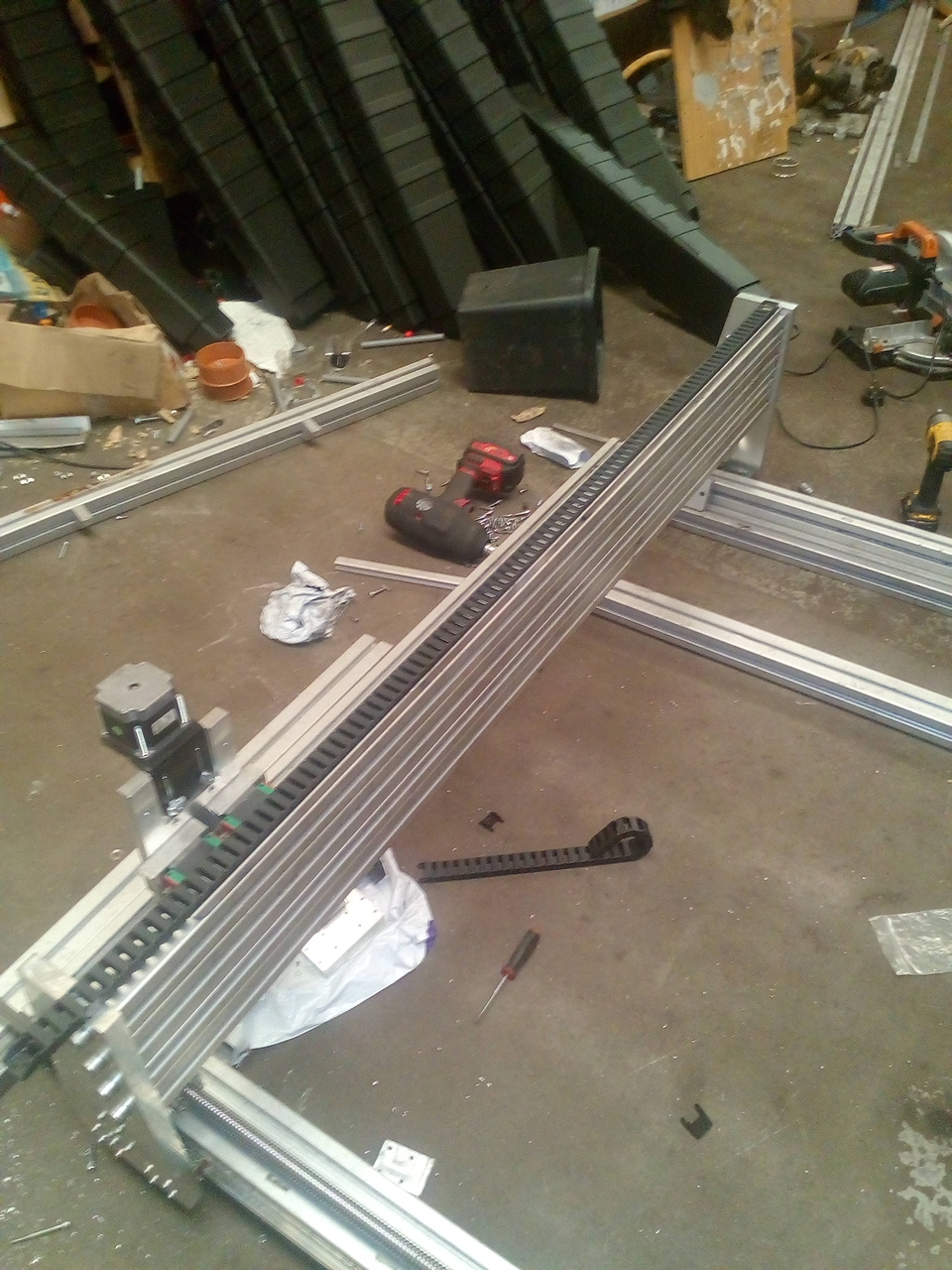

2 Attachment(s)
Re: New build with recycled parts on a ridiculous budget 120cm*60cm work area
Attachment 22773
Attachment 22774
She moves! At least the gantry and Z axis not tried Y axis because of the dual ballscrew, will wait for the AM882's.
