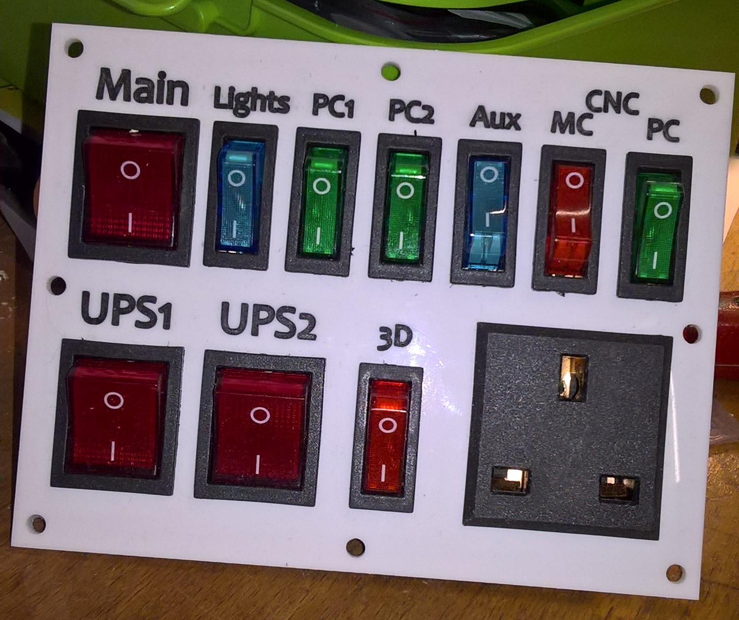

I don't need a relay, without power my controller box gives an estop signal anyway.
Here is a pic of the control panel for my office :-
Attachment 24892
Re: Help please. Dip switches and mach 3 settings
That is a beautiful panel, although I don.t understand most of it.

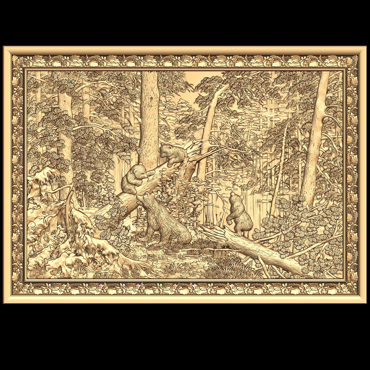

I bought a pack of stl files from ebay, and they seem great for most decorative jobs, except frames. There are lots of projects which have the frames included in the whole relief, and even if I.m not a fan of it, it looks fine in the end, BUT I also got a few frame designs on their own, and they do not have any joints. I guess it.s fine for mdf, but for solid wood, I wood very much prefer to cut 4 different parts from one piece of wood, alligned one next to another and also cut the 45 angles for each segment.
Reading a bit about this issue online, I found Autodesh Meshmixer (free) and gave it a try. Does not seem very hard to learn, but still need to study a bit.
But as everything with this project, asking here seems to save A LOT!!! of time. So the question is: What software do you use for editing (modifying) STL files?
For example I attached 2 files, with a separate frame and a relief with a frame included. I would like to remove the included frame first, and then cut the separate frame in 4 mitered parts so i can join and attach later. Also because I want it from another type of wood. How would you do it?
Attachment 24993
Attachment 24994

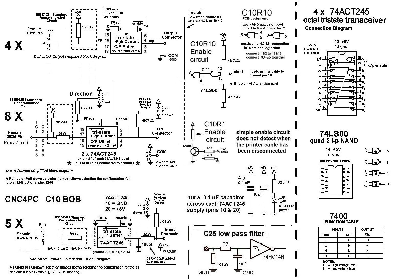

Hi again.
Shortly after the the 3 weeks old conversation, I received 3 inductive switches, which I.ll install next week.
I like Rob.s approach of also keeping some mechanical switches in place next to the homing ones, but I.m somewhat unsure what.s the best way to wire all this.
I.ve only got 5 pins on the Bob, one being used for the probe. So 4 pins for the remaining Estop, 6 mechanical limit switches (2 for each axis), 3 inductive homing switches (3wires).
So for example (let.s say P15 is the probe)
1. Combine all limits and estop in let.s say P10 and have P11,12,13 for x,y,z home switches.
2. Combine all limits in P10 and all homes in P11, Estop in either P12 or 13
3. Combine the limits and home of each axis in one pin
So what the best wiring option and why?
First , what inductive switches have you got? Keep Estop separate! All your limit switches can go in series to one pin using Com and NC on the switch, then you can put a push-to-make switch across the lot so you can jog off your limits when you hit them (otherwise you have to toggle and jog, then toggle again) . All your homes can go to one pin using diode routing if needed.
So I have just described option 2.
Homing works by moving an axis to trigger the home switch and then backing off to where the switch is not triggered, so it it quite OK to use the same i/o pin.
