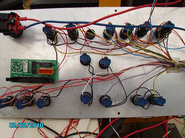

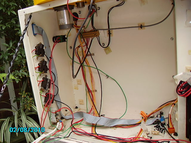

Rick, i thought of you today as i removed a front panel from a boxford 240 lathe, all those lovely switches never to be used again......:wink::tongue:lol

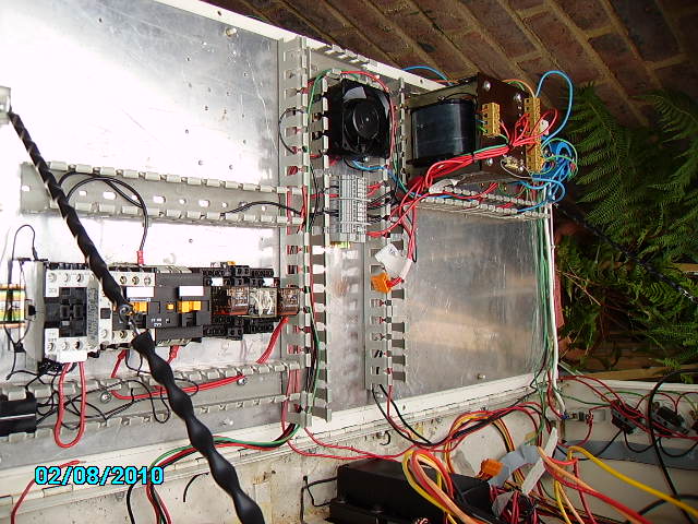

On a more serious note i2i, do you know what sort of temperature are these SD3 drivers heatsinks supposed to sit at when not doing anything??
they do run fairly hot, you should be able to touch the heatsink. If you're worried you could put a fan in there, some boxfords have a fan as standard.
Just think you could have a temperature controlled fan with a tacho and an led that gets brighter the faster the fan goes, and a digital thermometer for each drive. It'll be like christmas at Blackpool.
PS. i prefer the e-stop at the top.:smile:

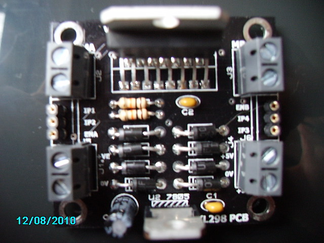

Its funny you should say that, here is a little gadget i got to controll the speed of my dc fans related to ambient enclosure temperature... based on the input from some carefully placed sensors. :smile:
Attachment 2619
I put the E-Stop at the bottom so you could use your hip to activate if your hands were out of action. lol:rofl:
