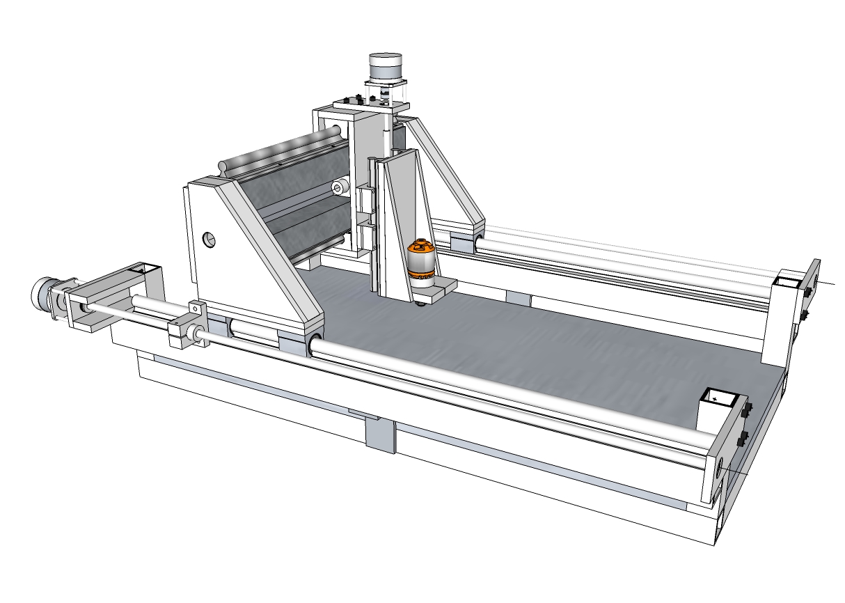

Now playing devils advocate here....how much accuracy do I need? There's a CNC router I know of that looks a bit like this.....
Attachment 11387
which has supported round rails bolted straight to what looks like steel rectangular section and that machine seems to put out some nice accurate shiny aluminium bits :wink: :wink: :wink: :wink: :wink: I'm mostly going to be cutting balsa, ply, carbon fibre, wood engraving and the odd piece out of aluminium (probably upgrades for the machine itself if most build threads are to be believed...!) so just wondering to what degree I go to with the levelling? I've got nothing to measure the accuracy of the epoxy once it's set and have no way of accurately telling if the rails are flat. I don't want to go out and spend a small fortune on a surface plate or engineers bevelled edge 1300mm long sop suggestions on a postcard please?
Excellent point and your 100% spot on.!!. . . . He's talking Bollocks.!! . . . . Measuring to those tolerences needs expensive highly calibrated equipment which I doubt he has either.!
For what you want to do then if those rails are on the same plane then you will be perfectly fine.!! . . . . Fact is this is DIY Level precision and to attain higher level precision cost's lots of Money or Lots of time and frustration.!!. . . . . .KEEP IT REAL. . . it will be PERFECTly fine for wood.!

My cunning plan is to get some of my 10mm 6082 plate I have and make a plate to go across the X axis and bolt it to the carriages like so....then put some 100x50 section on it to stiffen it....
Attachment 11390
Then I can drill one hole one end of a rail and then using digital callipers (accurate enough???!!!) get the hole at the other end the same distance from the rail side, move the carriage to one end and drill a hole on the opposite rail at that end, slide the carriage up to the other end and mark the hole and drill that. Then by sliding the carriage up and down and nipping the bolts up I should be able to get them parallel to each other. I can then move the carriage near the middle and mark, drill and tap those holes. Once I've a sufficient number of holes drilled and tapped (every other hole?) I should be able to see if it slides freely or if it binds? If it slides freely......happy days, if not then epoxy it is! Sound like a (convoluted) plan?
P.S. I know the bolts should be allen head socket bolts and counter sunk but I couldn't be bothered to draw any.....sorry!

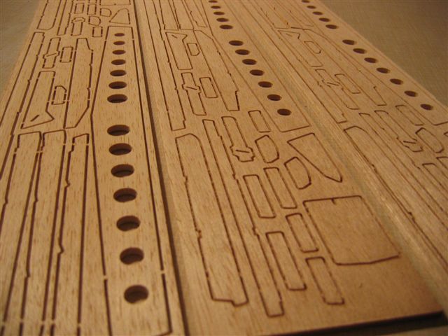

I also design and make RC planes - so balsa, liteply, and ply are the usual materials being cut. Will be watching your build with interest.
