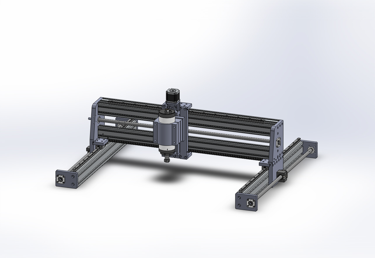

Have you thought about just using one belt and one motor and drive, I use two motors but quite a few on here use one as it is easier to home and stops the problem of racking etc. Just a thought!
Printable View
There are pro's and con's for the two systems I don't think there is much difference in cost between the two.
With two motors you will need two homing switches and a controller that can do the slaving correctly and also have the alarm outputs on the drives working in case one motor stalls and then the other will rack the system.
Dean (Jazzcnc) usually uses one motor but I think on the machine he is now using it has two.
I use two motors and I am happy with it.
Yes it has but only because I inerited the machine it probably wouldn't if I built it my self.! . . . Thou It's just on the edge of too big for belts so maybe not.?
On large machines 2 motors make more sense because the belts get messy and custom lengths. At this size and with this design then I'd 100% be using belts.
It's only slightly cheaper in cost but much more reliable and stable in use. Can make full use of the machines potential and not worry about screws running out of sync with each other.
If using 2 motors then the ONLY way I'll use them is if the drives have Stall detect with fault output to E-stop the machine ie: EM806 or AM882 . Also external motion control card is prefered due to higher work load. (Personaly I won't use the Parallel port on any machine)
Hmm maybe I will stick with one motor and use a single large belt. I don't think it will require much modification (whilst still having the potential to run 2 motors in the future). Just need to make sure I can tension the belt well. I'm thinking of a simple idler pulley which I can slide in a slot.

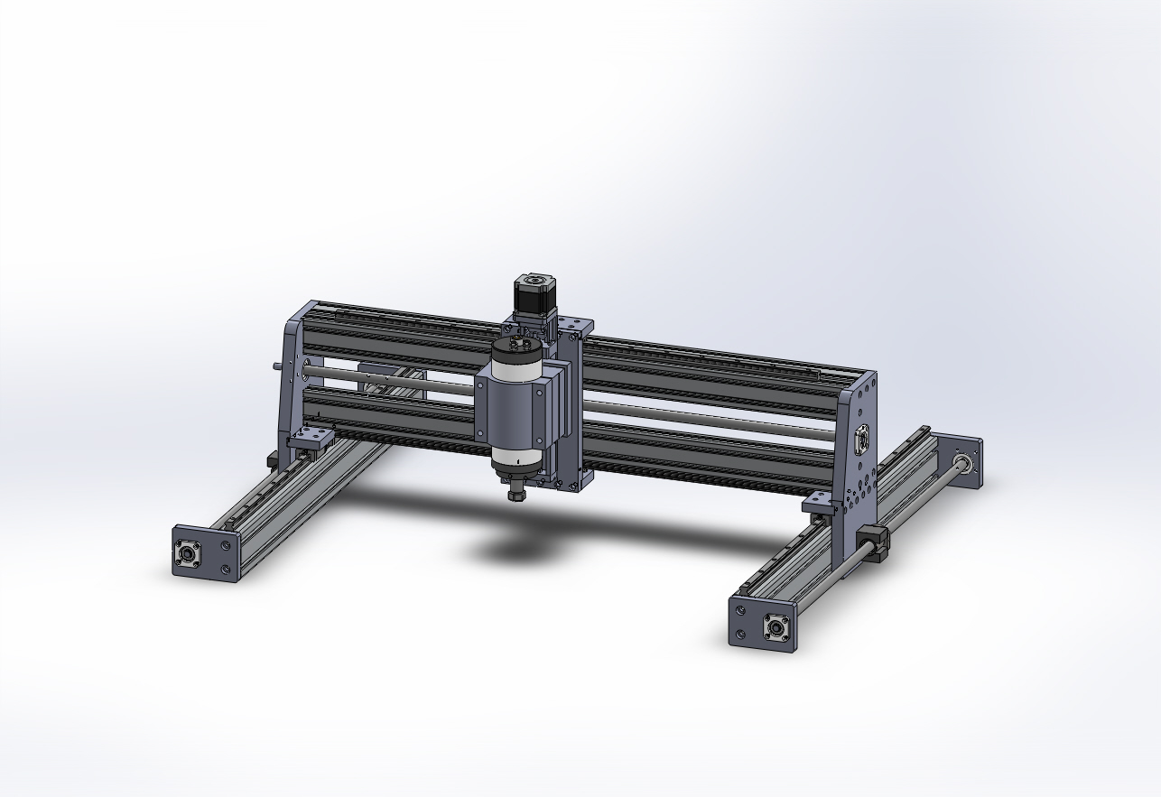

Something like below? The bottom idler pulleys on both sides sit in slots for adjusting tension.
Attachment 16952Attachment 16953
You don't need to spend money on pulleys just to use them as tensioners.
What ability have you got for machining the aluminium? If only basic tools like me then you could probably lose some of the pockets. Would help with adjustment later too ?
Too many idlers drop try to keep to a minimum you'll get away with just one. Belt will be above the profile but doesn't matter because you'll want to cover it up anyway.
Attachment 16969
I only went for more idlers to keep the belt beneath the extrusion...maybe I'll have a re-think.

Word of warning before commiting fully to this route.? Make sure you can buy a long enough belt of the shelf other wise it means having custom length belts made. Not a Big issue but still worth thinking about now.
The available belt lengths may also mean changing the location of the tensioners so work out the belt length needed for how you have it drawn now and see if belts are available that will work.

Jazz, is there enough engagement on the top right pulley? What's the minimum? you could add one more like this?? I Attachment 17005
The spec. for HTD belts say make sure to have 5 teeth engaged. This is based on ensuring that with a sufficiently high load, the belt will snap instead of the teeth ripping off. This hardly matters to us, as we're not using the belts at close to their load ratings, however we do want to get good stiffness from the belts (especially with such a long best) so it seems a reasonable baseline to design for at least 5 teeth engaged.
Thanks for the info. With a 20T pulley I should have around 5 teeth engaged with what looks like a quarter of the pulley.

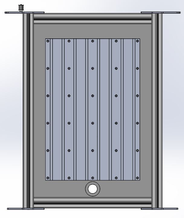

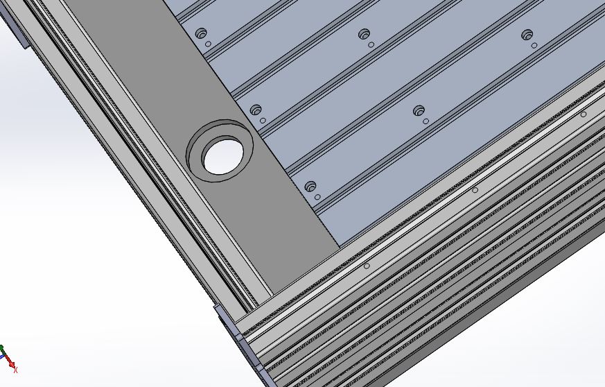

On a side note, I am currently looking at my bed plate design. I have put in a recessed hole to insert a standard kitchen sink waste hole. Is this OK or is there a preferred method? Also wondering if to move it to the corner and tilt the machine towards it...

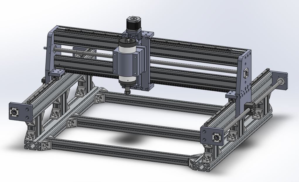

I am starting to get a little worried that my machine is going to be incredibly heavy. The parts for the Z-axis assembly alone weigh a ton! (Not literally, I am going to weigh them later). I just hope my 3Nm steppers are up to the job...yes, I know I should of done the calculations beforehand but I got carried away with buying shiny things!

I thought things were going too well... I don't know how I've missed this but the 45 series rexroth extrusion has 10mm diameter holes for M12 screws on the ends. For some unknown reason I've designed my aluminium gantry sides for M6!!! I've seen you can get an M8 "cutting bush" which reduces the bore. Would my best option be to use these and get the side plates drilled out to M8?
What plate thickness have you got?
