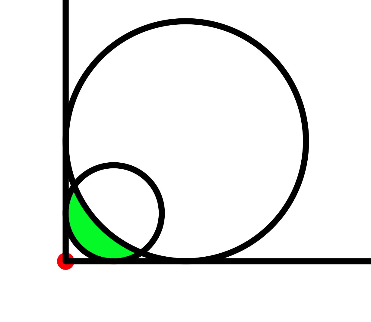

As some may have read, I am converting my Bridgeport mill to CNC, the idea is to attache the high speed spindle to it to make a dual purpose machine.
Seems I have a couple of options here - mount the spindle motor to the main mill quill or make a new Z axis complete and mount that to the head of the Bridgeport.
Mounting the spindle to the quill is easiest - a simple clamp block would do it...
Attachment 18475
The larger circle is the mill quill or Z axis (around 100mm dia), smaller is the 24k spindle (80mm dia), looking down from above. The distance between the two is 50mm and the clamp could be machined from 30-40mm thick aluminium or similar.
Would it work though??
Your thoughts...
Second option is far more involved and needs a mounting bracket and complete Z axis making to take the 24k spindle, this assembly would mount on the rear of the swivel ram (at the back in this picture)...
Attachment 18476
Would be harder to make but still do-able but if the first idea worked the much time and cash will be saved ;)
Thoughts??
Why do you want 24k on the mill surely you would be better having some lower end torque and going for maybe 6-10k, 6k bottom end seems to high for a mill, I may be completely wrong as a complete noob but I would have thought you are losing more than your gaining with a 24k with bottom end around 6k.
I'd come of the quill to save grief. Chances are you'll only use small tooling anyway so no great stress.
It's all about flexibility - the mill itself has 2Hp and 50-3000rpm range - no good for small cutters or engraving, great for hogging the crap out of steel etc with large tooling. The spindle has the speed for small cutters and engraving but no good for big tooling or steel work. The Base machine is simply a very heavy X/Y table - 300mm in Y and 1000mm in X - way bigger than my mini-mill.
That's my view too, I have 125mm of Z axis movement and losing 30-40mm for the clamp won't hurt as there is also a manual 300mm of table up/down - no engraving spindle is going to be diving more than 80mm into the work so travel seems adequate even allowing for clearance plane above clamps etc.
This is also the easy option to test out - only wastes a block of aluminium if it fails, my point of weakness would likely be vibration causing chatter marks, but time will tell here.
If its about flexibility then why not keep the grunt and mount a spindle to one side might have to extend arm on right past the 24k spindle but looking at it should be possible, the you would probably still have 800x300 travel on the 24k and the ability to hog the crap out of steel when needed. I would be a fantastic base for a router for engraving and using small endmills but severely limited in the type of work it was designed to do
That is exactly my plan, should have explained better ;)
The 24k spindle is not going be full-time mounted, its an option and will be pulled off when not needed.
Due to the way the head swivels on the BP I can probably maintain near full X travel if needed just by moving the ram to the left when the spindle is in use, its a very flexible machine - that's why i like it so much.
