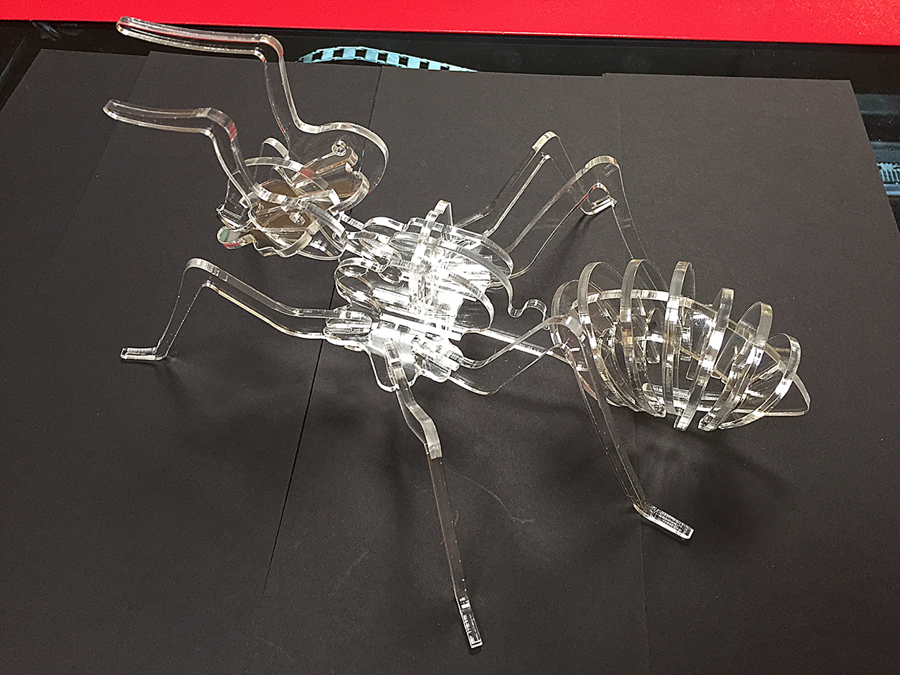

Sorted out a few issues :)
Cutting ok now, just waiting for my power meter to see just how little there really is.
Test job :)
Attachment 21221

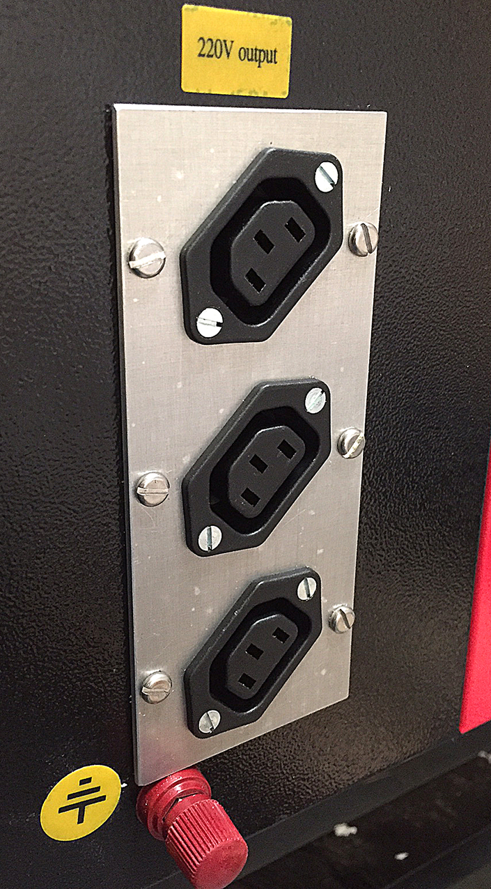

I need to modify the head mirror mount as the tension screws are binding in their holes so the angle adjusters do not work properly, the tube mounts need slotting.
Tomorrow i'll be replacing the death-trap 'universal' sockets on the back with IEC ones - milled out a nice aluminium plate tonight to mount them in the original holes ;)
Hopefully my power meter will arrive soon and i can prepare to be disappointed with just how little power this tube is pushing ;)
Re: Ready to push the button and buy a laser....
Nice neat socket plate with decent sockets....
Attachment 21245
Also fitted a relay to the top socket so i can turn the extract on and off from the front panel :)
